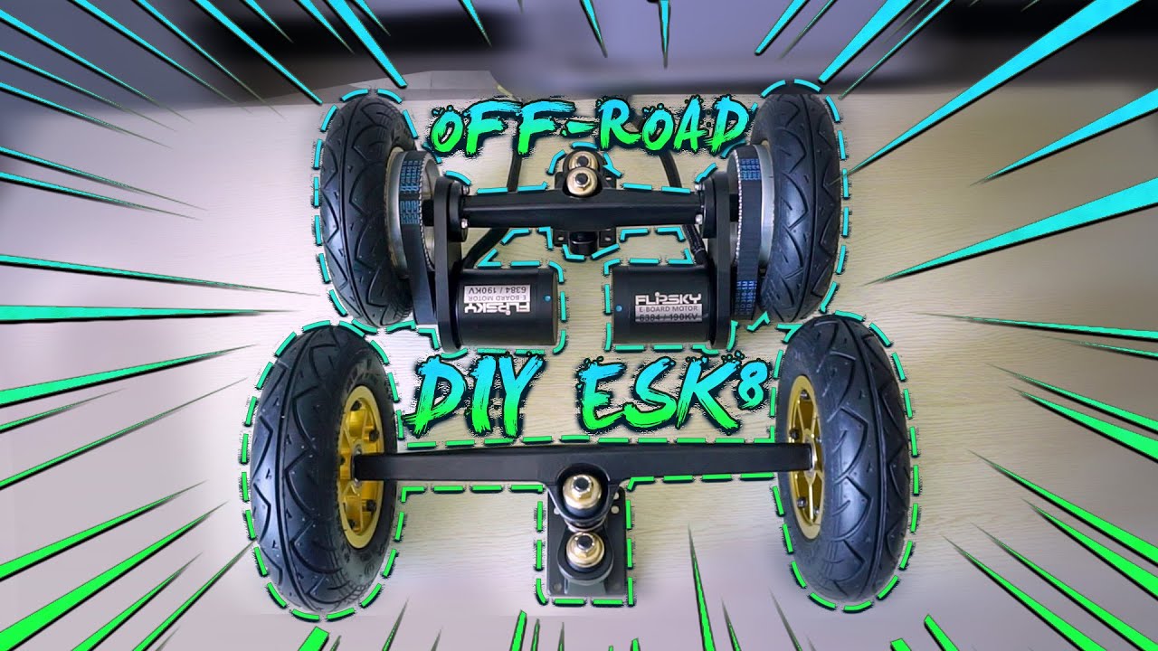

Looks like Flipsky made Rockstar Pro hub clones.
https://flipsky.net/collections/stepper-motor/products/7-48-atm-190x50mm-offroad-wheel-pneumatic-rubber-all-terrain-mountain-wheels-kit-with-two-belt-for-diy-skateboard-scooter
Curiously, “Axle diameter” is simultaneously 10mm and 1/2" at the same time.
Definitely have some quality engineering talent behind this product, if they don’t even know what the intended axle diameter is. Last I checked, 1/2" and 10mm are not similar.
It’s chinese retailer tradition to list conflicting information on their products.
