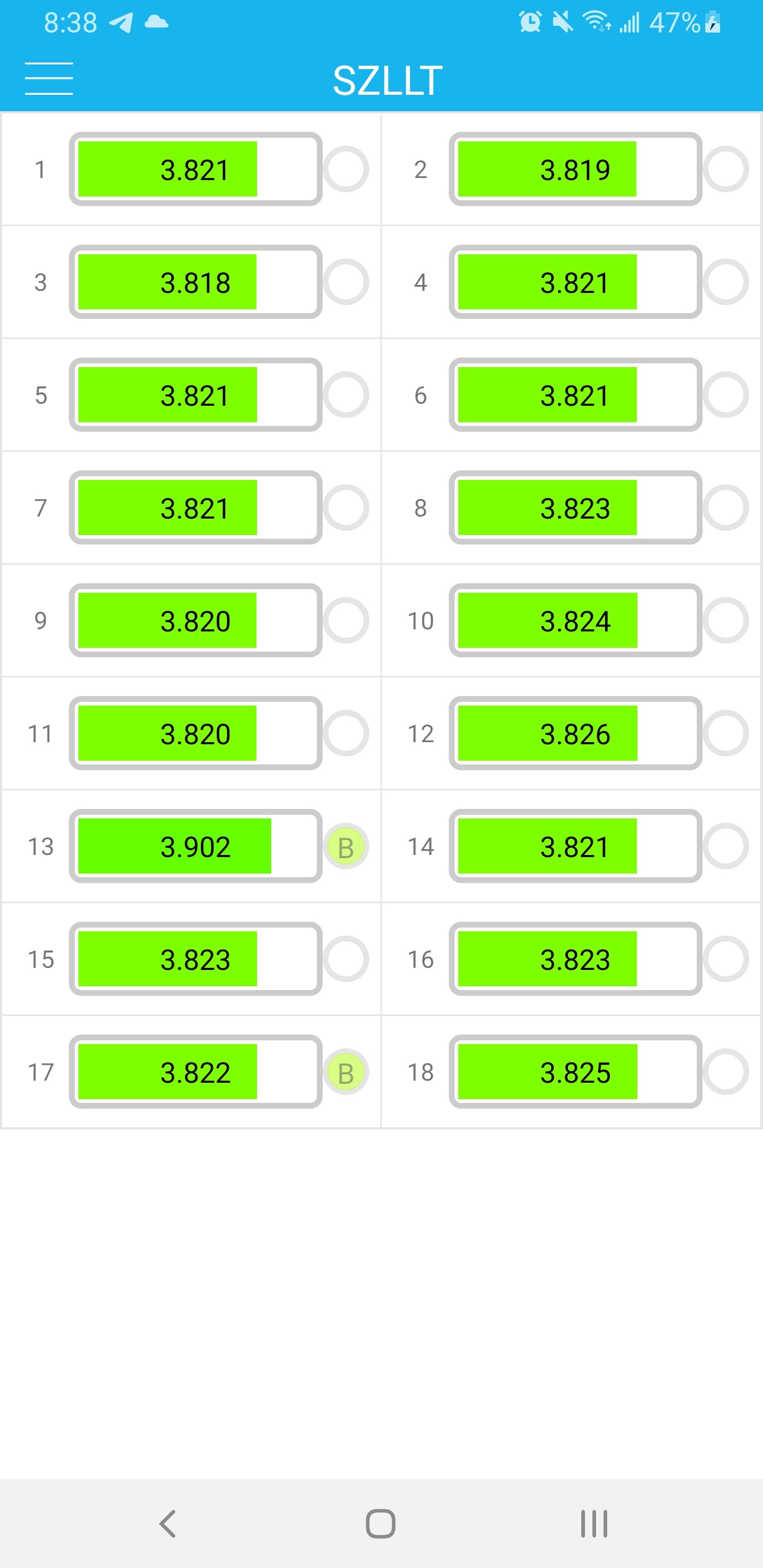

This battery is making me realized that with 30% more series groups there is that many more connections and things to go wrong.
Case and point. Something is up with group 13. Its charging faster then the rest, so either a bad weld or a bad cell in the group, not sure but something is up, will probbaly have to replace the whole group. This is why I always use a smart bms, I would have never caught this otherwise, atleast not this fast.
What bms you using? Been meaning to get one myself
Looks like LLT

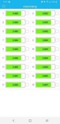

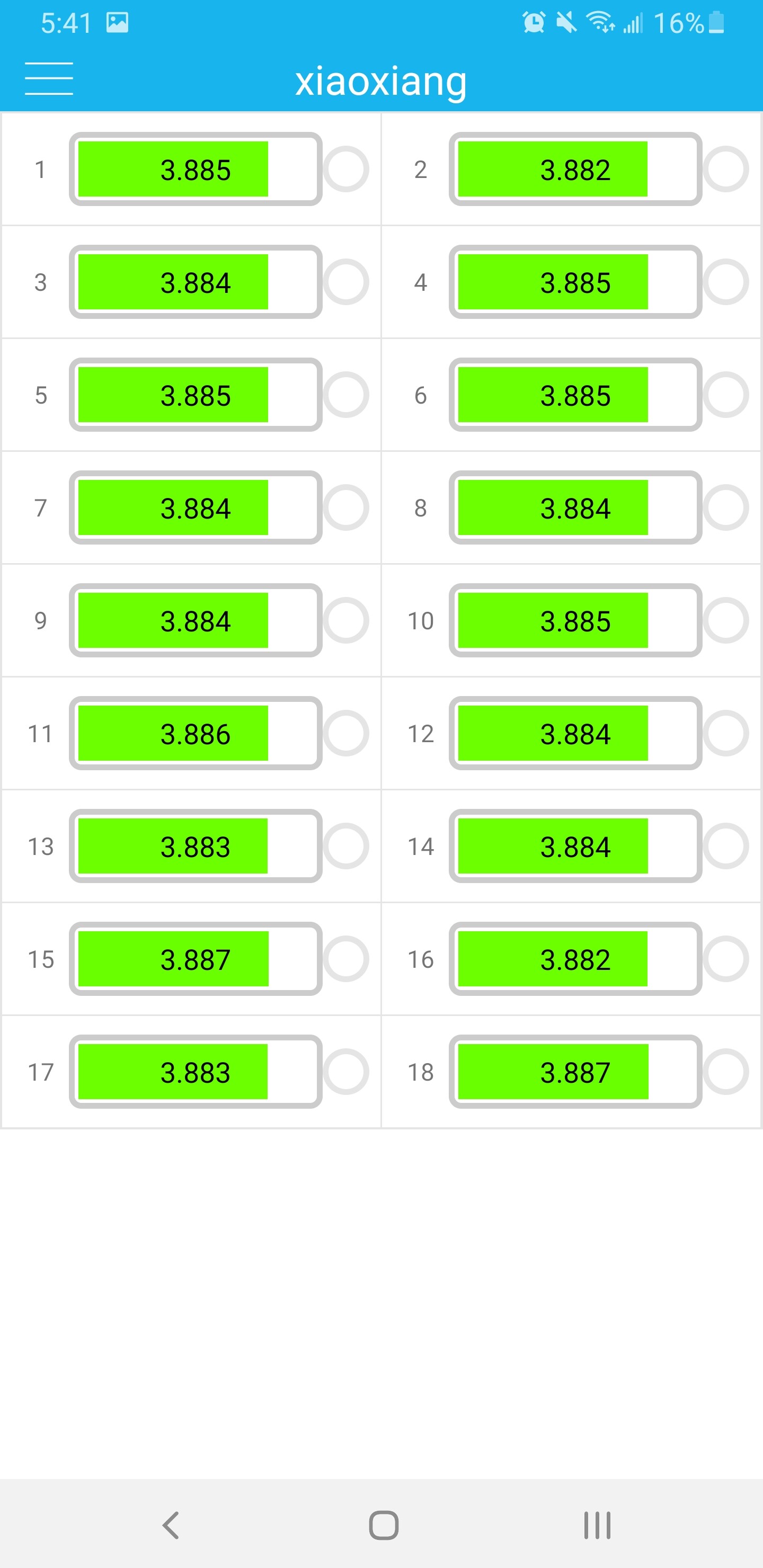

All is well, battery has been repaired, turns out i had some cold welds on the negative side of a few cells in a p group… battwry is rebuit. Currently uploading a ride video to you tube from a few days ago.

I’ve occasionally folded nickel over the cell edge and heard a few pops of welds breaking. Usually when my electrode tips get overly dull.
