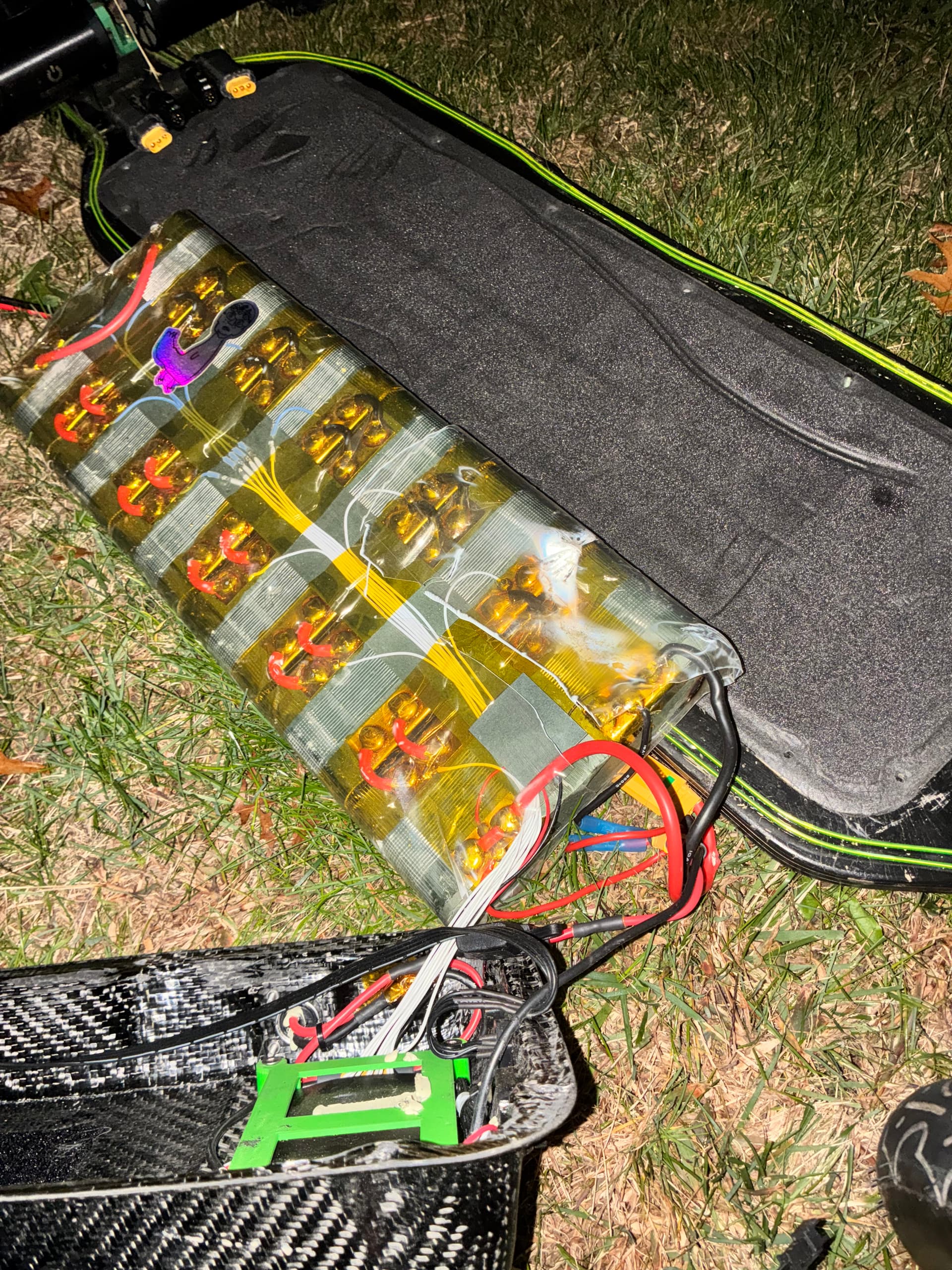

Bought a Plutonium in June without battery. Purchased a “new” 12s6p battery from a member here. Hooked up BMS and battery, cell 1 was low from the start and would not balance and the board would not take a charge past 50% so I didn’t ride it much (maybe 10 miles) because I wanted to look at the battery hoping to find a loose weld or something…

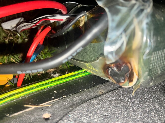

Tonight was that night, I open it up only to find what looks like a ton of moisture and corrosion? It’s been hanging on a wall for like 8 weeks and was not like this when I got the battery that’s for sure. So I start to cut off the shrink wrap and the battery starts smoking, luckily I’m in the garage and was able to ditch it in the side yard before it ignited.
but now here it sits about 10ft from my house and I’m not sure the safest way to proceed? Pictures below. You can see where the burn started, once I through it down, it stopped.

Not sure how a bad Pgroup discharging itself would suddenly go off like that right as you take it apart. Makes me think something about its construction was off.
Same…but now what…afraid to move it again to be honest. Might call the FD just to be safe.

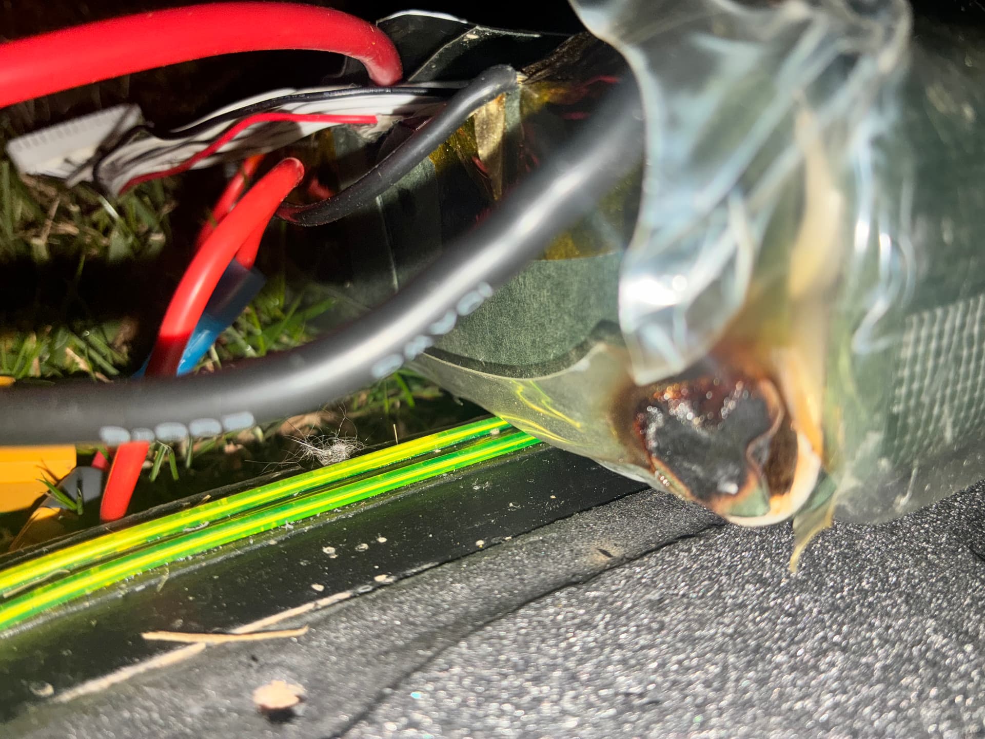

Uhhh did you cut through the nickel tab and short it perhaps?
I started cutting from the top, here’s a better picture of that spot. The wrap wasn’t cut there that’s what melted when it was smoking. 5 seconds of smoking in the garage, 5 more carrying out, whole situation lasted less than 20 seconds but was/is scary AF.

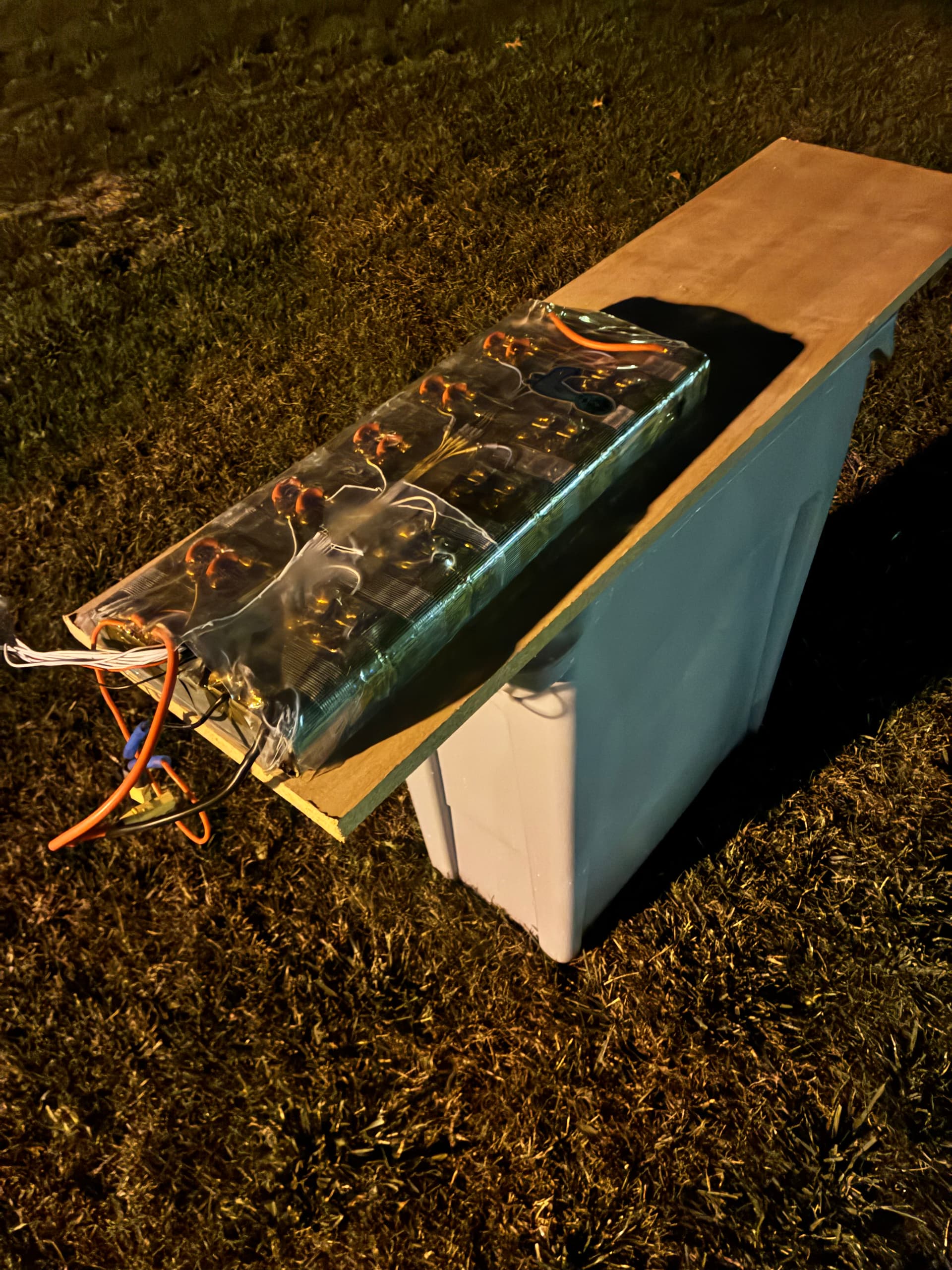

Got it disconnected and further away from the house. Sitting on a board above a bin full of water.
It’s going into the low 30’s here tonight so everything outside will be covered in frost, including the battery if I leave it out - should I cover it with a blanket? Is it salvageable or do I cut my losses and call it toast?
the battery ‘hanging on the wall’ was pgroup uo, or down?
Any chance if fell and then landed on that corner where it burnt, and was rehung?

I’d not allow it get frost on it
To get a better idea of the state of the battery, you could measure the voltage of each of the p-groups using a multimeter
the entire board was wall mounted, not just the battery, but yes that cell would have been on the bottom, no damage to the board or enclosure though so I don’t think it fell off, but that cell has been off (.9v) since I got the battery.
Yeah this was the plan tonight although overkill solar always showed p-group one not getting above .9v.

Ive blown a hole into a test battery when spot welding. I put the cell inside a plastic bag, and the inside of the bag looked similar to condensation a week or so later.
Perhaps when you removed the heatshrink oxygen got inside and the liquid electrolyte did some science and smoked.
I think I’d carefully remove that p group from the other 11 and take the rest of the battery inside and measure them.
If that entire p group is 0.9v and not just 0.9v less than the other 11 groups it likely can’t catch fire unless you introduce a spark to the electrolyte, if present.

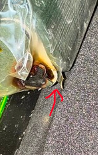

Is that the postitive or the negative end of the cells three?
it looks from the pics like the negative. ie the bottom of the cans, which are aren’t near much to short out, unless it did it i the case.
which lends more weight to bad weld / puncture.. which woudl be the more dangerous situation.
hmm.
Yeah, it’s on the negative side. I looked at it quickly again the other day and noticed smaller burns on each cell on that side of the battery - would this identify a cause? I’ll get some better pictures. Thanks for the advice, I’ll update soon!
