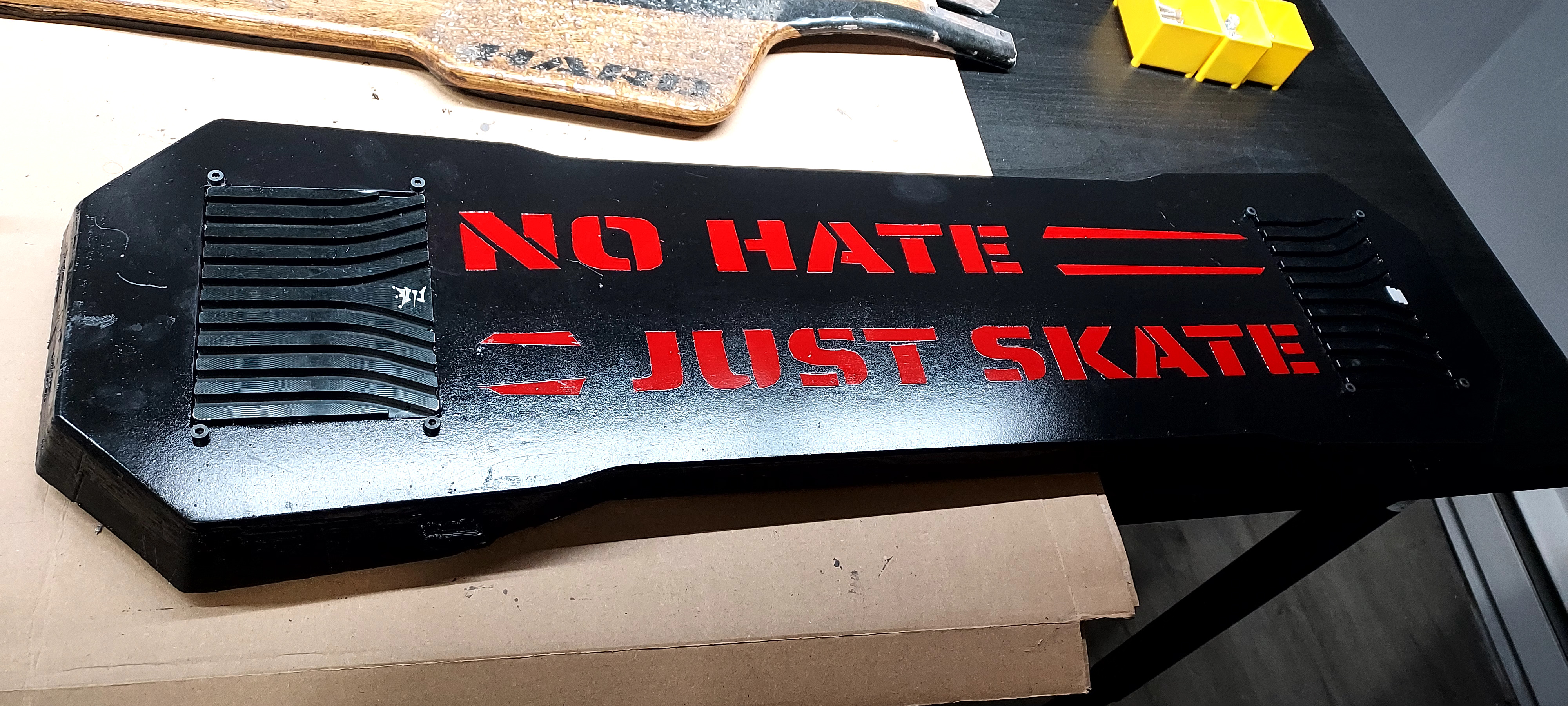

I also got the enclosure glued together, with the aluminum plate painted up nice and pretty:
Which means the remaining items are the battery build and the drop brackets. Stretch goals are a simple relocation of the legstick to gain back a little standing platform, seeing if I can mount my steering damper, and to print some footstops that do normal footstop things, but also act as stops for my heels and toes to prevent me from sliding around. I’m going to avoid using a binding if possible, don’t wanna risk another crash like the one I had at Electrify expo.
