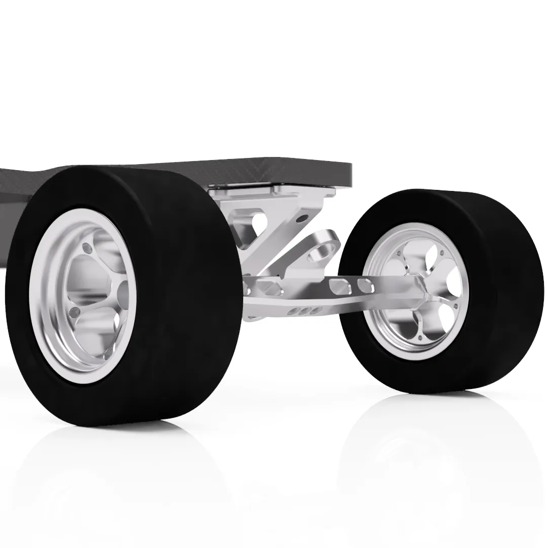

hmm that part of the NKP rod end really does make sense to attach the guidance onto.
Been thinking about this feedback a lot, revealed to me that the one of the major Strong points of the SRB NKP is how the steering misalignment is prevented with a huge lever arm by having the small links spread out on the axle. The closer the guide pivot is brought into the center in my design especially with a compressible guide like 96a urethane pivots the more deviation as you said at 0 degree this being very bad.
I still want to try to make this ultra compact and adjustable truck using the SRB rod and axle but in order to overcome the issue just mentioned I think using two pivots and purposely misaligning them using shims to make as little slop as possible, basically using the pivot cups compression to get rid of slop from the steering guidance.
Still figuring out the best design for the parts that attach the extra pivot there, I want to avoid decreasing ground clearance at all, but throwing some bolts over the top to connect those guide bars is the best simple idea I got. Alway a tradeoff to make more complicated CNC parts for a possible cleaner looking/better design.
shims should go on the blue selection.
edit I realize now because the way the rod screws in that there was no way it was gonna be perfectly aligned anyways. With different bolt on pivot parts I could increase the distance to try to combat slop, but that would decrease ground clearance.
I suppose thinking about it that makes the pivot cups wear out faster and be treated as a consumable vs the reliability of rod ends for long term use, so this may still have major downsides of a design for speed if space is not hyper critical.
Quinn, this evolves very interesting.
Stooge Truck design 2.0 :smiley:
This is pretty good so far, needs to be ridden :handshake: :pray:
So nice from Stooge for giving you feed back as well, thats great.
All best wishes and march on with this project pls

There is two massive bushings and suspension and steering all happening.
Really interesting design to have arrived at.
@Flexboardz it’s like a quad version of your boards.
So it’s like… RKPKP? Curious how that feels to ride.
Not sure that’s achieving much.
The extra bushing is mostly in the same position that a set of bushings would normally be.
If you’d just put the kingpin there instead, that’d probably just simplify things.
