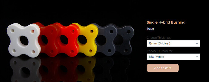

Wonder if anyone would want me to make these bushings fit they seem dope. Could easily stack them in a much much smaller space, lengthwise at least compared to all other options.
