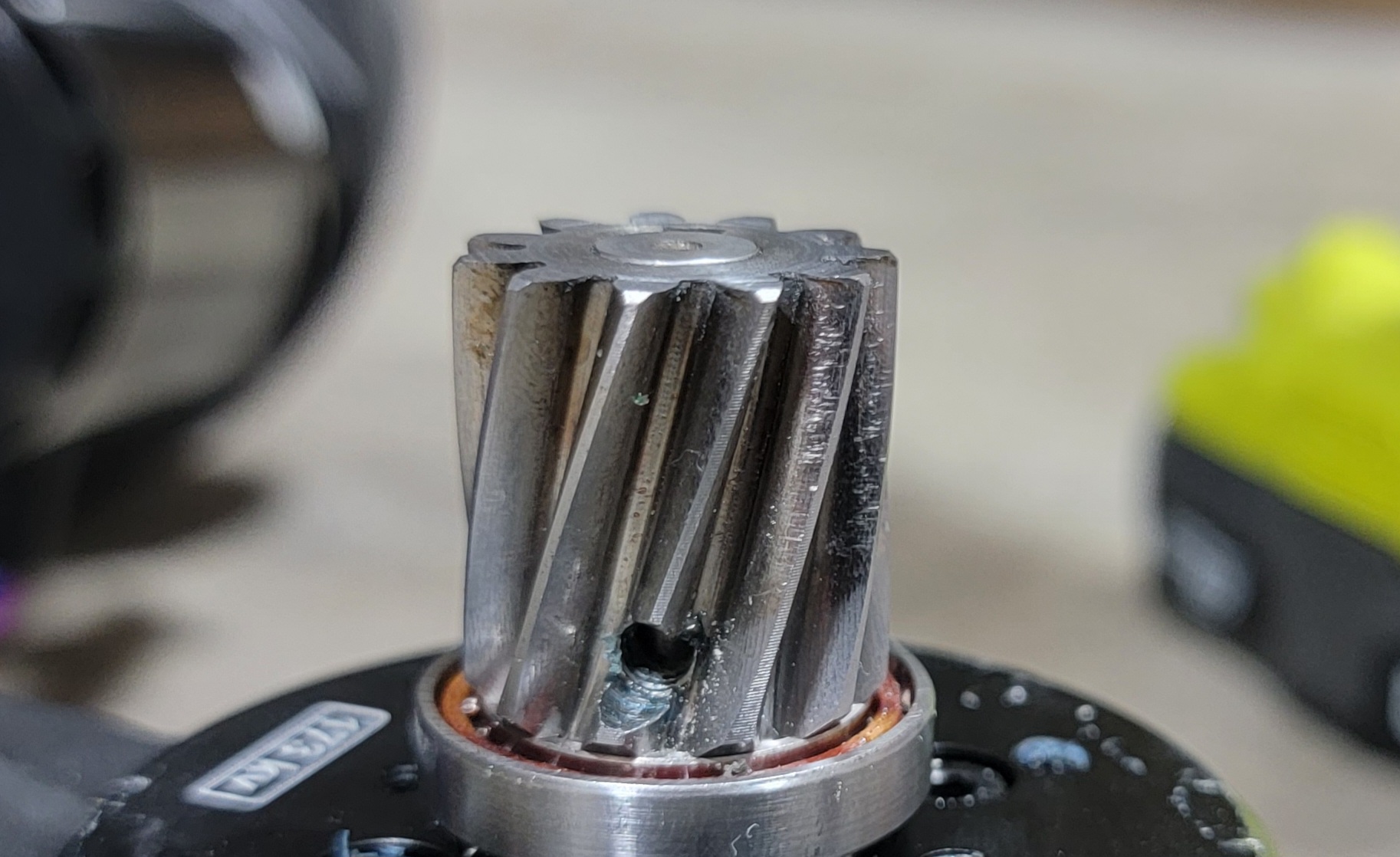

So I just got my SKP 6384s and Newbee 4GS gear drives set up today. Only to find one of the pinion gears scraping the inside of the gear cover…

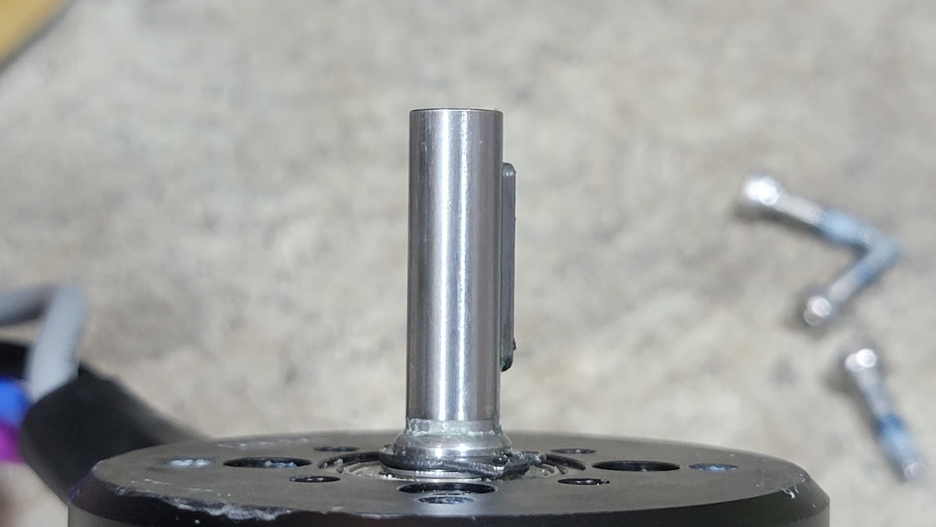

I torched the pinion to remove it and see if i maybe didnt have it fully seated but it was installed properly. I spent a while sanding the area inwide the gear drive cover where it was making contact with but it still wasnt enough to eliminate the contact. It looks like the SKP motor shafts have a slight step right at the bottom which is preventing the pinion gear from sliding all the way down onto the shaft, and the Newbee gear drives arent designed with much of any tolerance to accomodate.

Based on my measurements, it looks like 1.5mm would work. The newbee plate is 2mm thick and the step on the SKP motor shaft stops 3mm from the motor. Is that thickness doable? Looks like Unshackle could use a pair too.

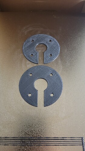

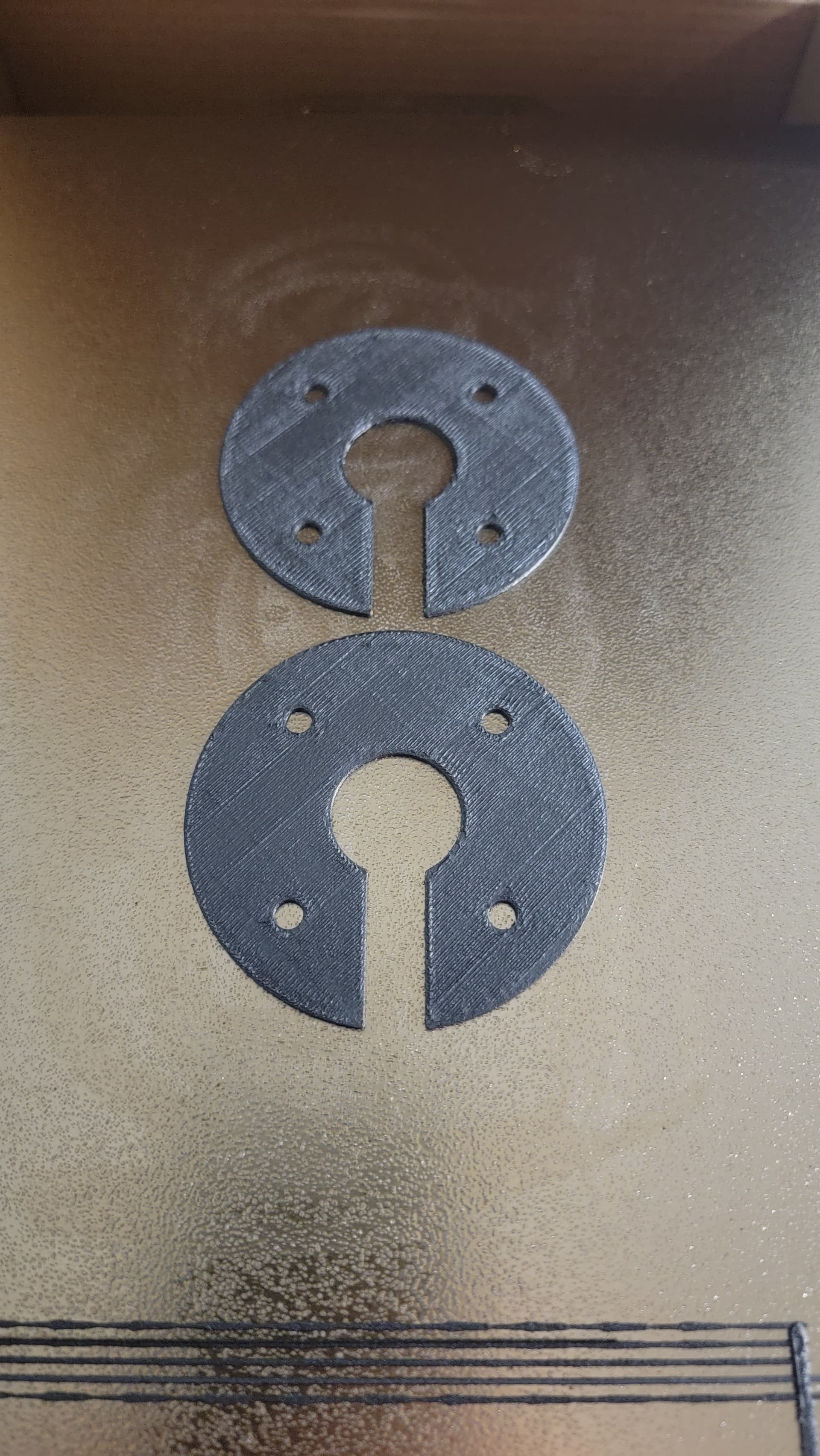

Just 3d printed some PETG-CF, 1.6mm thick, I should be able to just slide them out and replace with a aluminum spacer if thermals become an issue. (thanks for the design idea @andoug )
Hope they hold up! My motors have been getting pretty hot due to the summer weather. I reached 100°C the other day. PETG begins to soften st 85°C
Ill definitely keep an eye out, worst case I plan on getting them cut by SendCutSend in AL or steel when I do a different order with them.

@Unshackle @andoug if you guys still want sets made, let me know - will get started this weekend.

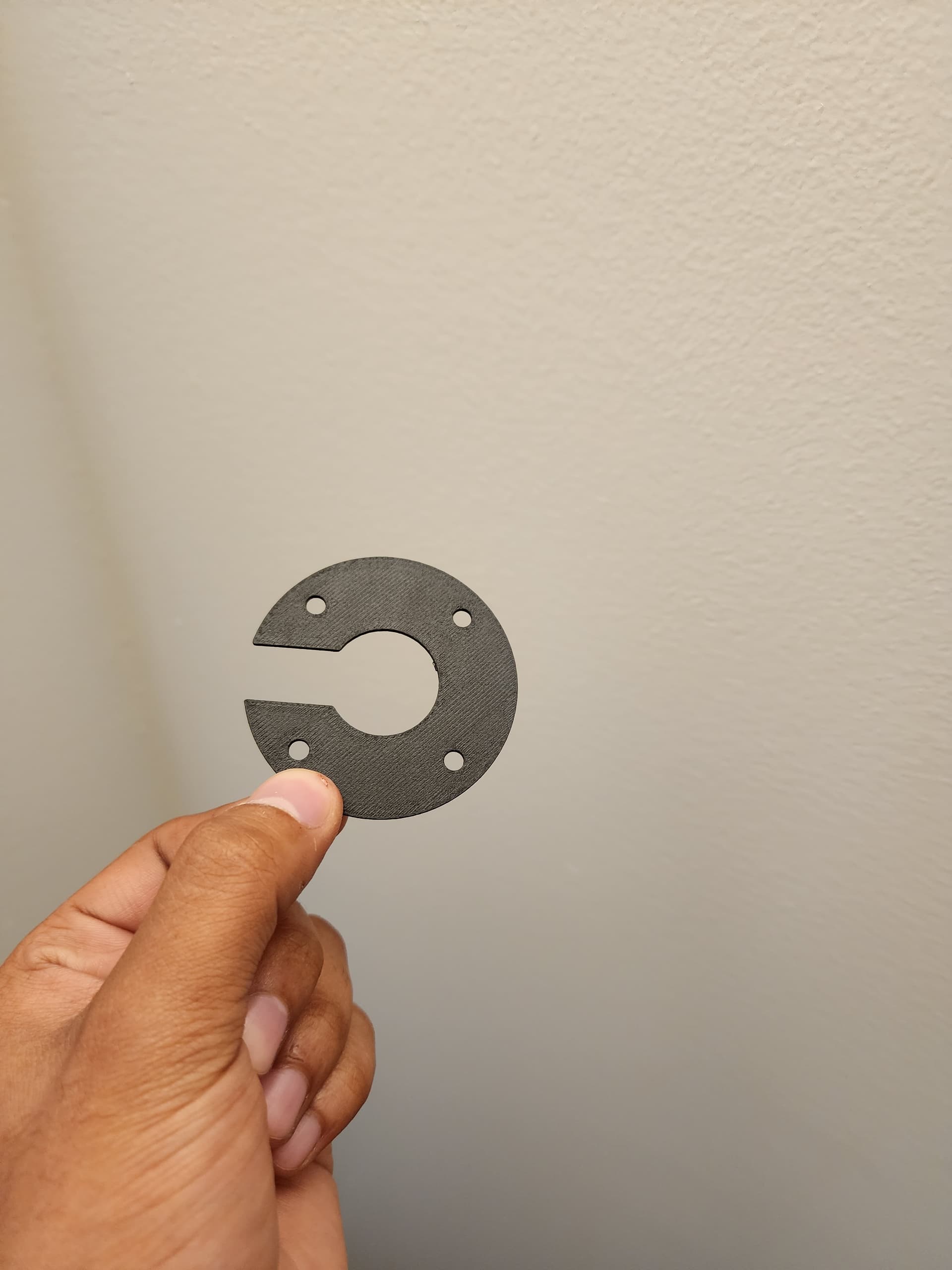

One thing to note is the slot width. My first set were wide enough for the motor shaft, but they ended up hitting the c clip.
I’m good for a set. ~3mm is preferred for me. Not sure what everyone else wants
For you i could just send you four 1.6mm thickness for you to stack, probably the simplest that way.
