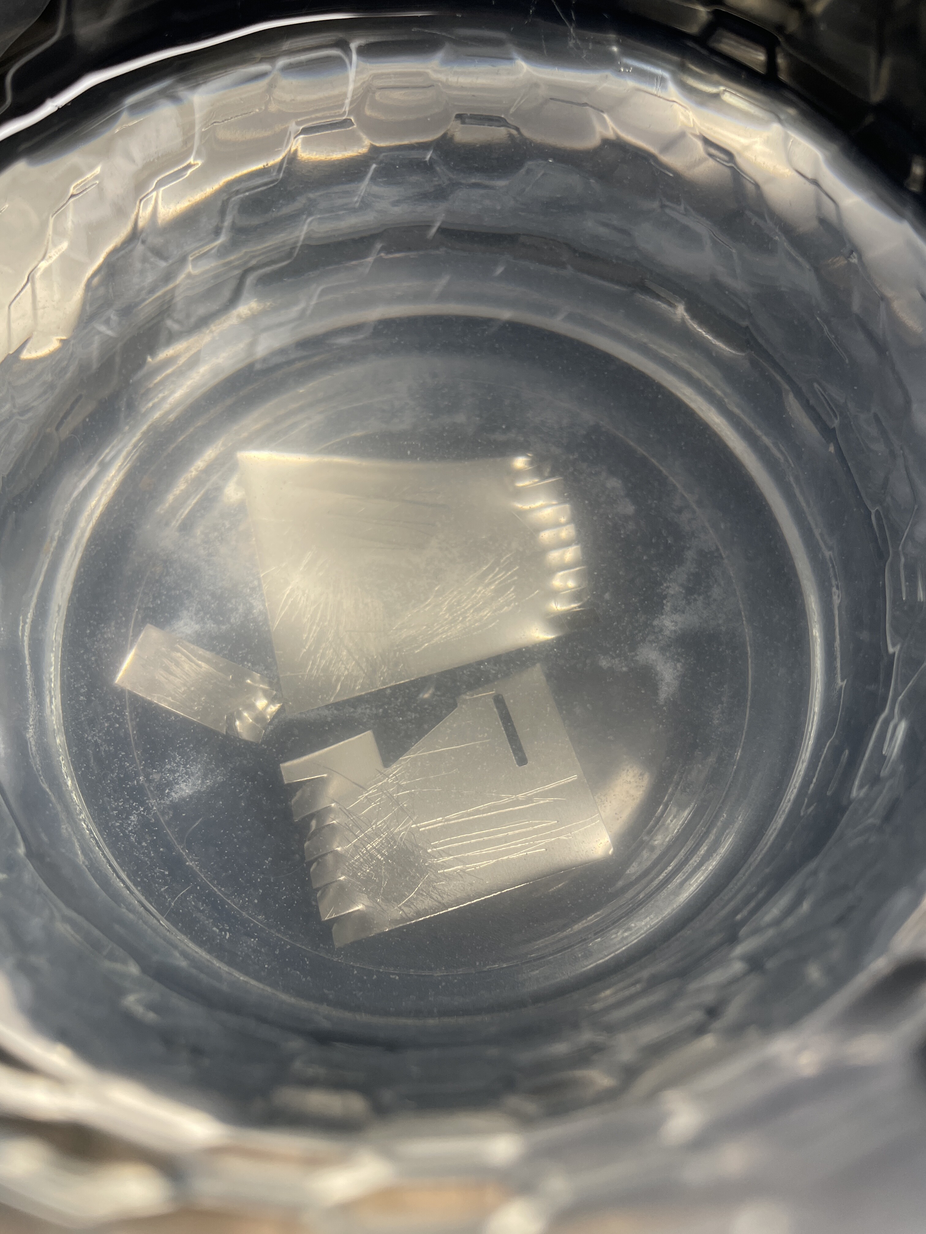

Nickel has arrived! And lasted 24 hours scratched up in salt brine with no rust (pic blow)

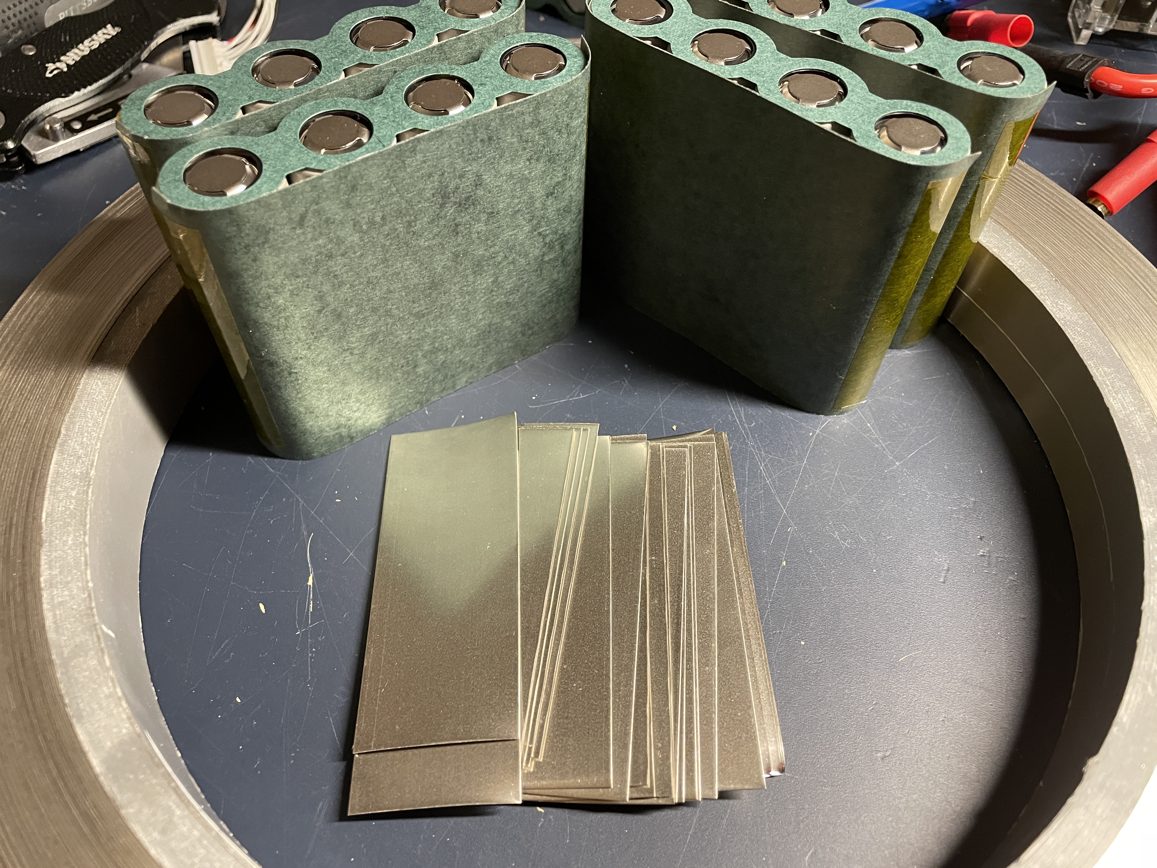

Pricing is going by weight for now. As reference:
– You’d need 100G of .2x30 for a 12S4P 21700 flat pack
– You’d need 70G of .2x25 for a 12S4P 18650 flat pack
– The .1x8mm is for BMS tabs or things of that sort, 1g ~10cm, shouldn’t need much
