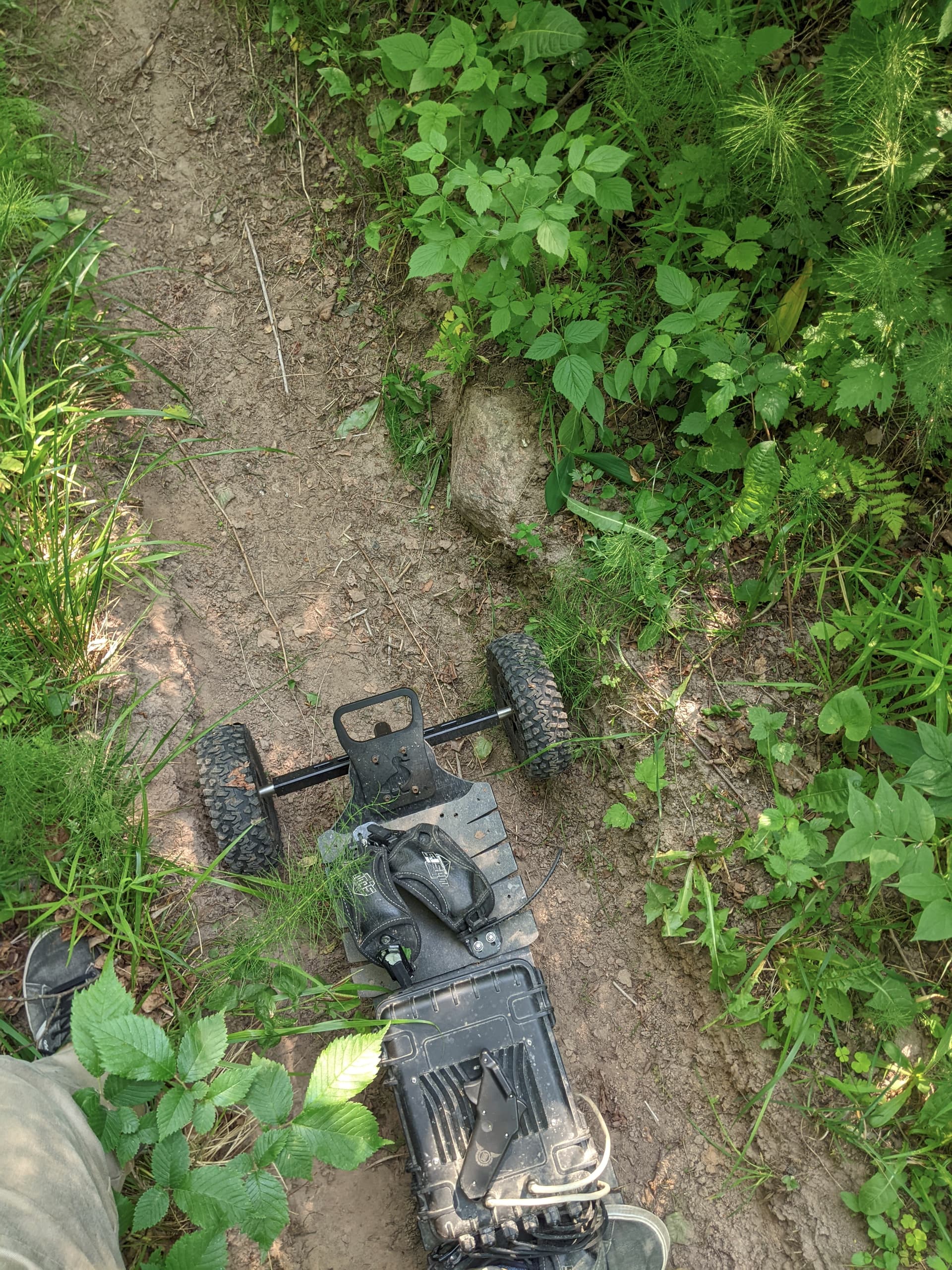

Recently I’ve been riding a lot of technical off-road trails. These are mostly trails that are made for mountain bikes, or sometimes dirt bikes, so they are super narrow (mostly one-way tracks), very twisty, and there are often rocks, tree roots, and stumps that make taking the ideal ideal line, especially with trucks, tricky. It’s a great challenge for building skills but also for challenging the board. Turning and traction are constant challenges.
I’m curious if anyone else is doing such riding and what they’ve found works for them in terms of parts and setup. I’m currently using a build with Bro deck, Matrix III 420 trucks (soft bushings back and front) with extended axles on the rear only, and Jump Drives running on 8" Mud Pluggers.
My most recent change was putting a narrower truck at the front which has been great for turning but I’ve had to try to remember that I’ve got a wider truck at the back. One of the first times out I forgot about this and picked a line with the front wheel passing right near a tree stump and then of course clipped the stump on the back wheel!
I should also mention that most other things I’ve tried including running on 9", all-wheel drive, other trucks, have been challenging. I’ve found there’s a lot of tradeoffs with setups for this kind of riding. There are definitely times when the motors don’t have enough torque to start in some places, or only two wheels can’t get traction and are just spinning, and I miss my 4WD, but the extra weight and torque on the front is too much of a penalty. Also, 9" could help with getting over some of the crap on the trail but the penalty for agility is also too much.
