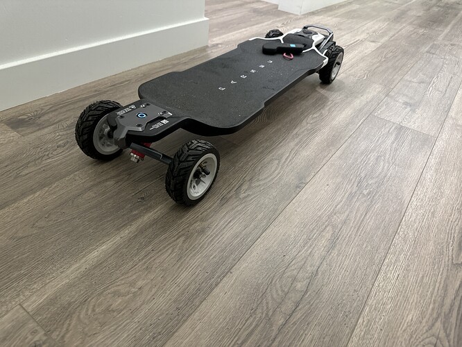

Annd, pretty photos of the board.

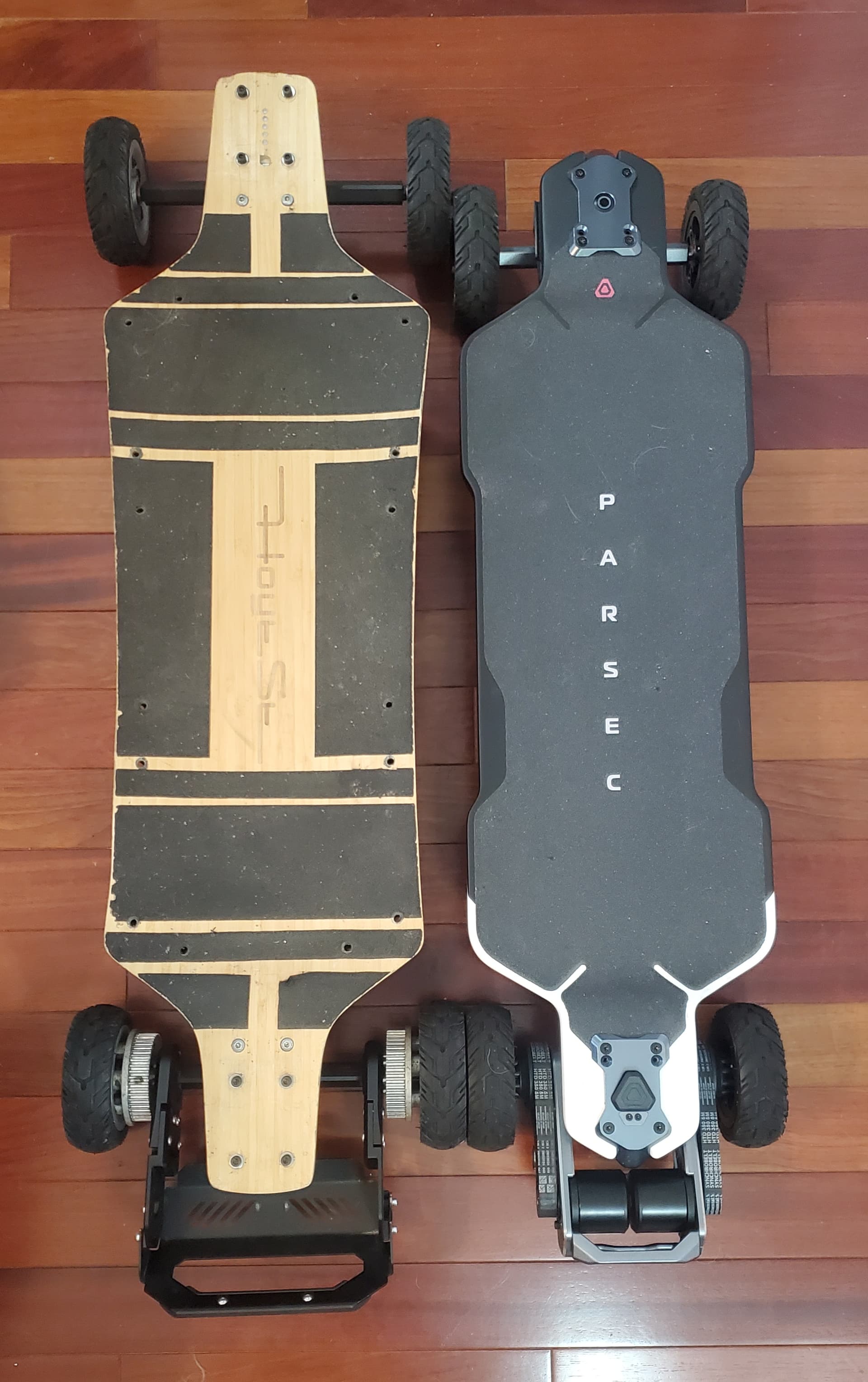

I have Hoyt 5 inch pnumies, which actually measure out to 120mm diameter, and are narrower than the thane 120’s this board can run, so they should fit, but the Hoyt pulleys don’t use a bearing. I assume because they and the hubs are aluminum and stiffer than plastic. Would there be any issues running these on the Parsec without a pulley bearing?
What I’m running right now actually
Pulleys don’t line up perfect but I knew I’d only want them on it for a lil while
Nice, I need details.
What tooth count are you running on the Hoyts?
Any clearance issues with hard turns?
How is the acceleration, braking, and top speed?
Handling?
How far off is the pulley alignment?
Why don’t you want to keep running these, and what is your preferred wheel on this board?
