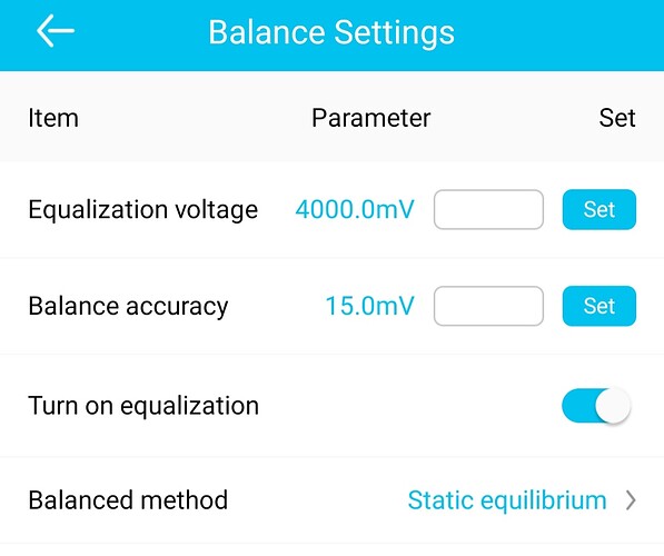

here are some screenshots of the bms settings…spot anything i haven’t?
I don’t understand what your asking?
You’ve provided photos of your smart bms settings page, what’s the relevance to an over voltage fault?
Is your bms not bypassed on discharge?
What exactly occurred, when did it occur, what charge level was your battery at prior to it occurring?
Yeah, on top of what Avi is asking I’d also be curious about your motor, battery, motor/battery amp settings, and regen settings

Ah, your settings are fucked. Your smart bms will not handle 80a.
If your bms is not bypassed then it will shut off charging on over voltage. That power has to go somewhere, so it may have bricked your esc.
If i recall there’s a fault counter in the android bms app that should say if it hit over voltage.
Why was your bms replaced?
I can see how the thread may be confusing lol excuse my adhd! So i have full exceleration on a bench test just no brakes,ill try lower the battery amps to 60
Your bms is probably rated for 20-40a set your battery current with a margin below that number. You can find out bassed on the bms model number or in the app. This is why we bypass.

My bms is rated at 60a…i totally overlooked that when fitting the new one not sure what the old one was rated at! Its been running fine as well until this firmware issue,unsure if its related!
My xenith has now gone back in to this “read firmware issue” so ill have to sort that out with the st link! :crossed_fingers:
So i found the old bms i replaced and it was also 60a! The previous battery owner thought it was 90a and had it set to 80a maybe thats what killed the previous bms!
I just replaced it for the newer version and kept the same settings “doh” well at least its not dead,think i will go the route of bypass soon anyway!
