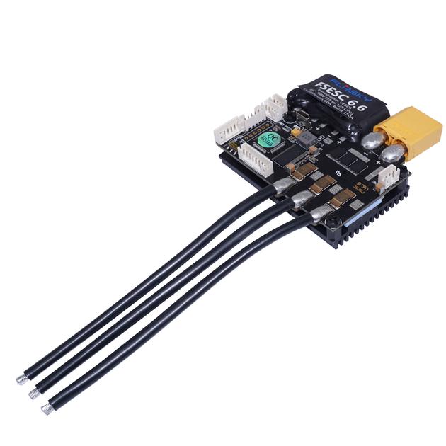

Next I need to settle on an ESC. I’ve read that singles are better than duals since it is easier to deal with replacing one once I eventually brake it or it fails, so my current front runner is (2) FSESC 6.6.
However, I don’t know enough about ESCs yet and still read alot of people using 4.12/4.2s. So am I better off with the 6.6 or is there a go to ESC for someone will be be programming their first VESC based ESC? Also, I was hoping to not have to spend over 200 euros for my ESC needs on this build and am waiting to see if there are some good black friday sales coming up.

If you aren’t going for speed and torque (and you admittedly aren’t with 10s) then you don’t need to be pushing 50-70A to each motor. Consider the dual makerx @ <40A per motor if you’re trying to save some coin. Added benefit, your range will be much better.
Well, as you go for dual motors, the unity is a dual motor controller, not as the single FSESC. The unity is so easy to setup.(Change XT 60 for a XT90 connector and the 3.5mm bullet connector to 5.5mm(I have 3 5.5mm bullets left here, that I can give you)). 140€ for the single fsesc and I can ask my friend for the price, who has the unity. Two single fsescs over canbus will cost you more than a unity.
Thanks for the tip, I just read up on the MakerX dual v4 ESC and agree, for the price of a single fsesc I get both, and for my needs it should handle what I need it to.

From what I’ve read, that is a good price for a unity…and I could avoid VAT or shipping compared to buying one online, seems like a great deal. In your opinion, is the unity worth the 100+ euros more than the MakerX dual?
Roll to start, built-in anti-spark, built-in BT module in use with the Focbox UI App(can be upgraded to the Metr pro version for logging).
Overvoltage protection(they are the only one with this), higher current capabilities(for the future, if you think so.:wink:)
