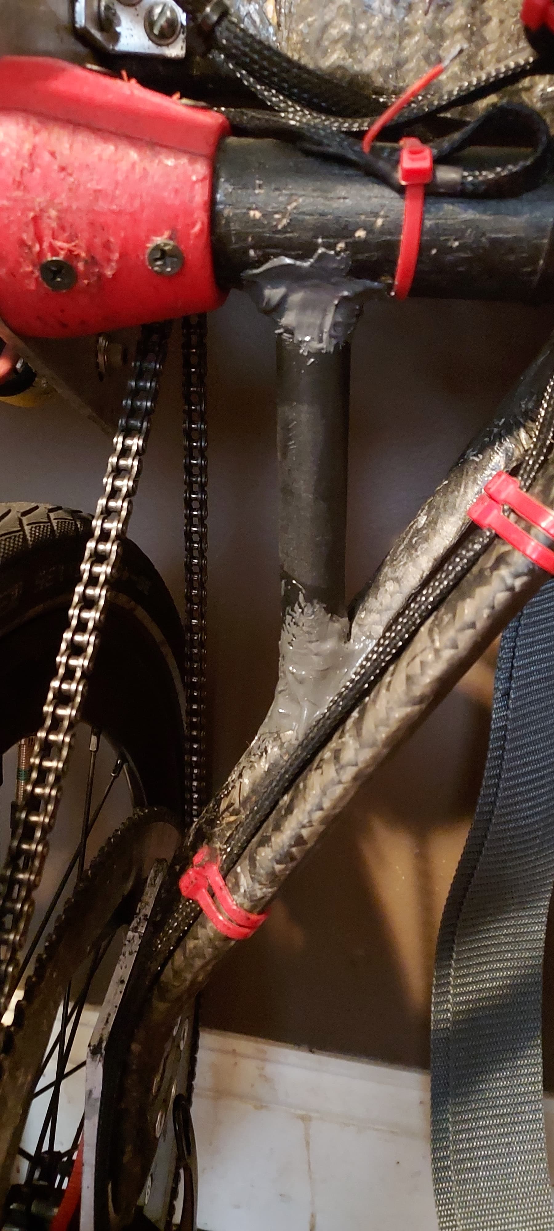

I guess that’s possible, but I don’t think it’s likely. It happens regardless of chain tension, and I’ve heard the motor Buzz at a higher frequency when it’s disconnected from the rear wheel once or twice. I can try putting a brace on the rear Fork to test this idea, though.
I installed this haphazard stiffener bar to resist chain tension, and it definitely seems to work. The vibration is less intense and takes place over a much smaller range of speeds now. The problem isn’t completely fixed, but TBH it’s good enough that I’m going to call it done. Thanks for the suggestion.
