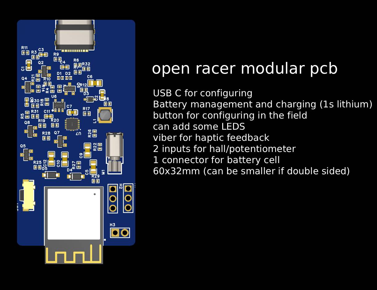

Just threw all components from dual throttle and arranged a pcb just to show how the idea would be. Could be much smaller if placing the components on both sides
I think it’s a great idea! One very important feature is reliability when many of the the same remotes are next to each other. For example the GT2B fell short in this. Normally the radio connection of it is very robust, but at esk8con when many people use the same remote it can have issues for some people.
Another important thing, that’s quite subjective, is ergonomics. Your aproach to this would be a great solution. But to race with a remote it needs to be ergonomical and needs your preferred throttle type. Single trigger seems to be the most common within the fastest racers.
Given that this PCB is easy to design around, I’d be happy to design my own single trigger casing around it. From my perspective this is small enough, no need to go smaller by increasing cost (components on one side is easier and cheaper).
I think having the option to connect the screen onto the remote would be nice, yes we don’t look at it on track, but for example seeing accurate voltage readings for the board battery or ESC/ motor temperatures immediately when coming off the track would be nice.
Thanks for the input!
I can definitely add an LCD connection header on the PCB.
Regarding reliability: the BLE stack I’m using is about as solid as it gets — it’s a lightweight protocol over BLE with the amazing frequency hopping, so connection shouldn’t be an issue even with many devices nearby.
I think I’ll move forward with the modular PCB design and offer it in my store. Really looking forward to seeing riders test it on the track.
Both firmware and hardware will be fully open-source — excited to see what mechanical solutions the community comes up with around the project.

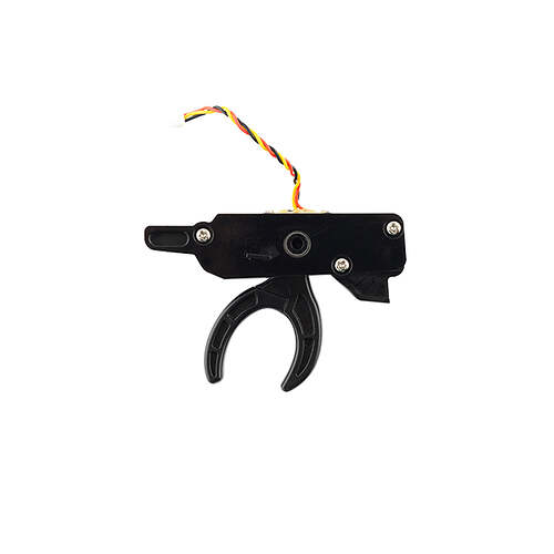

Here is your trigger assembly.
Hall sensors.
Adjustable spring tension.

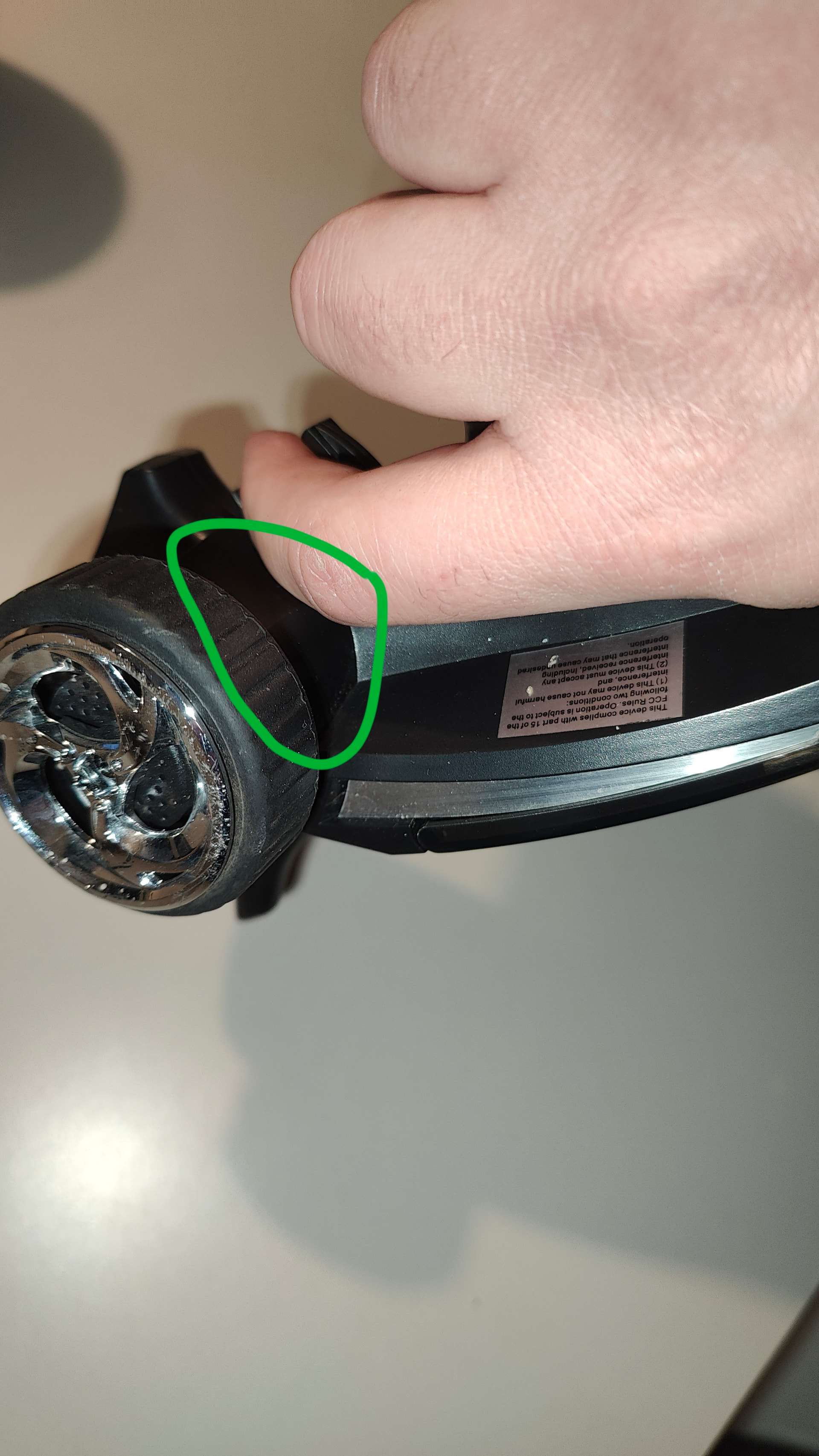

When the wheel is still on it, it’s incredibly uncomfortable for your right hand since it’s meant to be held in your left as it comes. (User uses right hand to steer RC car). I couldn’t use it at all with the wheel on, real crampy on your hand.
once you remove the wheel it’s all good.

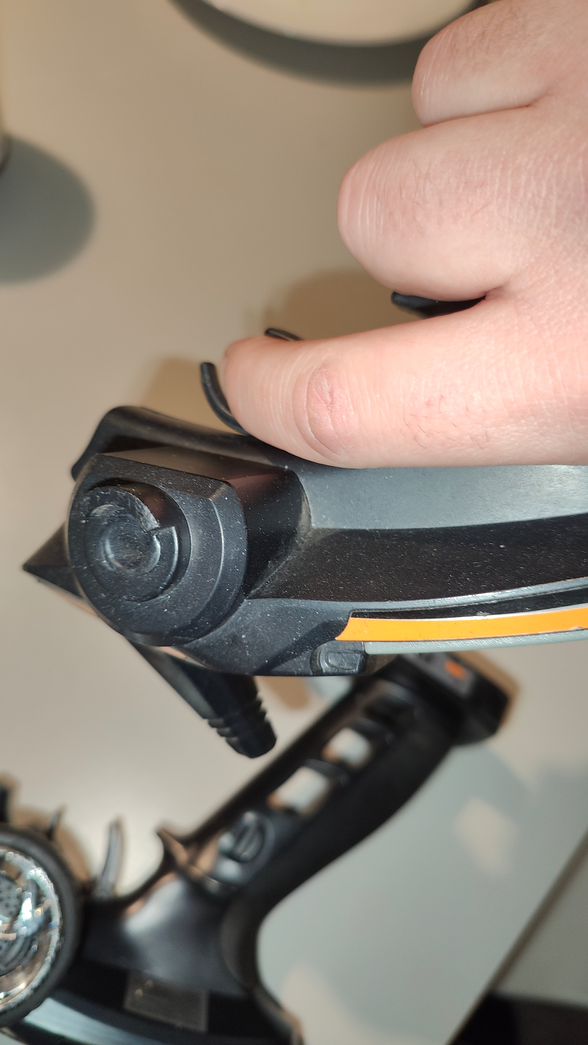

The wheel itself doesn’t get in the way on that but the plastic around the wheel does and it’s very bad for right hand.

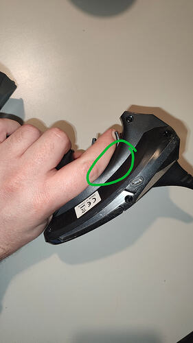

Also, both for left hand and right hand, my finger hits the plastic there as well:
Both solved in the GT2E:
