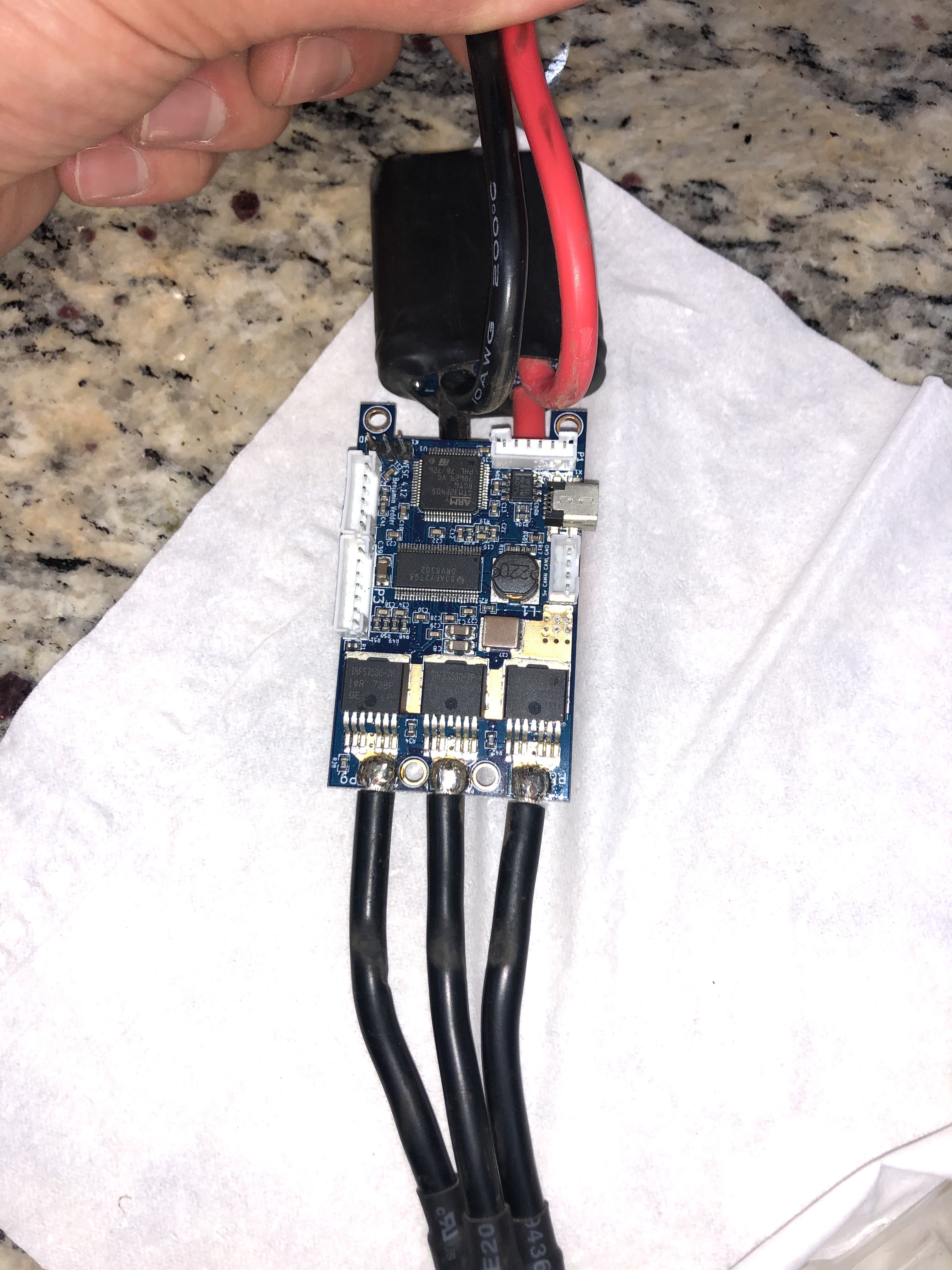

Just gave it a shot but you are right, the vesc will clear all faults after a power cycle, plus i re-did the firmware update to clear anything and still no luck.
I also plugged the non-working vesc in the working motor, completely redoing the motor setup and app setup as a single vesc system just to test the individual vesc and still the vesc is blinking red LED after i do the motor/app config.
Yes, i have and everything seems good. the motor is actually working, just making a very weird white noise that is not smooth like the other motor and this dident happen until after the FOC motor wizard.
Yes, i can still completely connect to the vesc properly with full success, thats what is confusing me into thinking its not a DRV error (which is usually what happens after running 12S on FOC).

is there any visible damage on the vesc chips?
well that depends :smiley: 12s foc on my mtb and several thousand km without problem. (also TB 4.12 vesc)
Usually it’s app config settings.
No visible damage on any of the components of the vesc, here are some images below:

Just noticed your reply. The DRV chip on the VESC was burned out from what I believe to be one of the motor phase wires accidently came apart when riding causing a short.
I replaced the TB VESC with a Flipsky VESC that I found on amazon and everything worked
