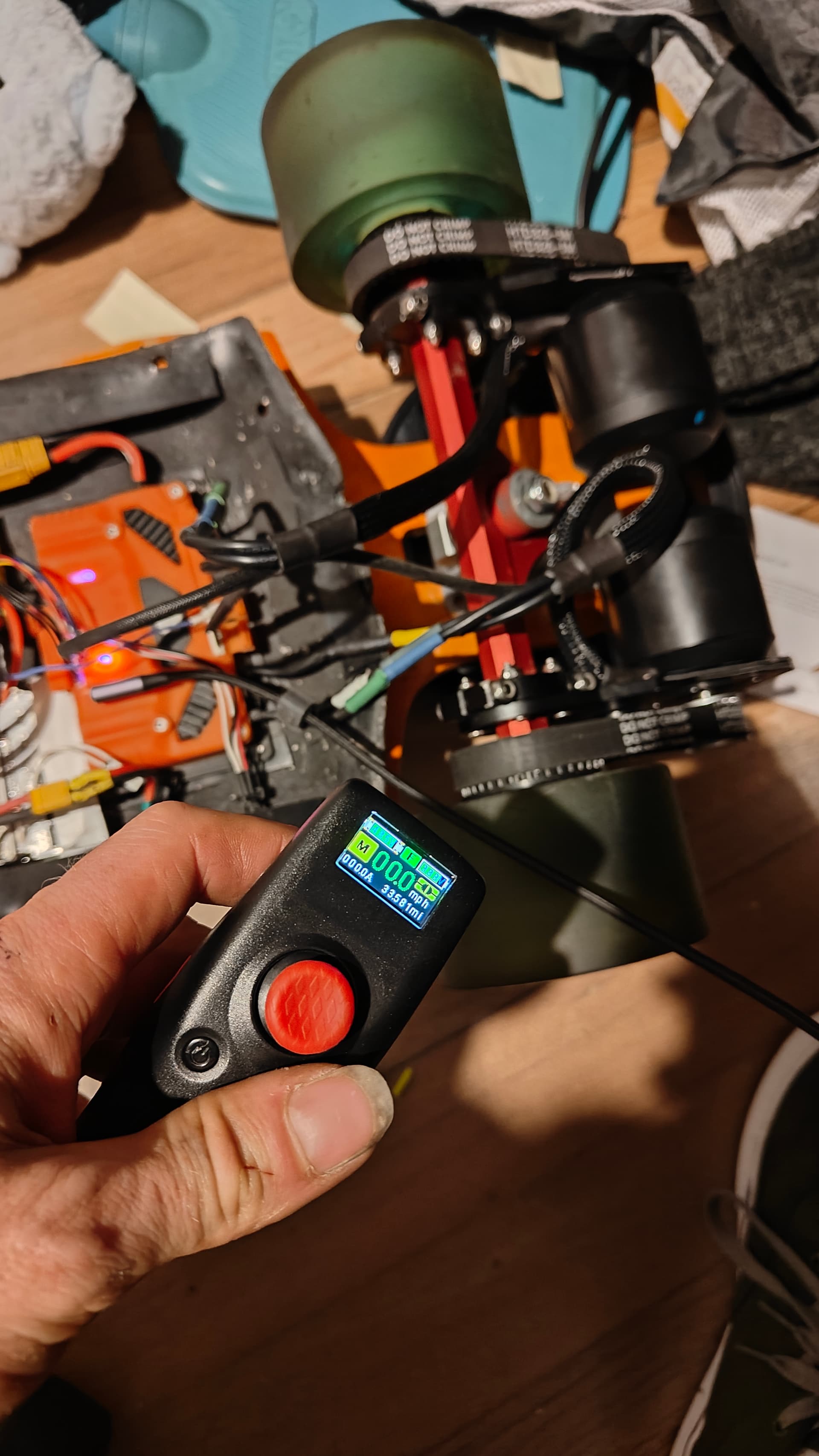

One Motor Moves with Remote
Remote only controlling one side. Had this on my other board and enabling all the CAN channels sorted it. Using VESC app I can move both motors.
Focbox unity with Voyager V2 remote. All on 6.05.
Tried re uploading firmware, updating lisp scripts on the Voyager, re doing config.

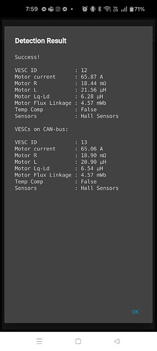

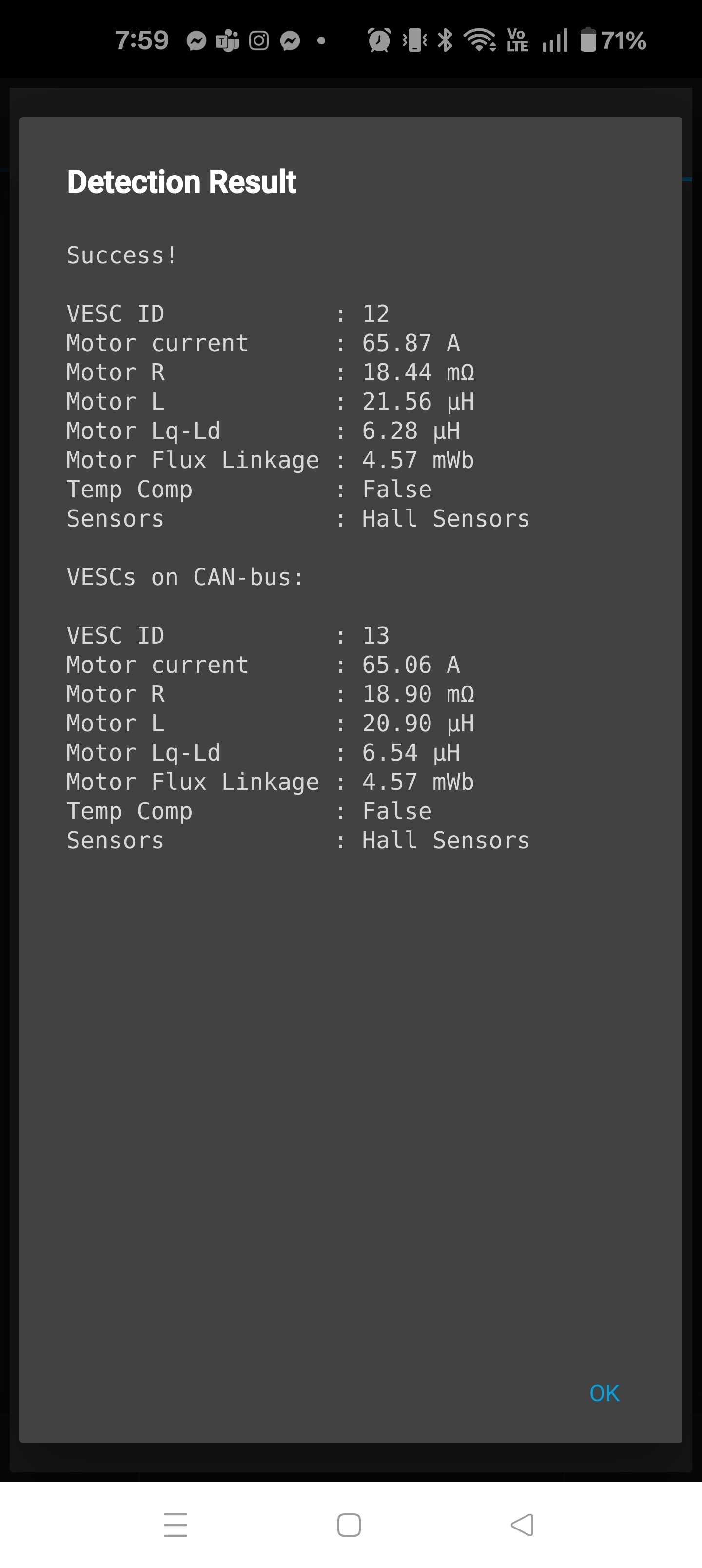

Does running the motor detection show both motors?

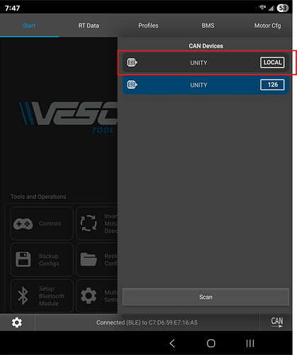

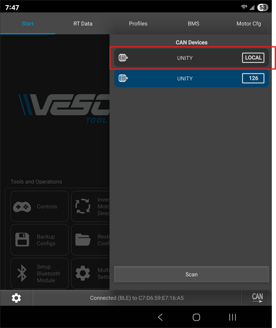

I run the same ESC with the Android app and always have to select “Local” for the CAN connection before running detection. Both motors will usually spin during detection, but I only get results for one.
Yeah both motors show up and read correctly.

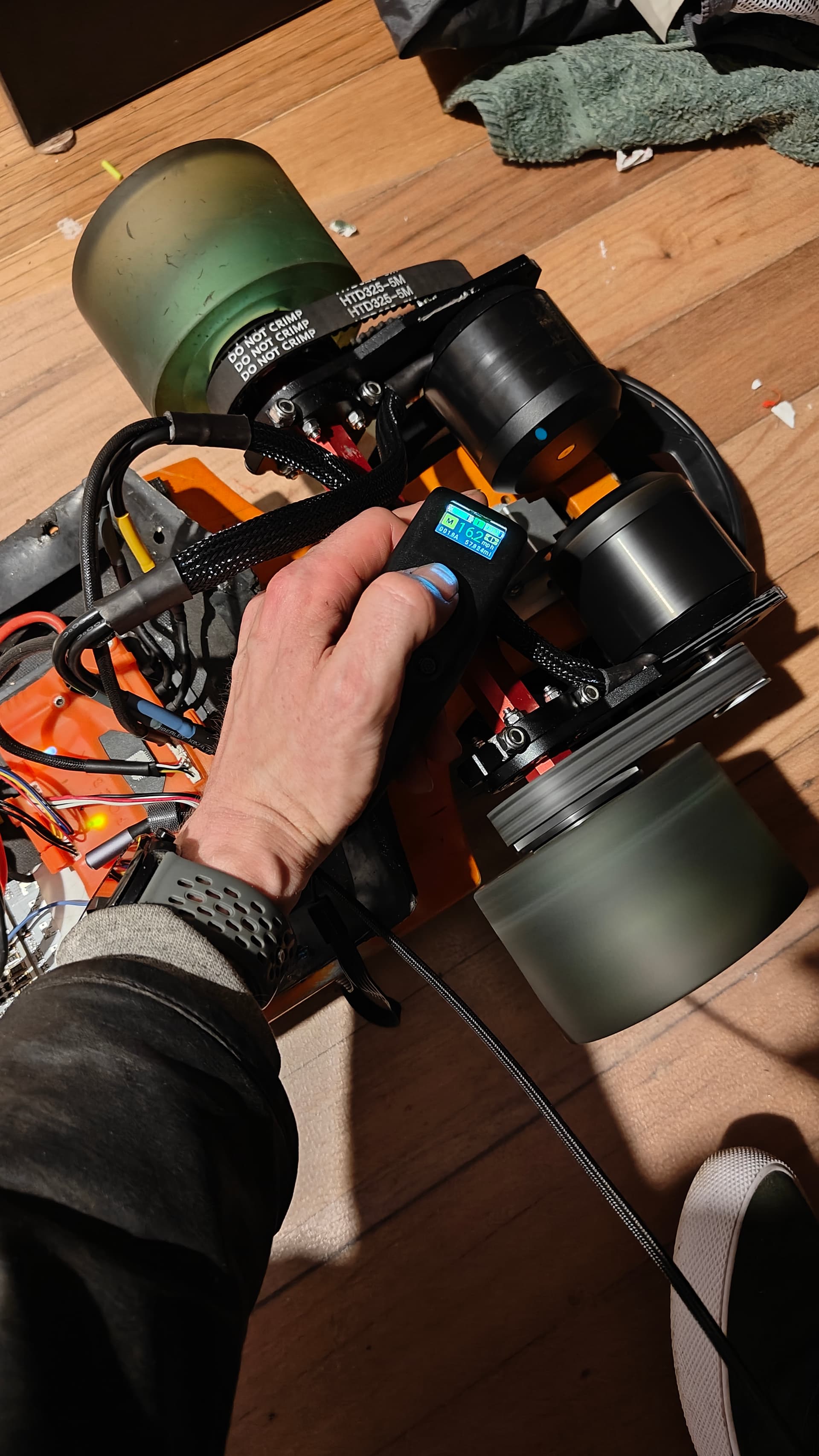

Right. Tested on another Focbox Unity and using this remote does the same thing. Only controls one wheel.

Yeah both set to UART. Both spin fine when running the FOC Motor Setup wizard.

Yeah, check settings in uart and VESC remote. Maybe move receiver to other side if that’s an option. Try setting the master side to uart and other one to off and check the can status in the app too. If the app moves both, you should be good unless something goofy is shorted.
VESC app moves both. Tried the BKB Voyager V2 remote on a Flipsky dual ESC and the same thing happens… It only controls one motor
