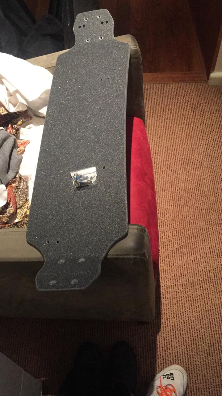

Trampa street carver 14ply
Trampa bindings & heels straps

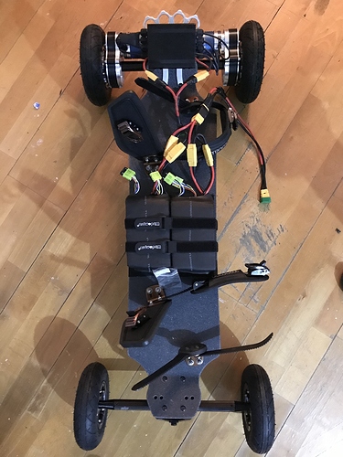

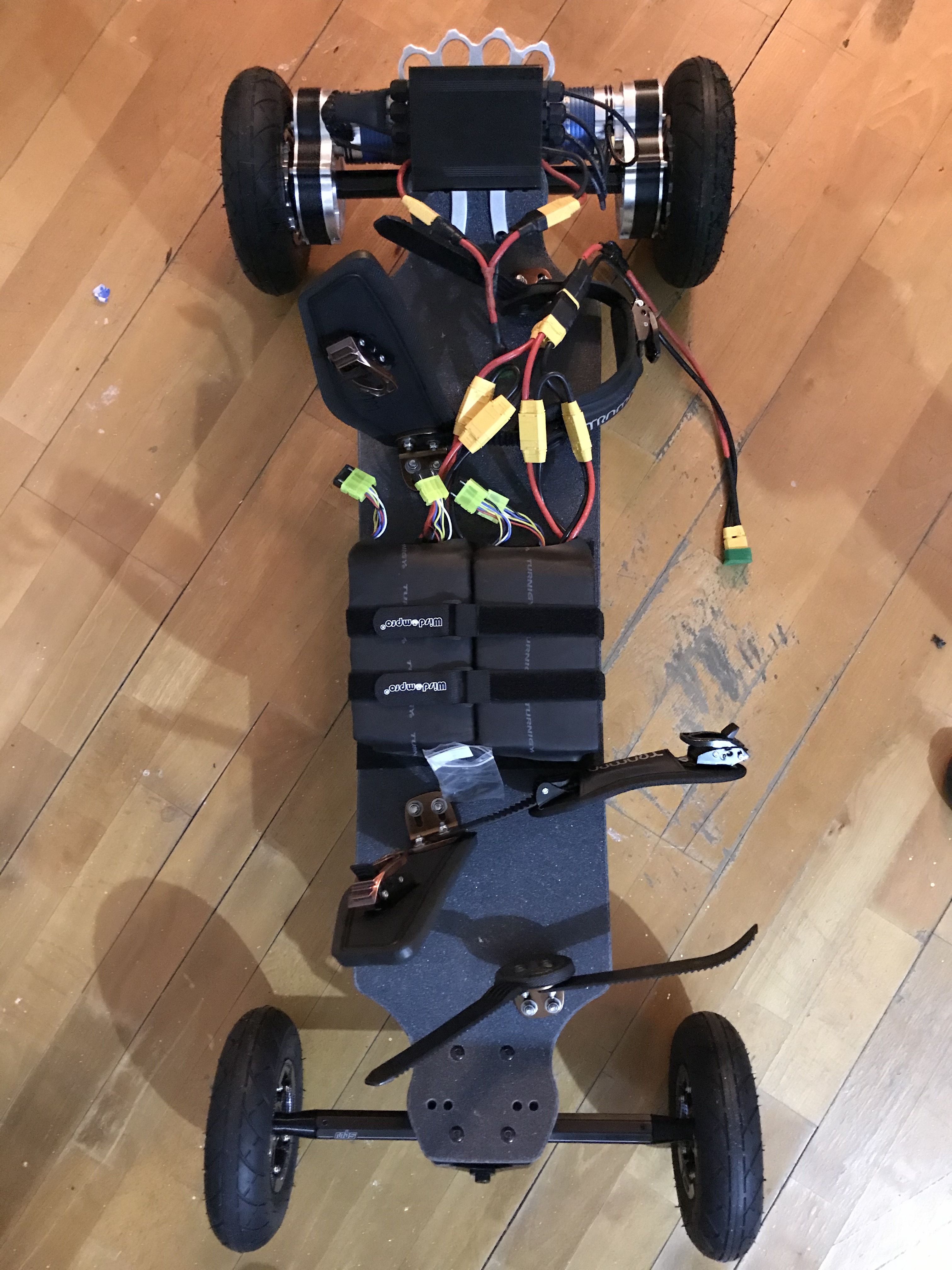

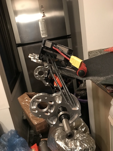

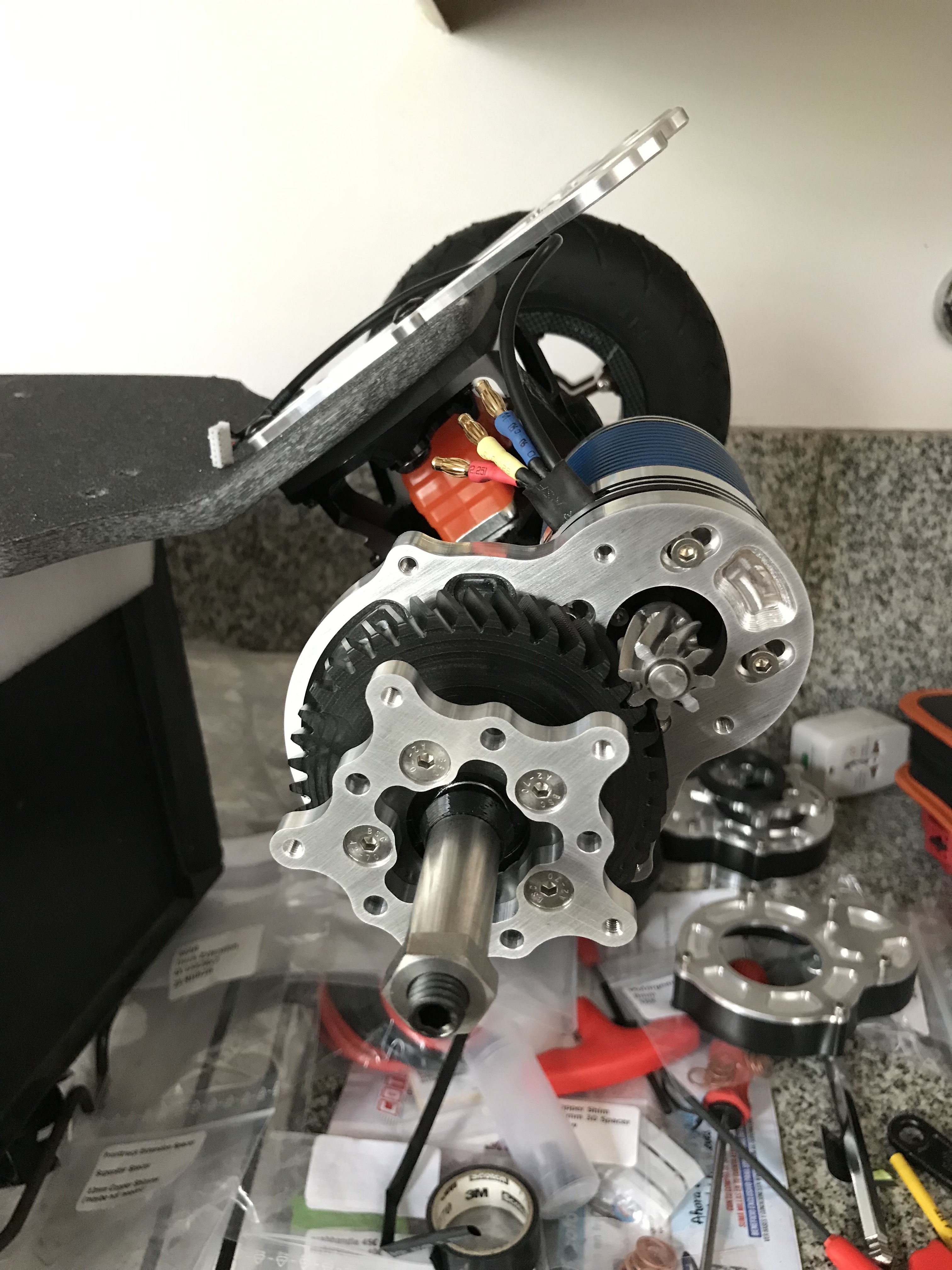

E-Toxx mini Heli 8/40 (5:1) gear…fuck yeah! my farts are much louder, going ninja + beers
E-Toxx truck extension front and rear…
MBS Matrix II Metal Trucks…I liiiike the extreme curving…quality…mmmm…if you drink it is ok
Trampa Superstar Wheels & 200mm Innova Slick Cut…they are fast as fart…love them
Front light OLIGHT mini magnetic wireless charging
From light mount: Old RC Monster Battle aluminum chassis when I was a little kid, with little farts…
E-toxx Grap Handle…SOOO refreshing…people think you can punch them with it…sweet
Reaer light: Chep amazon led light mount using drunk force…fuck it…but it works
Trampa Vesc 6 plus…sandwich style…aluminium case…did a Buch of stuff…do not remember…was drunk…and farting
4 6s 6000mAh Lipos…industrial shirking (be careful with the hot gun, almost die, cause I was drunk)
Battery mounting … Hook n Loop…
Motors SK8 149kv …good reliable motors… motor amps an settings, using suggested new vesc tool set up…
Mini remote with usb rechargeable batteries… 0.10 positive and neg ramping, throttle curve 30 positive acceleration exponential…
No safe start, no traction control, no…no…no…
AAAAHHHHH jus love it…going ninja silence…make pedestrians fart…
