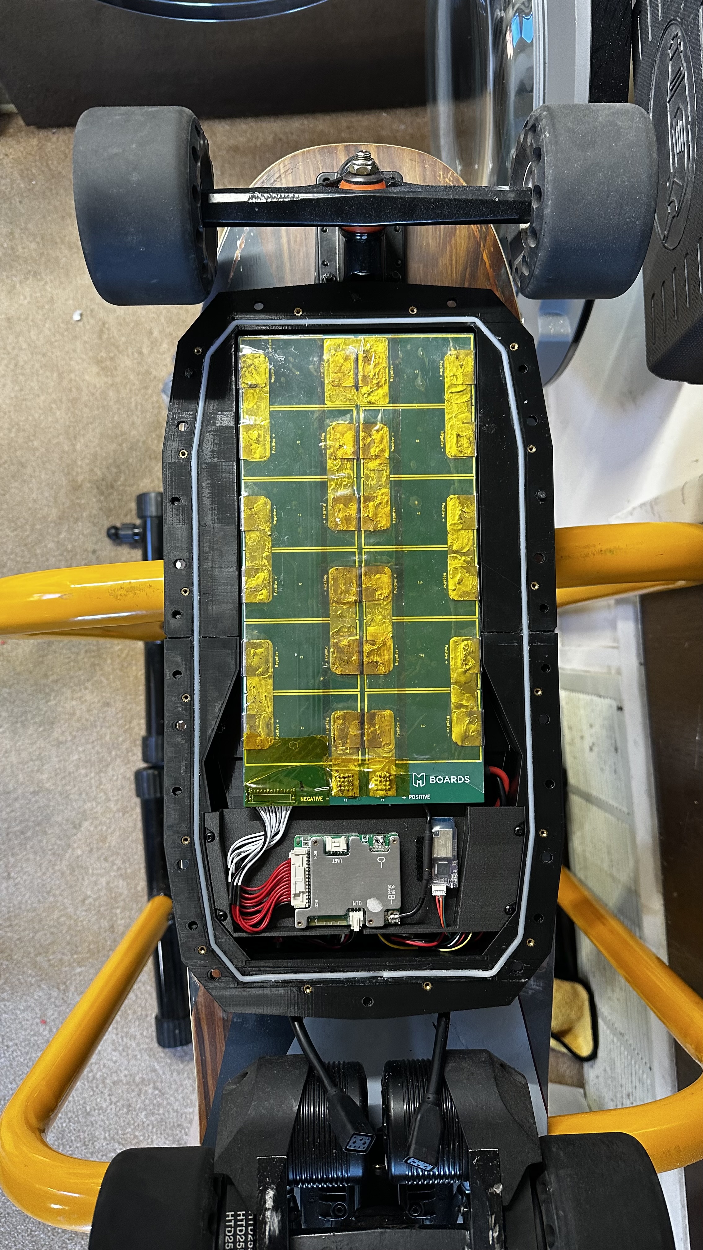

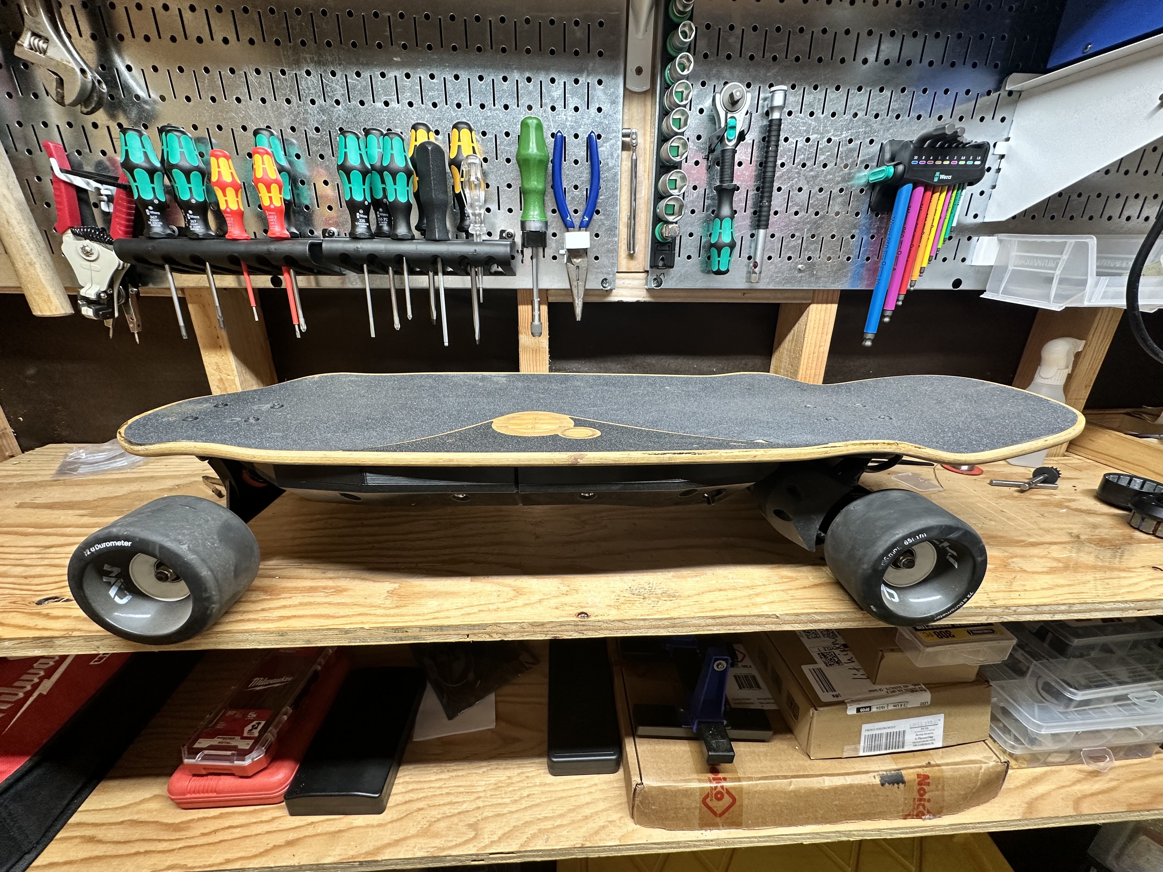

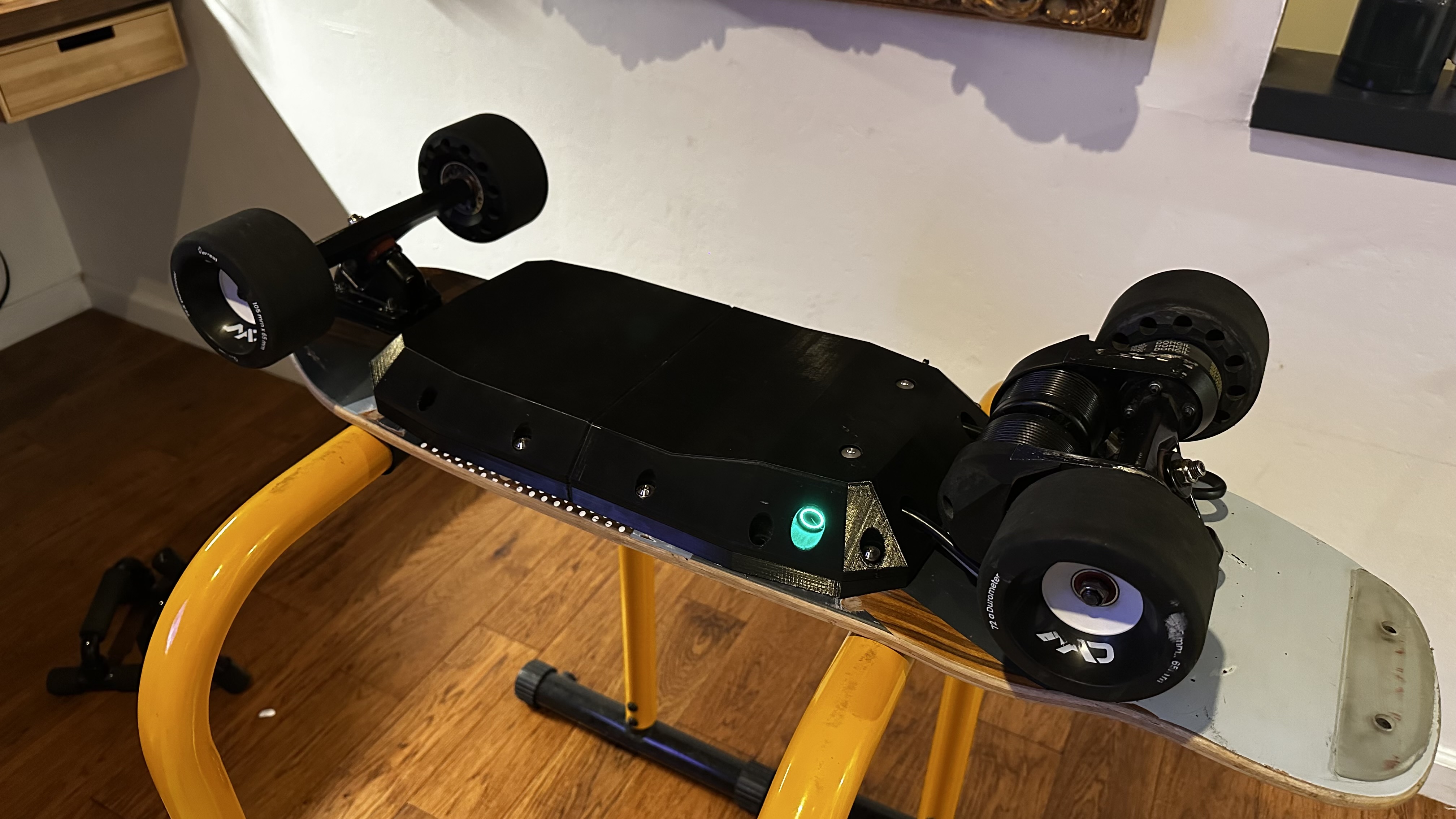

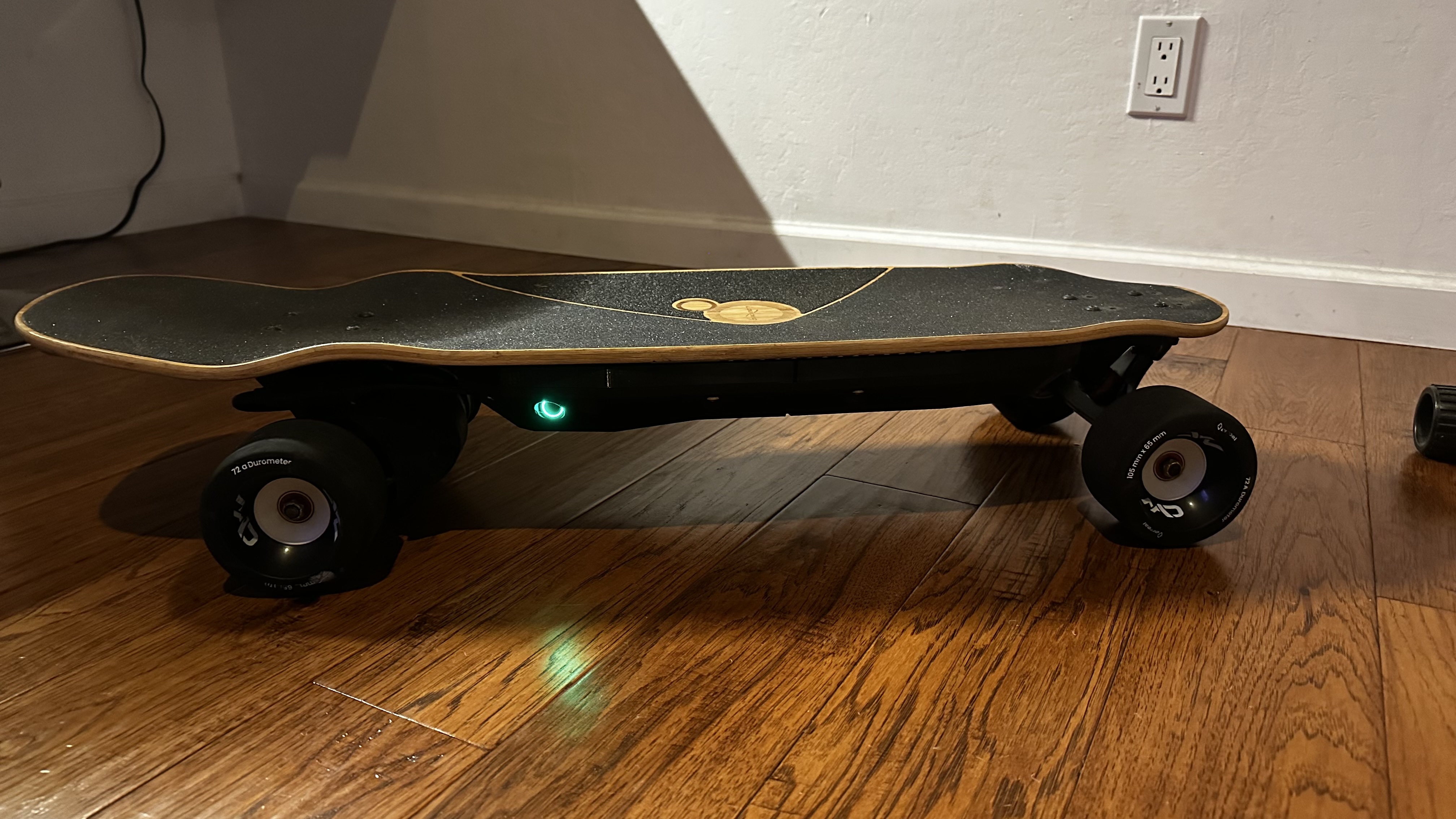

Omakase cruiser build
Thought id share my daily driver.
Its an omakase build featuring inboard motors from a meepo voyager riding on Madwheels 105
Powered by an mboards 12s2p molicel p42a pack balanced by a smart bms and connected to a maker x dv4s all housed in a Custom designed enclosure.
Everything is modular from the motor connectors to the balance harness.

Is the enclosure 3d printed? I don’t suppose the files are public, are they? :smiley:
Ya 3d printed! They are not public but i might sell them down the road
