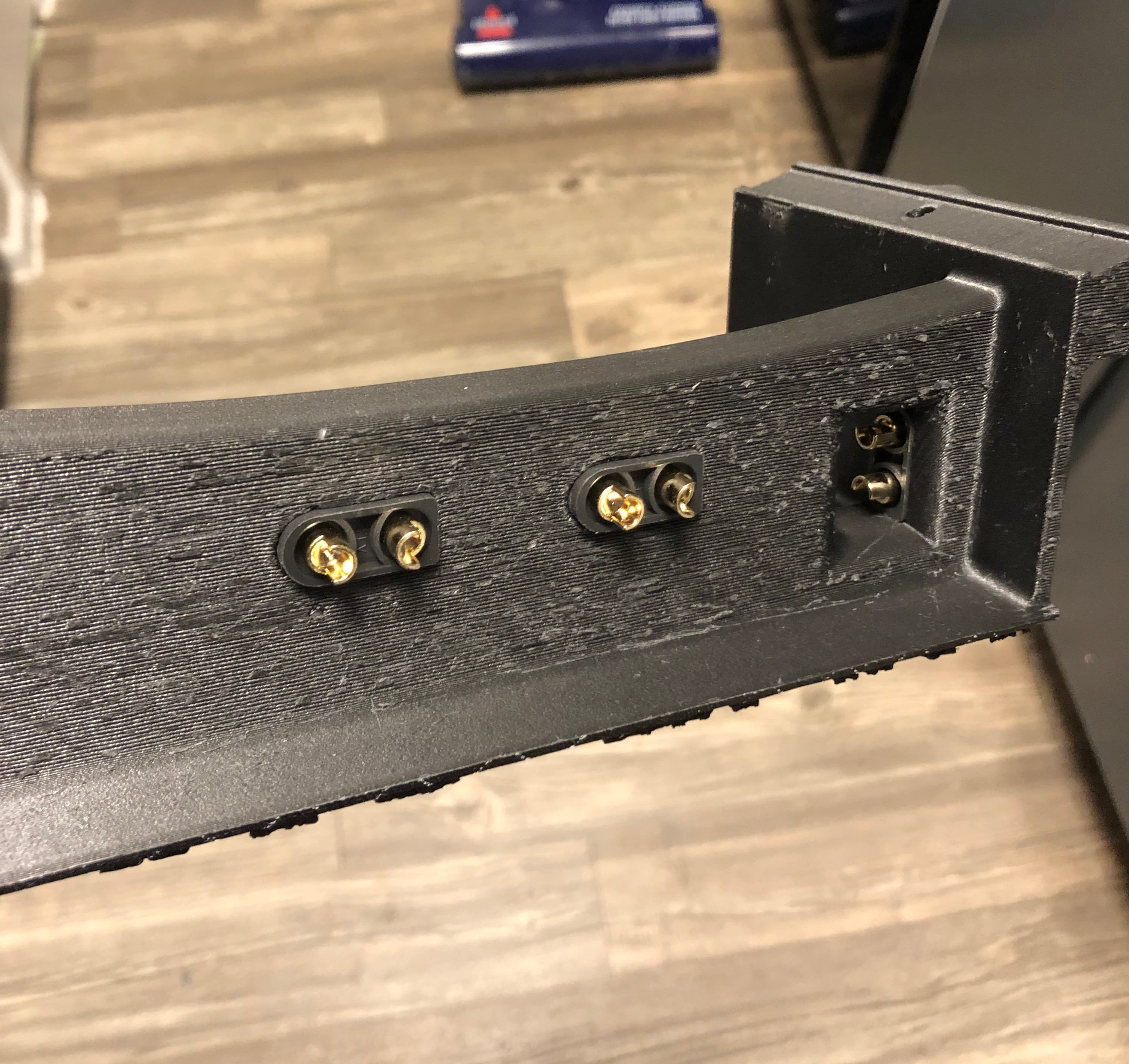

Enter v2.0 of the money pit’s enclosure. Panda colors were chosen this time around. The enclosure is split into 4 unique sections front to back. The rear holding the ESCs, rear-mid with the loopkey and battery wall, front-mid and front pieces contain the batteries. Several iterations of this design were printed and ridden on before the next major failure.
Battery leads :frowning: Due to the aforementioned charging situation, one of my batteries had the positive lead snap off. I couldn’t get the lead to hold solder at any temperature and I don’t have a spot welder so I had to write off these 4 batteries. Everything I read online said not to mix batteries of different health so a new 4 were in order. Found a deal on some 5100mAh Turnigy packs with the same dimensions.
With the board out of service, I once again spent some time redesigning her enclosure and battery situation. This time I thought if the battery cables never move then they can’t break. I’ve always liked the idea of having cold swap-able battery packs for extended rides so I make a battery enclosure (also PETG) that allows me to connect everything with zero modifications to the batteries themselves. (lithium fires scare me)
Everything connects with XT-90s epoxied to the PETG. This way I can charge the batteries without breaking them. Due to the extra space needed for the front face of the battery pack, I moved the battery wall further to the rear. The battery wall now doubles as the female end of my XT-90 connectors allowing me do away with bulky XT-90 series adapters. The curved black wires in the pack are 12 gauge solid core wires from the hardware store. These are awesome and take up way less space than stranded cables.
This worked swimmingly and kept my new batteries intact. The size of the pack and it’s proximity to the front trucks forces me to remove the top half of the enclosure when I need to install it. Completely defeating the plan to have it be quickly swapable. I have to pull over, power the board off, bust out the skate tool to remove 4 nuts and then swap the battery with a half size one I made. The lack of a BMS will be my wallet’s demise however. I got home from a long ride recently and forgot to pull the loopkey out. Wake up the next morning and every battery was drained to near 0v. This killed one of the four and damaged another.
So here I stand with my current battery failure wondering if I’m wasting my time not investing in a custom 18650 pack. My hesitation is I would likely have to scrap my entire design. Am I overthinking the danger of making my own custom 18650 pack? Does spending another ~$180 on some Turnigy hobby grade batteries make sense? Any suggestions on bolt/nut alternatives that would make removing the top of the enclosure quicker?

Last but not least, the new enclosure is ~75% complete. I started almost completely over with the design in Fusion360. Only borrowing a few measurements from the last enclosure. I made a hard shift aesthetically from chamfers to fillets, and went all black with a carbon fiber filled PETG filament. I’m not entirely sure if this is due to the geometry changes or the added CF but these prints feel strong as hell and have very little flex. Bonus that the CF texture hides the layer lines fairly well.
The major changes are:
  • D-nuts embedded into the enclosure
  • top two parts combined into one
  • replaced epoxied in place XT-90 connectors with XT-90E-M secured with heat-set inserts
  • added recess in lip for gasket material
  • dedicated motor wire cutouts & printed TPU guards
  • relocated VESCs & printed custom TPU guards/vibration dampeners
  • replaced bottom design. Triangles > abstract lines
The embedded d-nuts are my favorite change so far. They make installation and removal so so so much easier. I’m pretty sure they are intended for wood but that’s nothing my soldering iron can’t fix. Couple seconds with the iron, couple turns with a hex key, and repeated until flush. Can’t complain!
When I found out panel mount XT-90 connectors existed, I clicked purchase like my life depended on it. Uploaded a model into Fusion and cut a negative into the firewall to get the fitment right. I think they looks fantastic.
