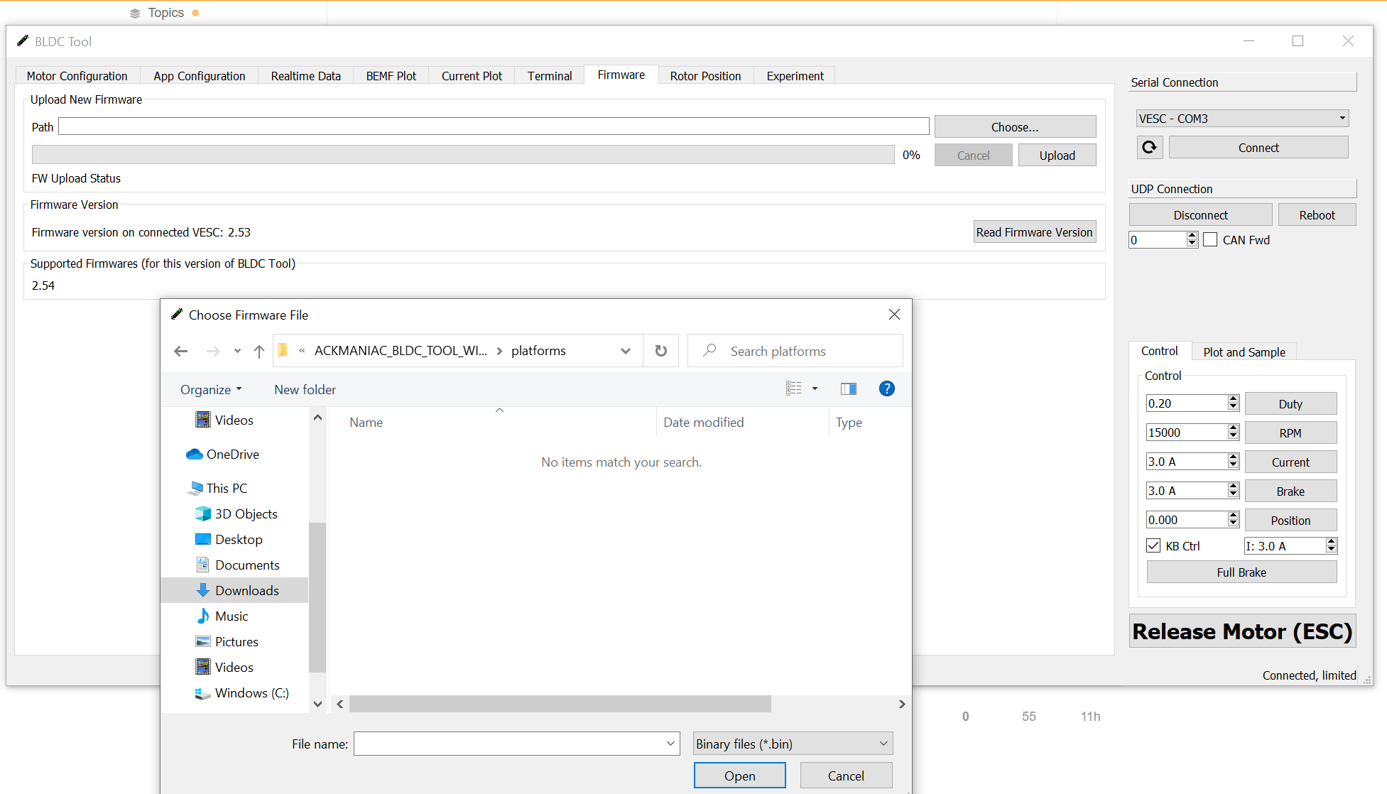

I was able to try and connect and One vesc connected but it told me the firmware was too old and it was in limited connection mode. I browsed in the different menus and didnt see any useful info or connection. I then disconnected the cable and when i went to connect again the computer doesnt recognize it at all. i tried two computers no luck. What should i do to get the usb to read again and how do i go about updating firmware? Im running Vesc 6.05.exe
ok i got past the usb connection issue and this is the firmware info it shows. Still need guidance on how to move on from here.
