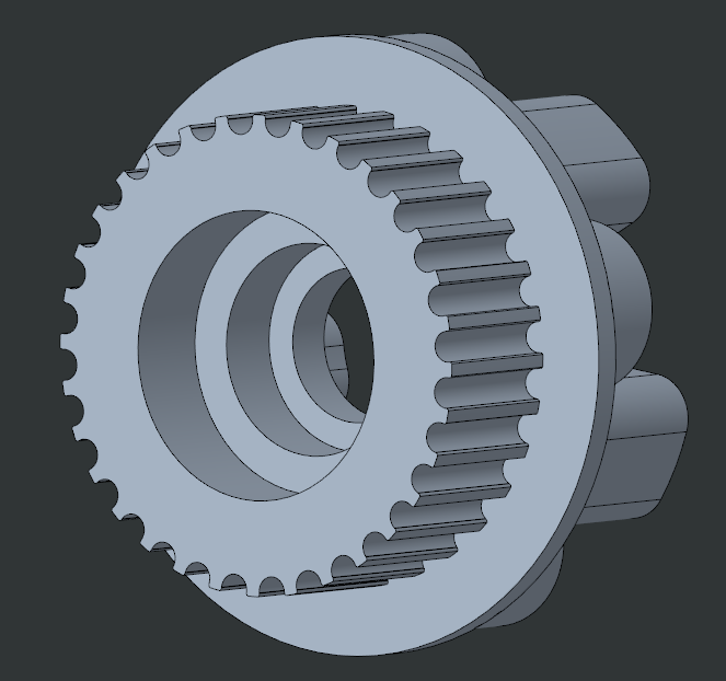

Kinda stopped working on the project bec I couldn’t get the gear teeth right. I’ll post the schematics of the OG Hoyt 5s and can post what I have as a STEP file and Solidworks file. I had just figured out how to make them work with the stock pulleys and kinda abandoned the project.

not entirely sure if they fit becuase I couldn’t get it completely sorted out before I figured out how to make them work with the stock pulleys, but its pretty close and should be a good starting point.

Getting closer. Already a nice fit on the Hoyt 5" but still some tweeking before they fit my DKPs.
After that I will do some different numbers of teeth. This is 32T for no reason. Will more likely need something ~40T.
I bought PAHT-CF and PA6-CF filament for the pulleys. There is no perfect orientation in FDM printing for this part… maybe order SLS parts in PA12?
I think I start by just trying this prototyps in PETG and see how long they last. I think the smaller the radius (fewer teeth), the less long the parts will last.

I did drive the finished version of my pulleys for a few hundred km.
They work, but they make an annoying rattling noise. The PAHT I used to print those wont stop warping. So the fitment was never good.
I designed some pulleys for MBS Rockstars II in the meantime which I printed in PPA-CF. The PPA-CF is waaay less warping so the fitment was great - but the rattling didnt get away.On the stepped axis I use I will never get rid of the play.
The MBS are mounted without a bearing and are directly screwed in with the bolts that keep the two halfs together.
Having used this design I came to the conclusion that my Hoyts need the same principle to get rid of the rattling.
I just wanted to start the design this week.
