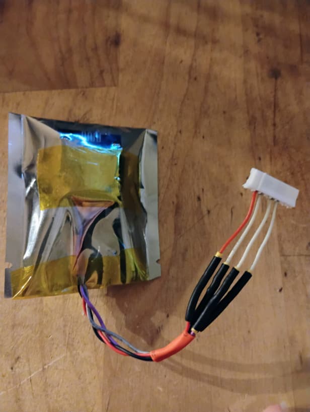

Tested working on the bench:
You can operate it in the Kapton renforced anti-static bag:
Connect as follows:
