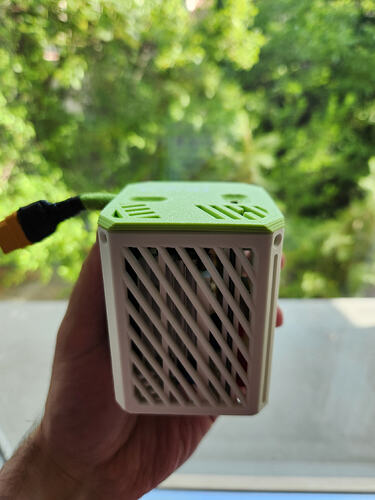

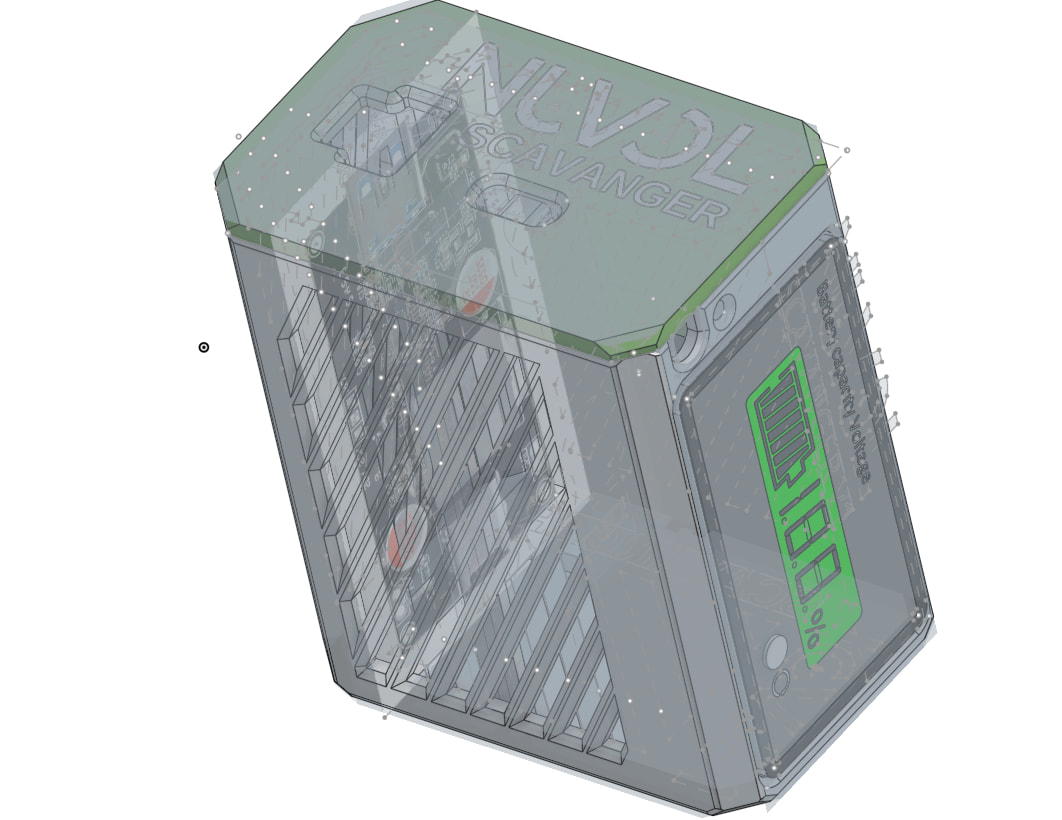

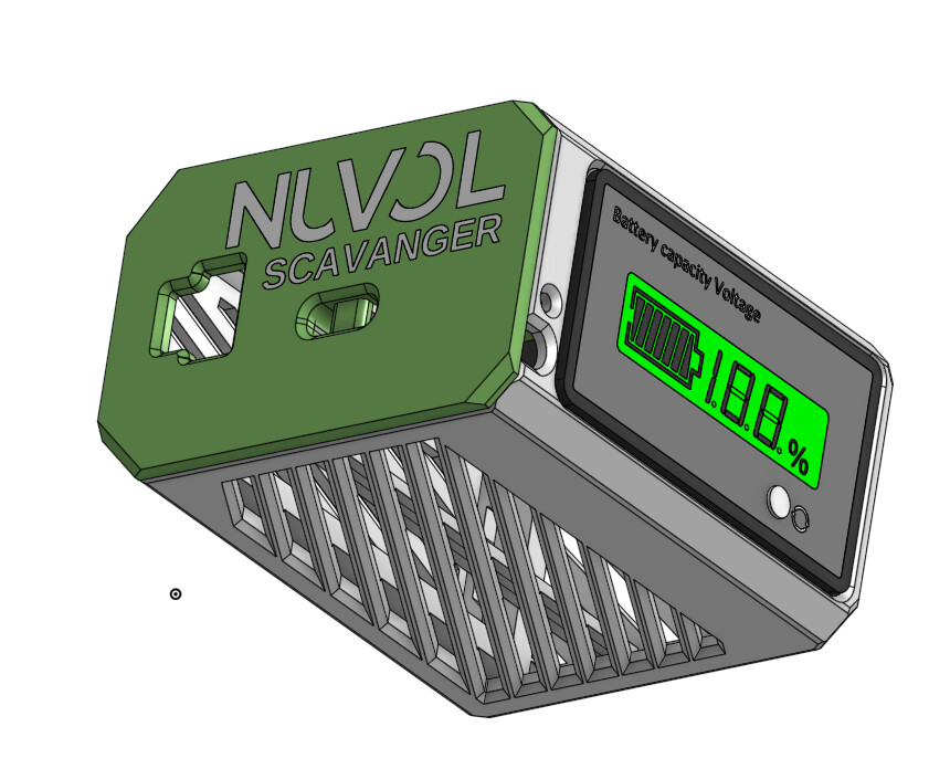

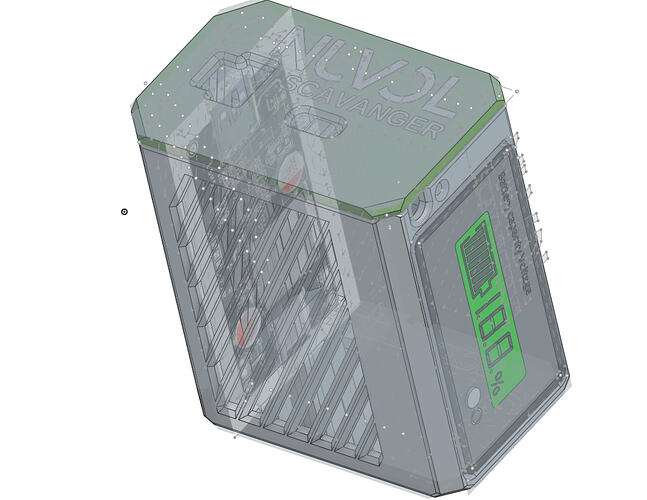

Just wanted some feedback on a device we’ve been working on.

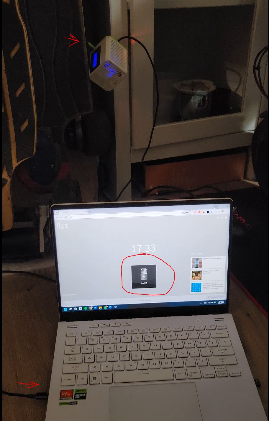

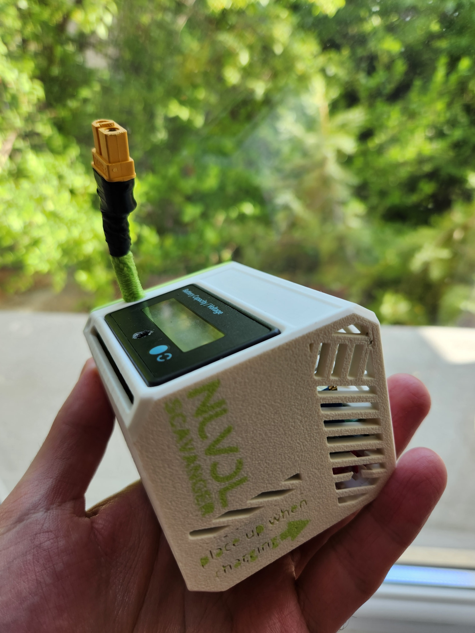

The device connects via XT60 to your board’s battery and allows you to charge any device in the 6–100W range (it automatically detects the power the device draws).
It accepts an input of 6–55V (up to 15S) and outputs 5V, 9V, 12V, 15V, or 20V at a maximum of 5A (100W). You can charge a MacBook/laptop via PD or super-fast charge your phone.

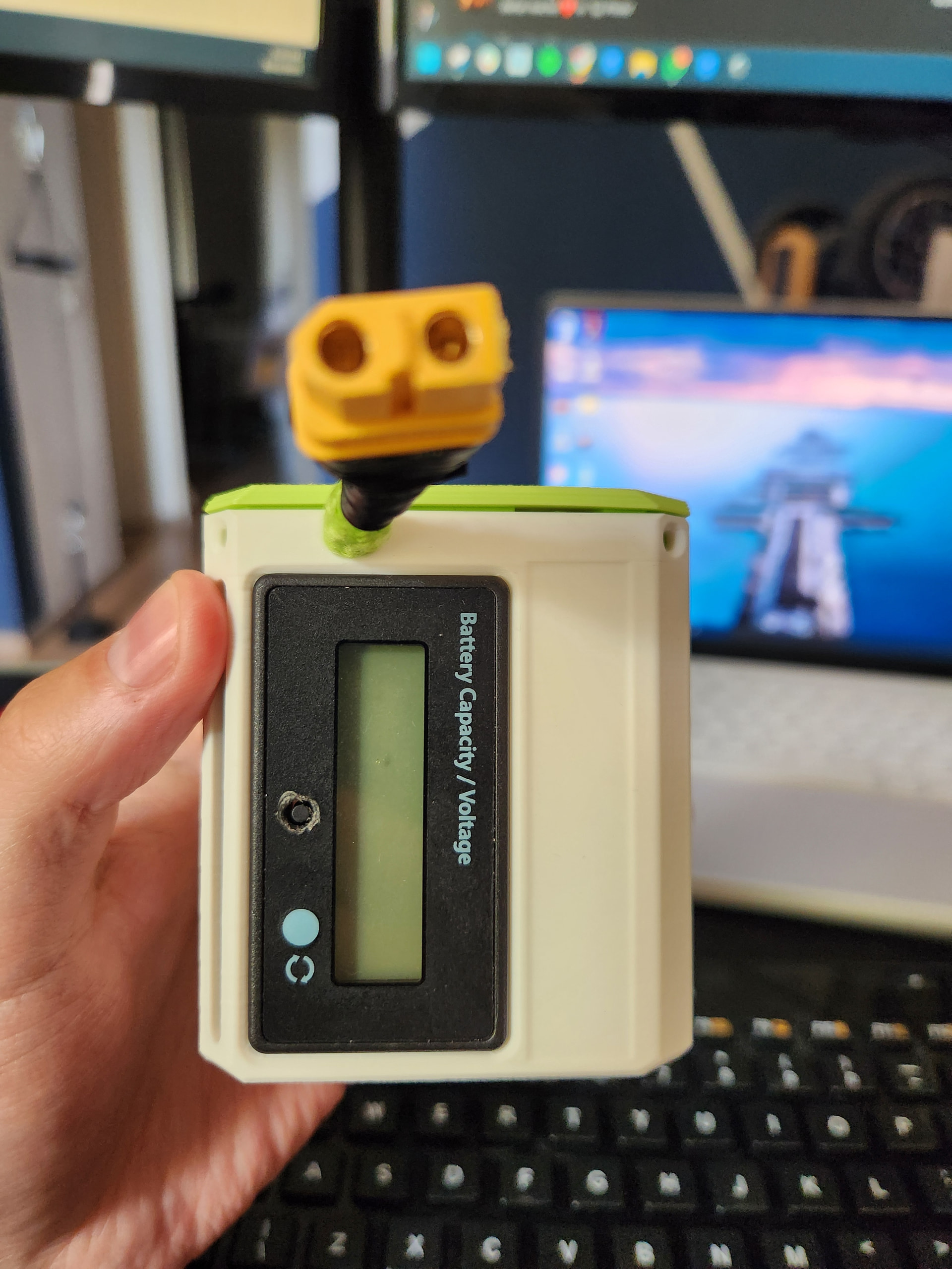

It has a display that can be configured to your battery’s type and S count, showing the actual voltage in your battery (as % or V). However, it will not prevent your battery from dropping below the minimum cutoff voltage if you don’t have a BMS.
Another limitation is the charging ports of commercial boards are not “live“, so for this to work with a commercial board, modifications need to be made.

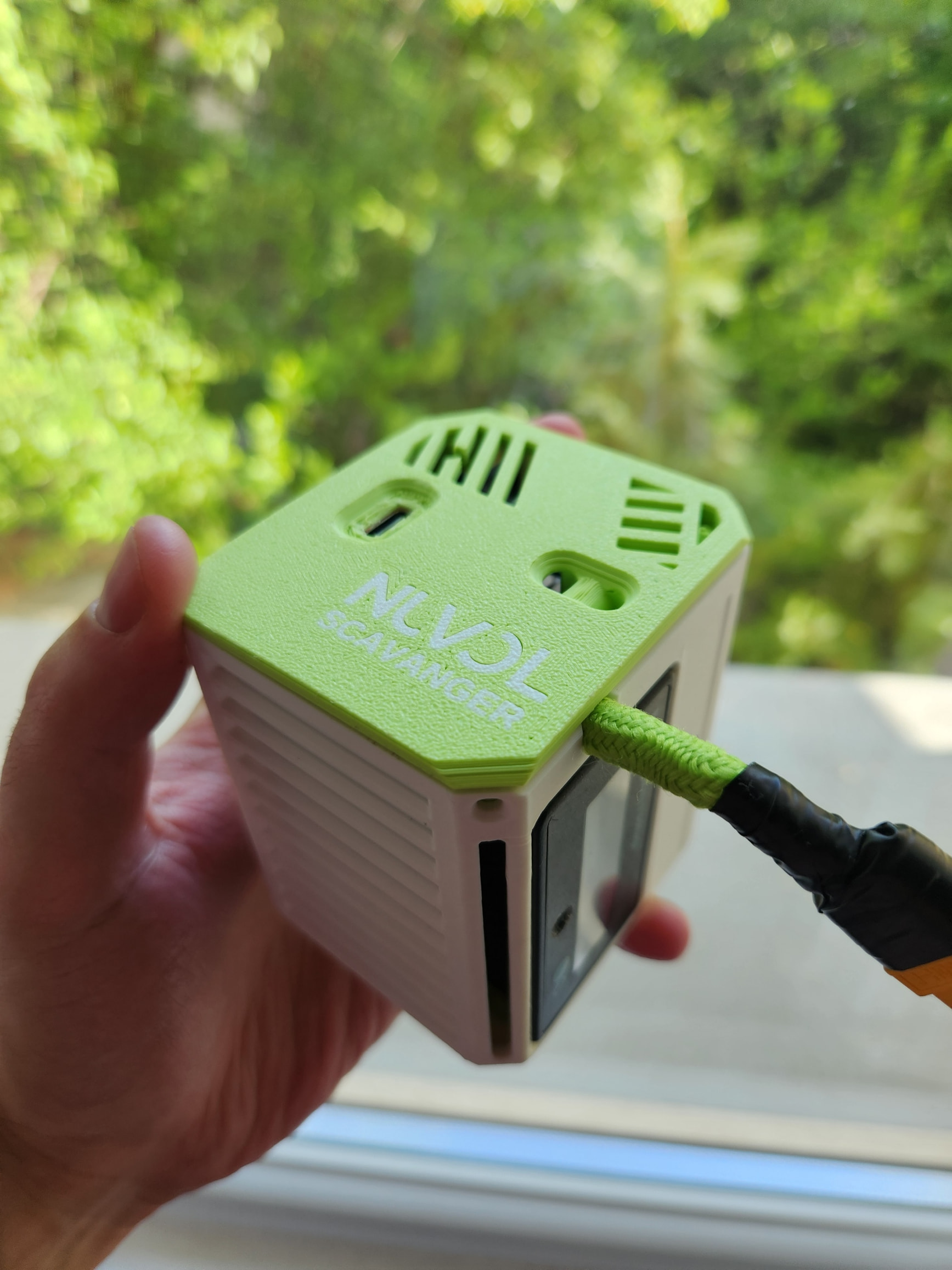

Features:

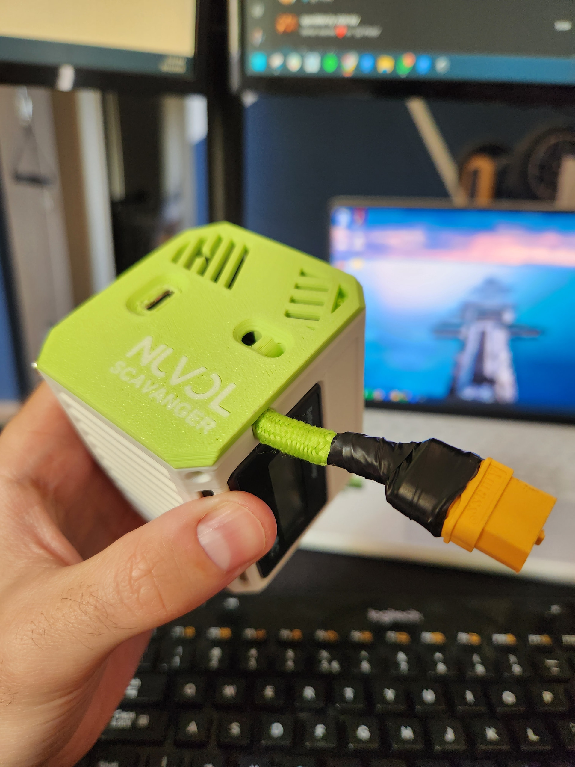

anti-cable pull system which can also be used to extend the cable length if needed (there’s about extra 10cm of cable inside the device)
pasive cooling tested for up to 100W (components are actually capable of higher output power but are intentionally understressed)
