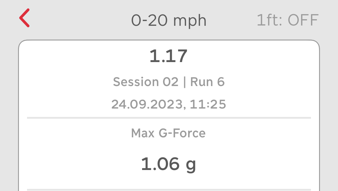

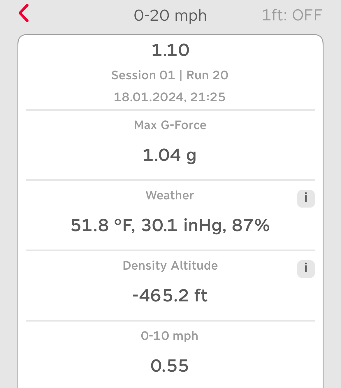

Are you hitting 1/2 g?
Bindings and grippy wheels easily lift front wheels :man_shrugging:
Looking at people go for max acceleration I see them leaning forward enough to keep the nose down. Assuming you’re leaning as far forward as possible, you’d maybe almost end up horizontal and I think the wheels will spin out before the nose would come up.

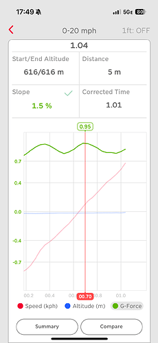

i’m hitting .95
Exactly. So if you keep your body weight back to keep traction, the water bottle forward would assist with keeping the nose down.
@poastoast whats the limitation? You can’t get enough mass forward and the nose comes up or the driving wheel slips? Or u need more torque to know?
With my 9x3.5 slicks, no matter how much I lean forward, I just cannot loose grip on the rear end. I am at 0.7G RWD right now but there is still room for improvement. For that I need more torque though
However, if I don’t lean forward enough because for example I accelerate out of a corner and I only focus on the line, then the front can definitely come up. I had it happen a handful of times on the track

I barely beat your Gs :smiley:
i was 2% more Gs and you were 6% faster.
no trouble with wheels up.
no trouble with grip.
i wasn’t at max lean.
also was on 2wd. those on 4wd keep front down to get full acceleration.
yes, lean too far foward and you’ll get rear slip, lean too far back and you’ll get a wheelie.
but i suspect none of our boards have so much thrust that there’s not a balance point in between still.
Ie none of us need an extra cantelevered water bottle yet.
and no, no one noticed that effect, because no one is anywhere near where it is an effect.
