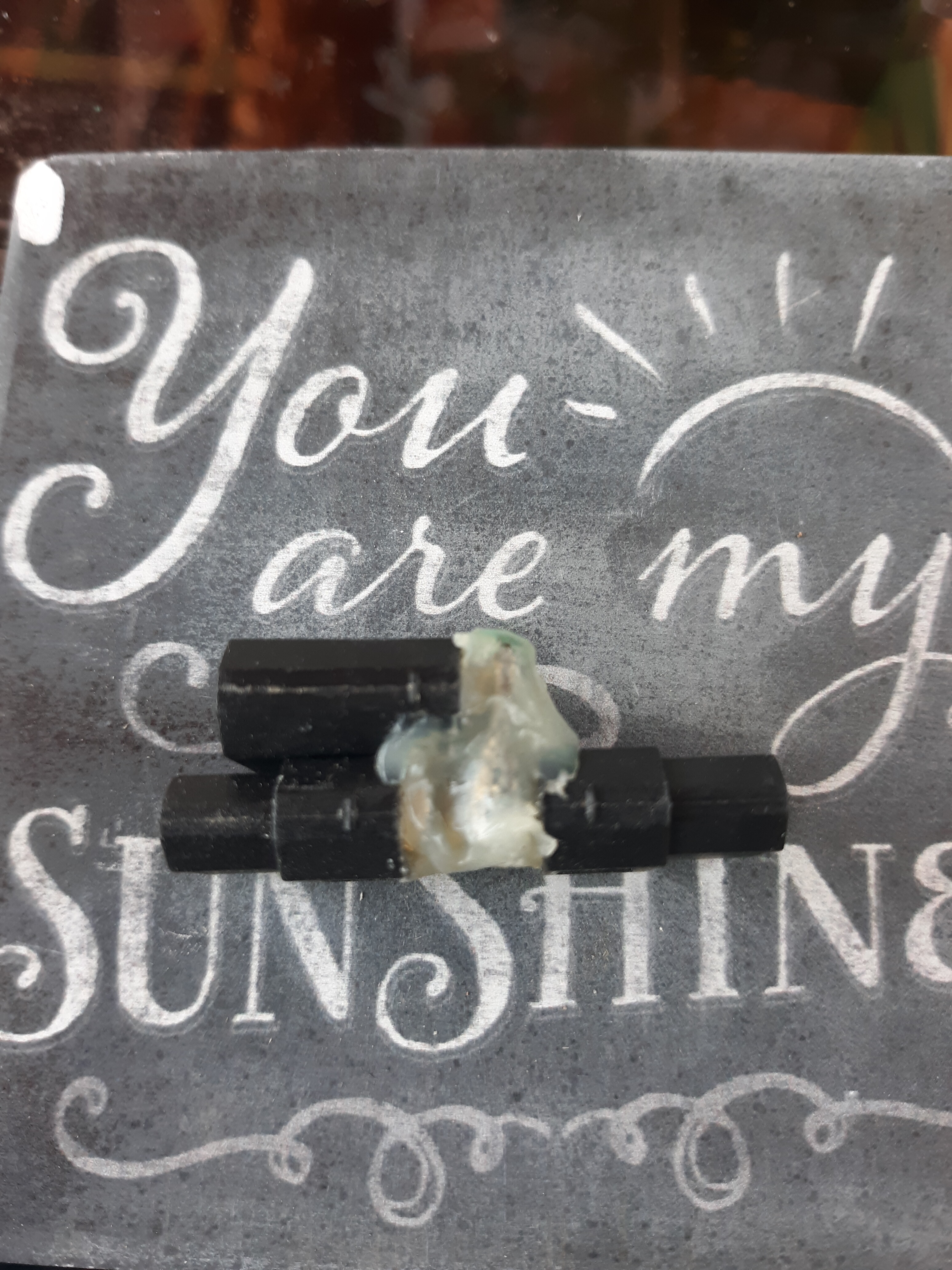

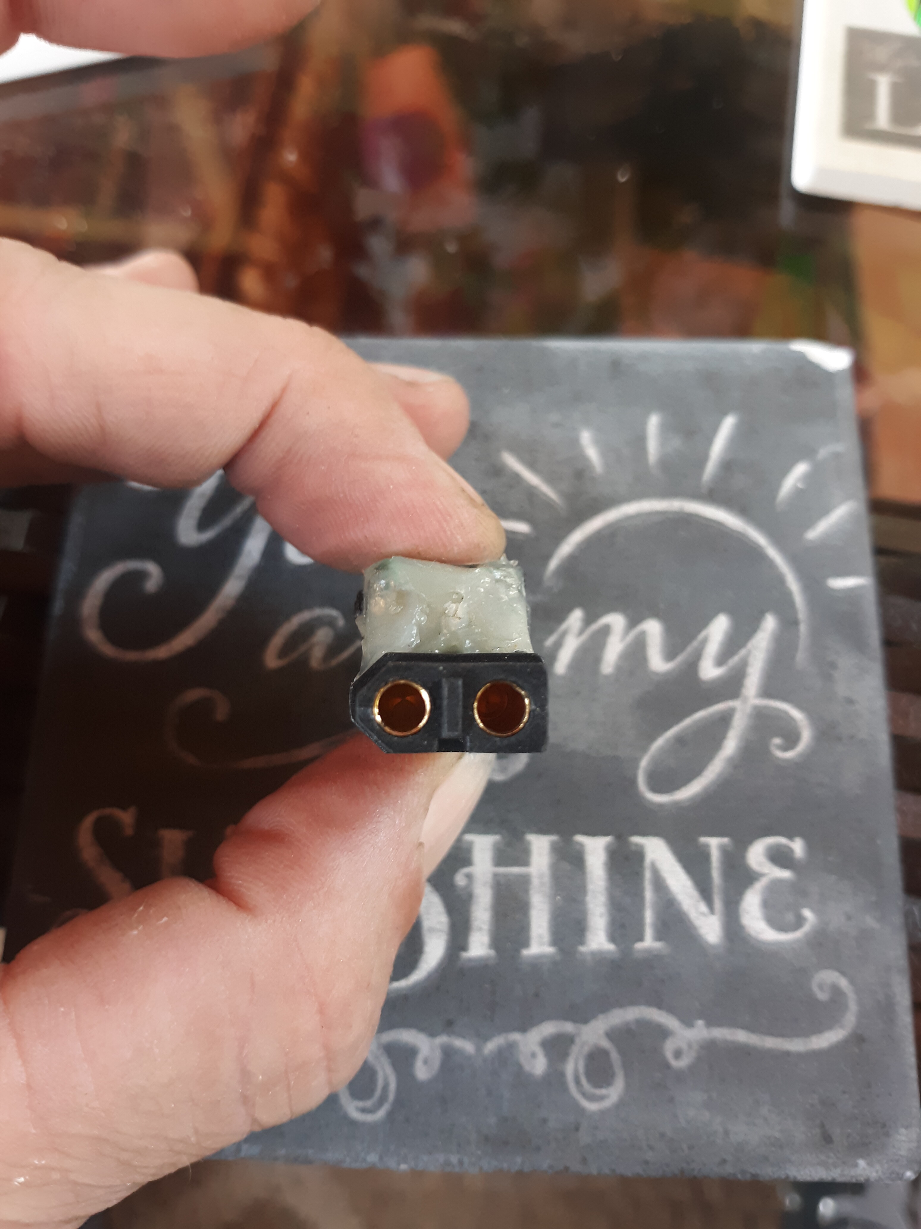

Me personally I’ve had no issues with using hot on it instead of heat shrink. It’s on a 10s that sees 60-70a bursts if I’m riding it (girlfriend’s board). Its also sealed so nothing can get to it. Glue has yet to fail. But you do you lol.

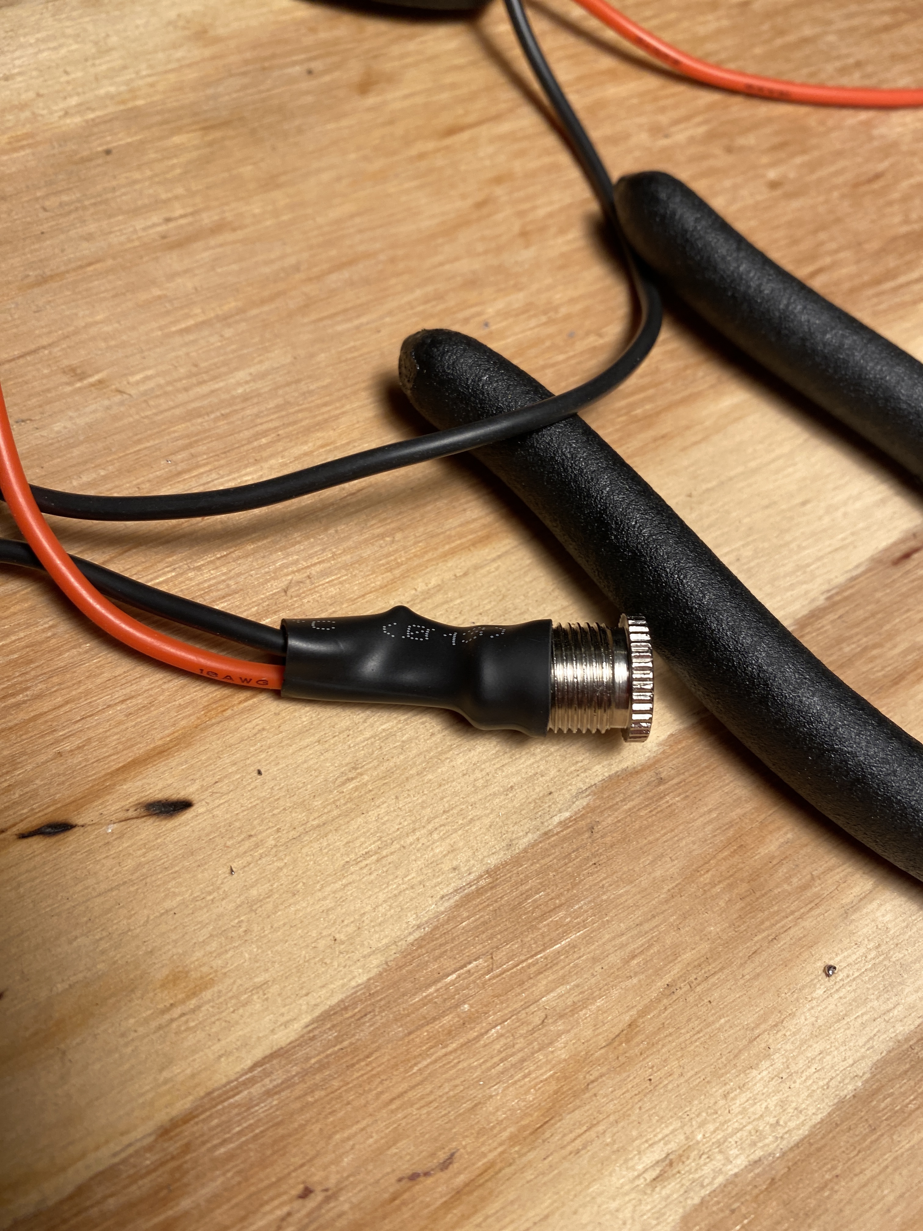

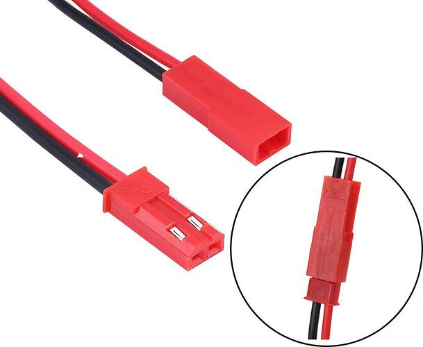

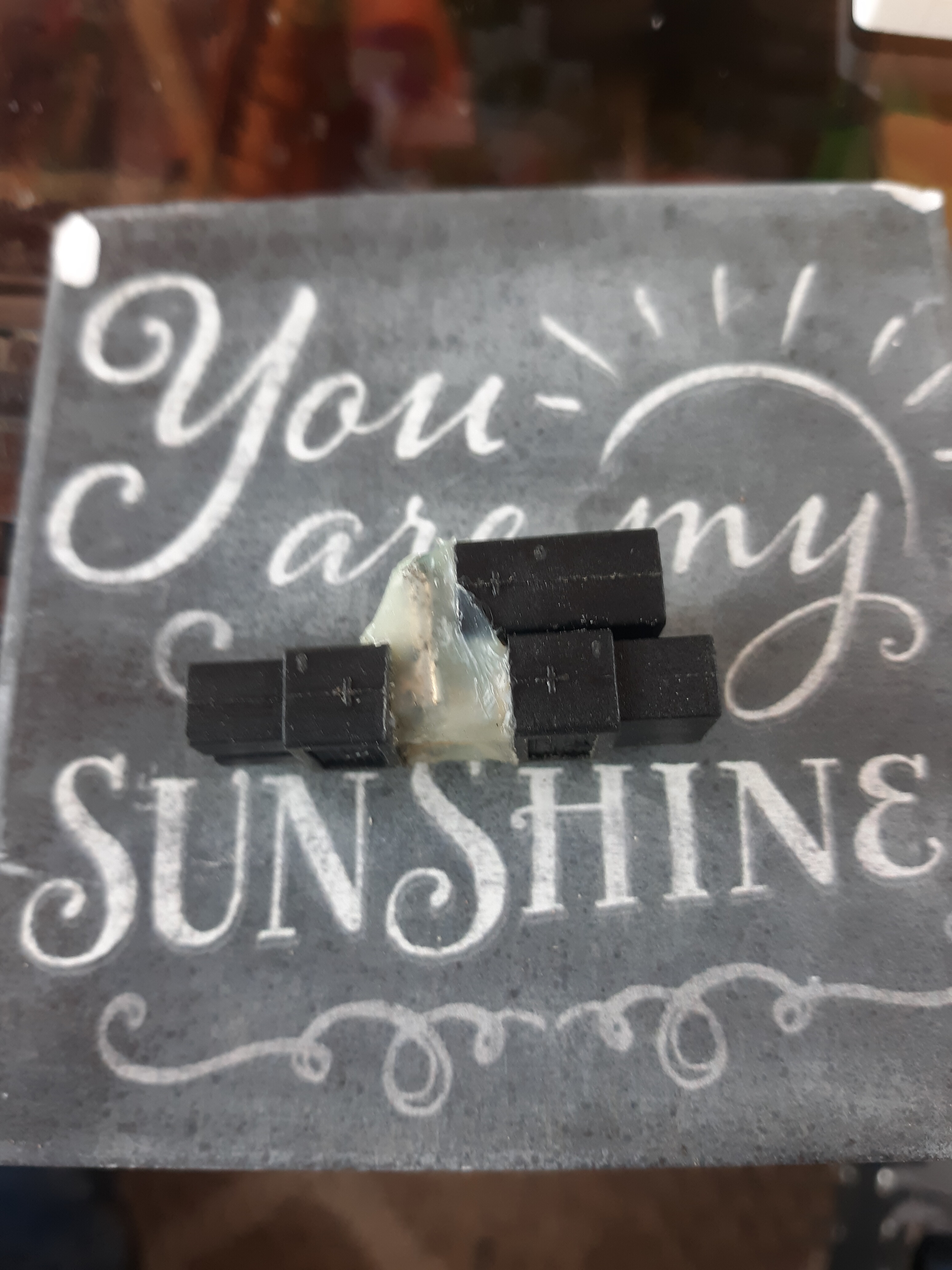

Got a question to ask. As I’m typing this I’m working on my last part to solder. I gotten the charge port done just need to solder it to the C- for the negative, fuse the positive to the main positive harness. Thing is my charge port comes with a nut and cover to protect it from the outside, I’ll need to add it onto my enclosure but I’m wondering if I can use bullet connectors to connect the negative wires together also positive so i can remove it anytime I want
Charge port

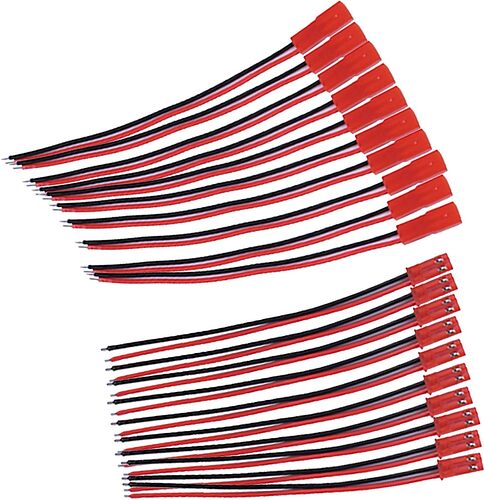

Xt30 is your solution
You certainly can. I’d use a smaller connection like this though
Work great too
Would XT-90’s work? Kinda limited on my choices since budget
Entirely too big but would work nonetheless
Sure you can but wouldn’t recommend for this use.
Keep the size in mind
I also got a bunch of bullet connectors as well and small 18 awg wires would fit perfectly
PM your addy and I’ll send you some of the one I linked.
Yea I figured the size that’s why I came up with bullet connectors since I got a whole bag of them
