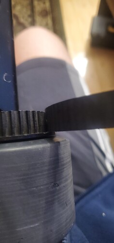

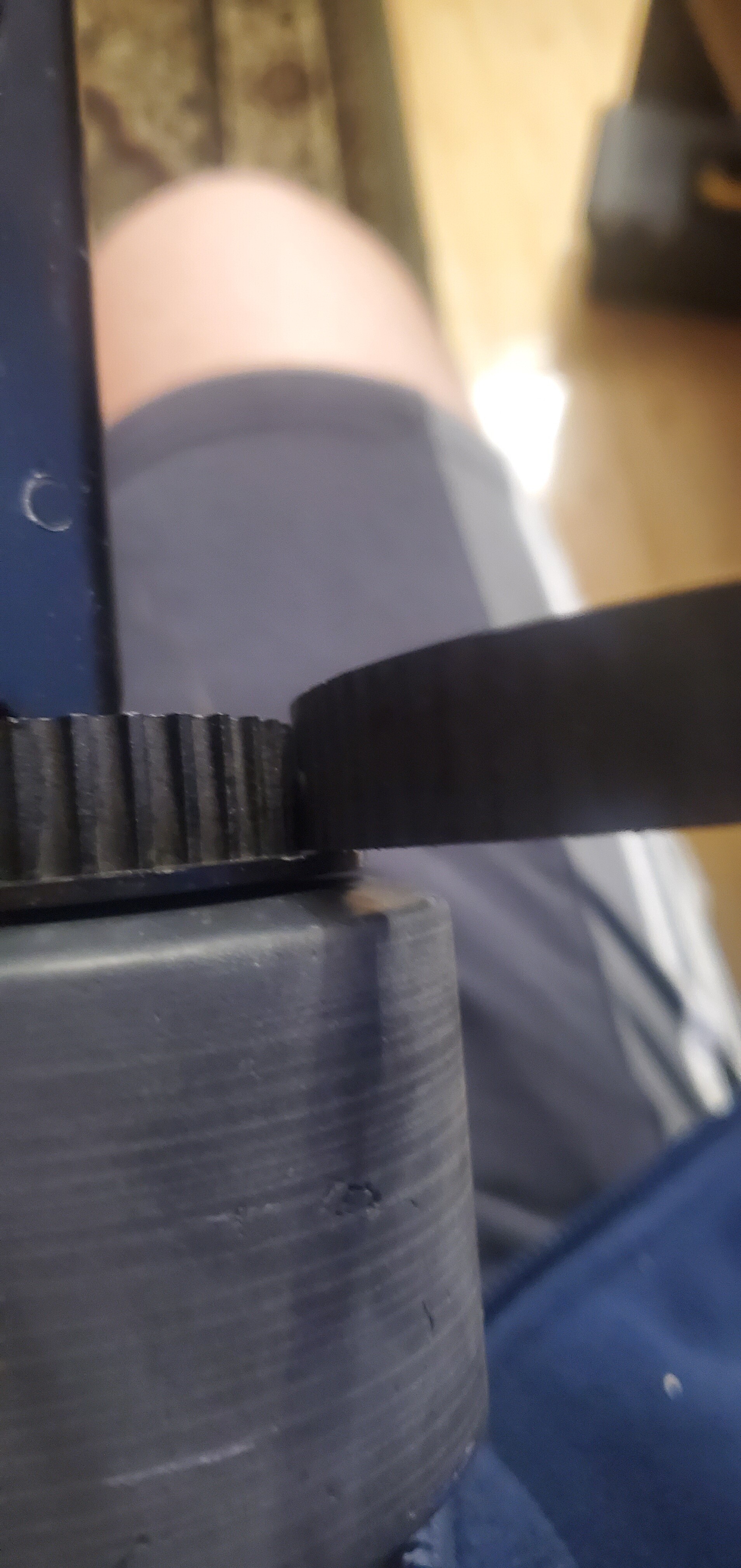

It’s not optimal, but it will work.
If you start experiencing belt slippage then I would then go buy a proper width belt. You can try it and see :ok_hand:

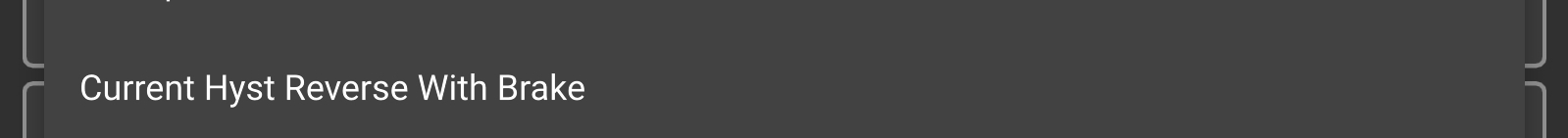

what should hoyt puck be configured as? current no reverse with brake? if so how do i use the reverse feature on it as that just means i need to push the other way to use the throttle. i want reverse like a vx1 or vx2
Current hyst with reverse. Something like that. It gives the options to brake and reverse after braking.
cheers didnt see it when setting up but will look again
It should look like this:

Is that a 5mm belt? Looks like it. You’re best getting a 3mm one for that.
