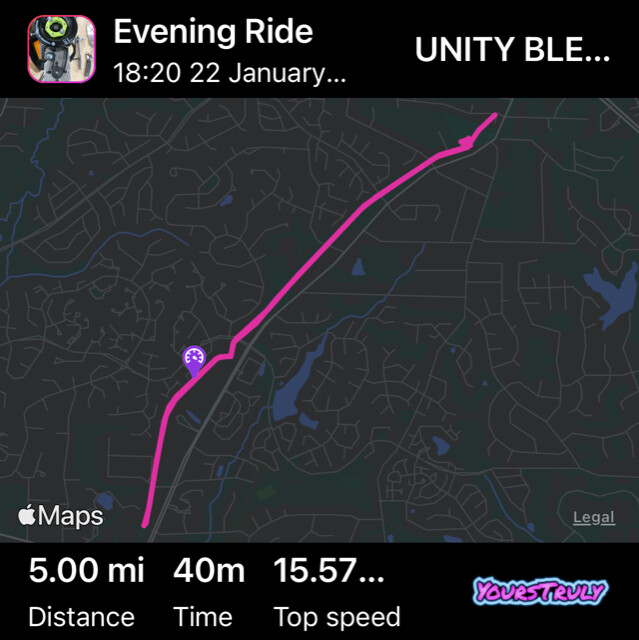

Alright so I set up HFI and took an initial test ride and am pleasently surprised. Everything felt pretty good.
I’ll have to see how it goes when the motors heat up. Temp is cold here now so my motors should be pretty happy.

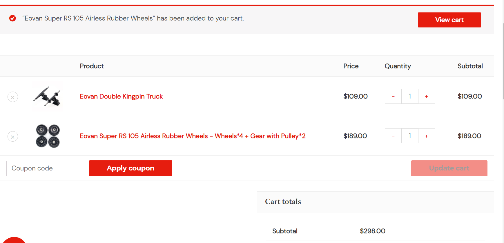

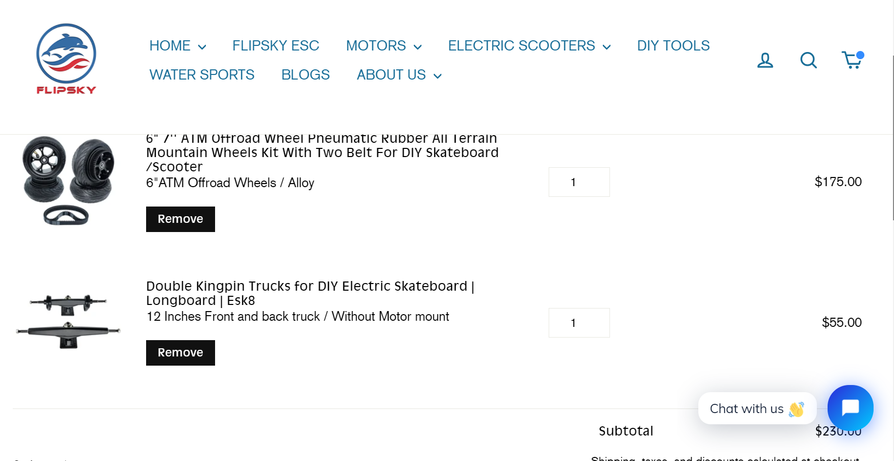

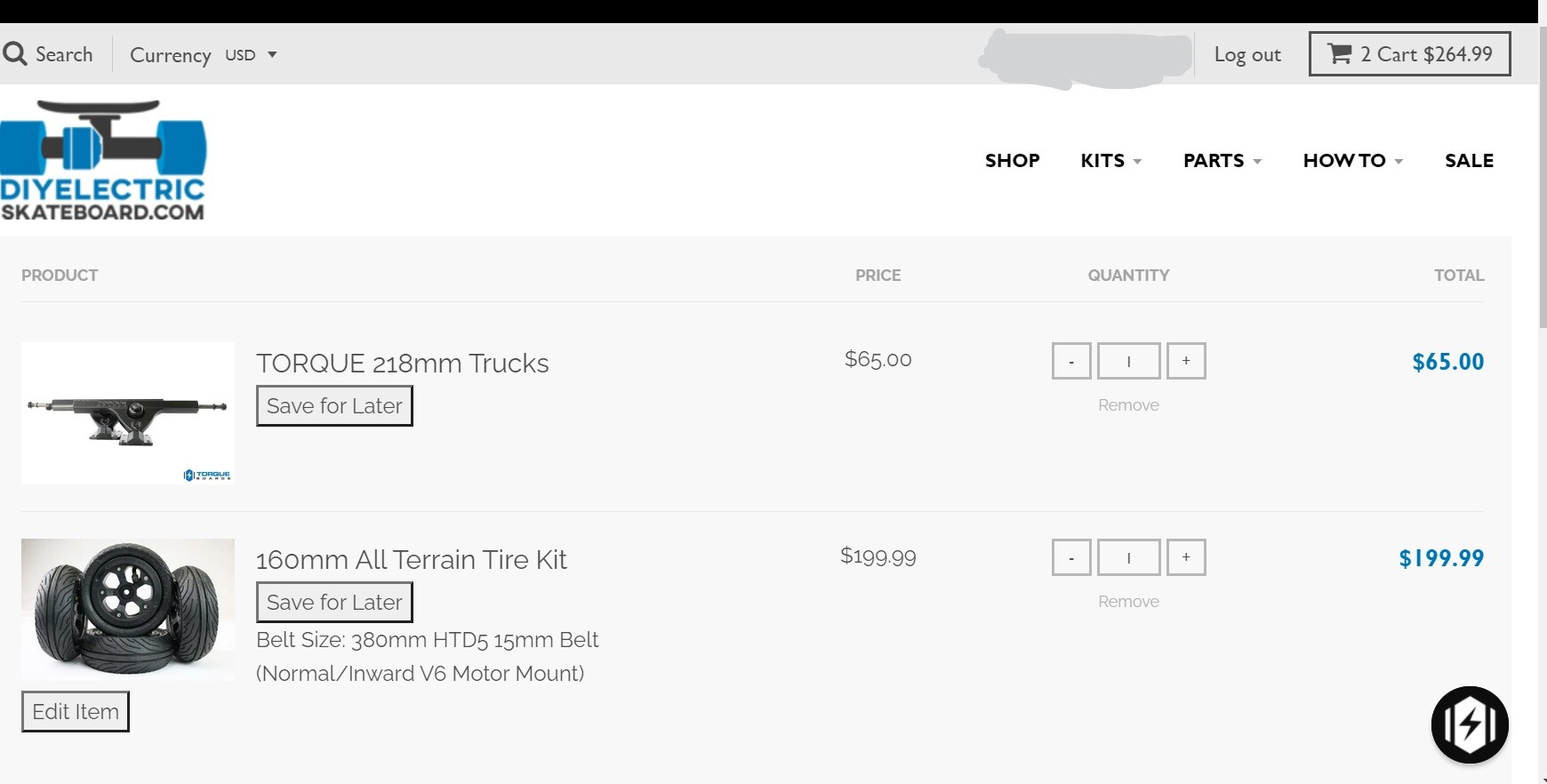

I built a Frankenstein Board, love it, been riding around the trails need wider trucks and bigger wheels, some advice and opinions please go nuts
I have been looking at these three
