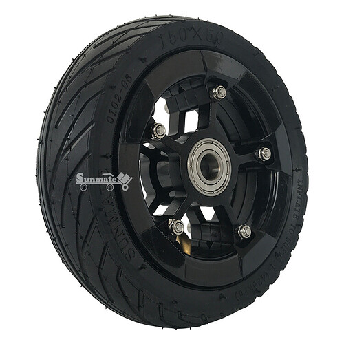

Looking to buy these wheels
Was wondering if this wheels require balancing?
@domas A Stormcore 100D is rated to do that at 20S
Any wheels will benefit from balancing, because none of them are perfect.
The real question is, what level of imbalance are you prepared to tolerate?
Hehe, good question… I guess we will see. Any experience of how unbalanced can this untrampa wheels can be?
Not sure why your response makes me think about this.
A smooth, quiet ride.
most of the out of balance comes from the tires rather than the hub. and it’s just luck of the draw / install how much it matters.

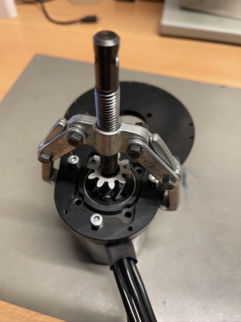

Do I need a key way for gear drives
If I loctite the pulley using 243 loctite then will it be ok without?
@b264 any insights
You will need a key (the 3x3x?mm thing)
You will need to loctite the motor pulley.
Loctite 2700 or 648 is recommended by 3DServisas
Ah k thanks
Ordered some keys but not here yet
Thanks
Anyway to do a diy key
Yes, you need two keyways and one key.
Absolutely not.
Yes, find a 3mm drill bit and snap off a small piece from the round end using safety glasses and pliers.
I love my Dremel
And can I leave it round or should I smooth out 1 side
To clarify on this, some folks have reported success using only Loctite but I wouldn’t recommend it, others would. However, either way you can’t use Loctite 243 for that anyway, it’s the wrong formula.
I would not do that anyway as you’re unlikely to get it right on the first try and removing it once it’s Loctited is going to be a Herculean Task for you.
You must leave it round otherwise it won’t be the full 3mm, which you need.
