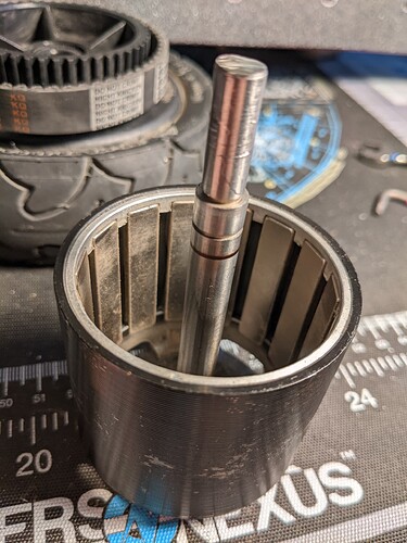

Took apart my motors because I was worried that I got some metal shavings in them and one can was wayyyy more difficult to get off than the other. Tested and the good one can can slide easily on and off both sets of bearings, the other gets stuck as soon as it comes in contact. Have to push really hard to get it on, and had to use a puller to get it off in the first place. Is there any way to fix this or am I just gonna have to deal? Noticed that the shaft also has some discoloration compared to the other.
Good:
Bad:

Like Brian said, just sand/polish the shaft until it fits. Fine grit sandpaper (400 grit and higher) is all that’s needed, you don’t want to rough up the surface any more than necessary, and the amount of material that has to come off is very small - generally a few tenths of a thousandth of an inch - 0.0001" or so.
