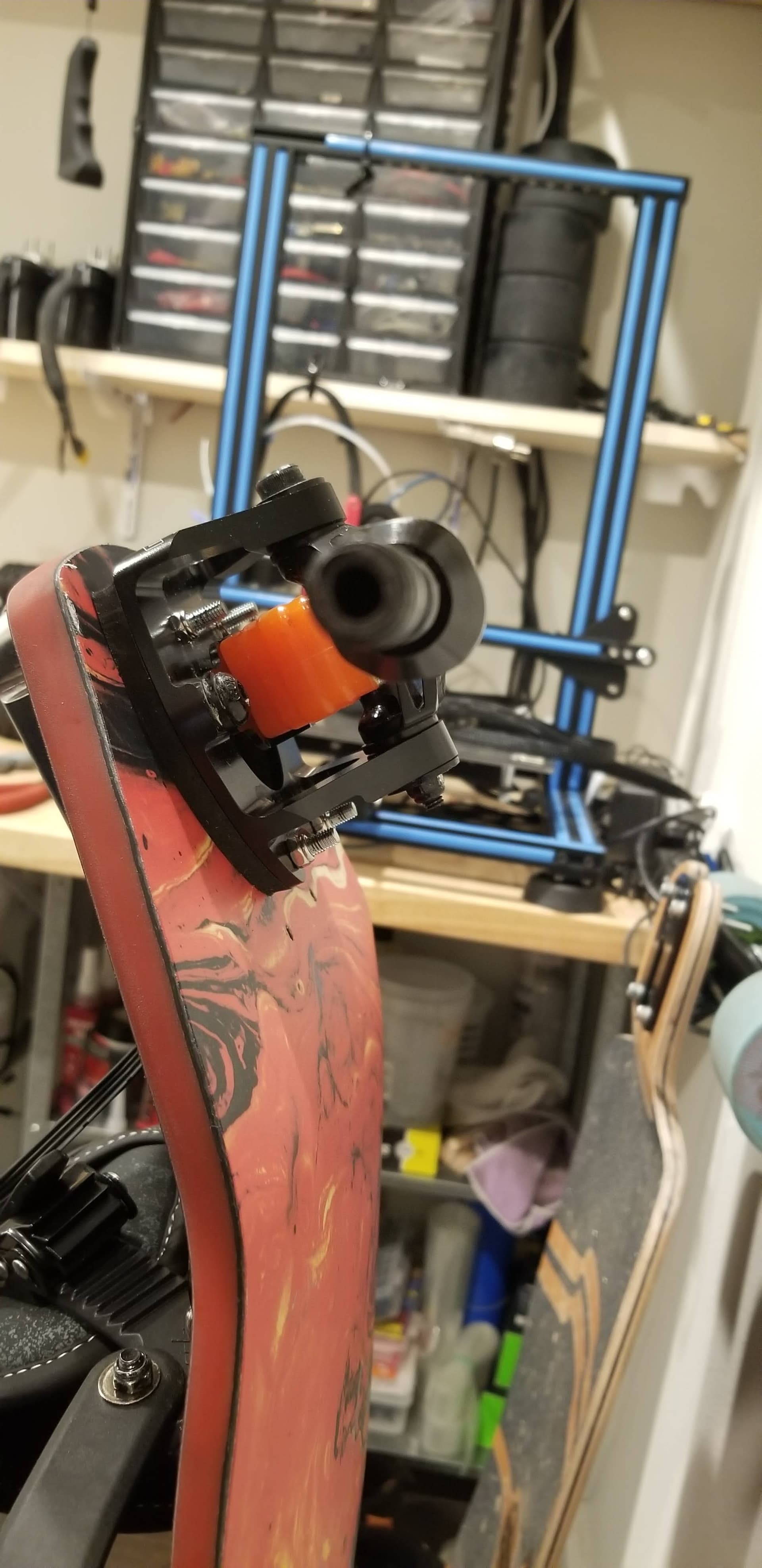

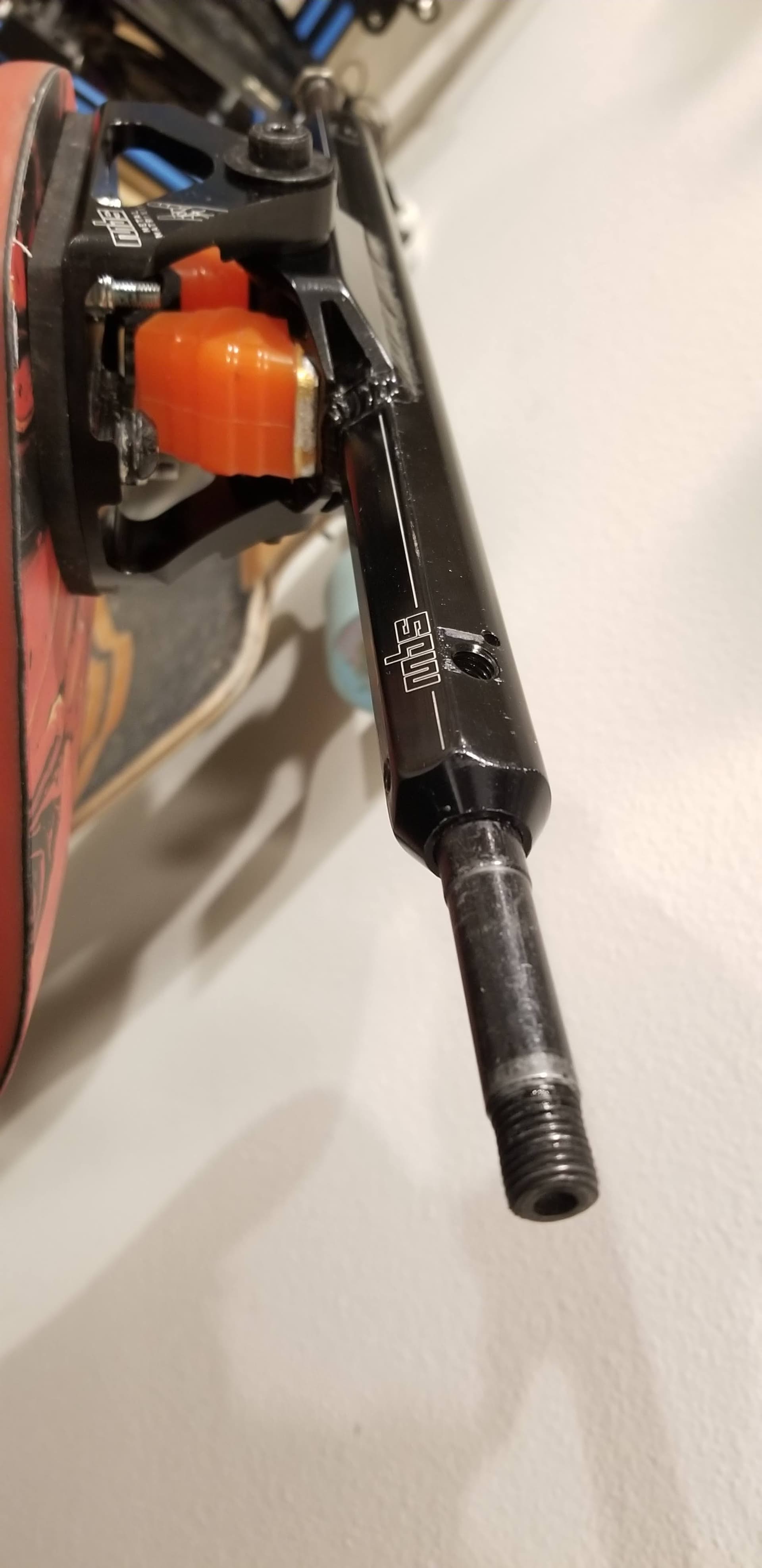

@MBS what is the correct matrix II hanger direction?
Logo out / profile ‘bump’ down?
I cleaned and reassembled these without realizing that might be important.

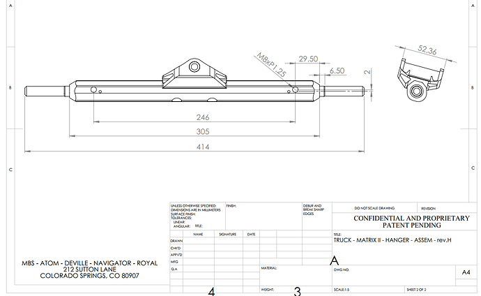

Edit:
If the second google result is to be trusted, this CONFIDENTIAL tech drawing agrees with my assumption
as does the “owners manual” it looks like
Nailed it on your first go. Orientation correct as shown in your pic. The can be mounted either way. The main difference is that the “correct” way provides a little more strength in vertical direction and a little more meat to grind through.
Bonus Round Answer - Hubs can be mounted either way. The only difference is logos.
