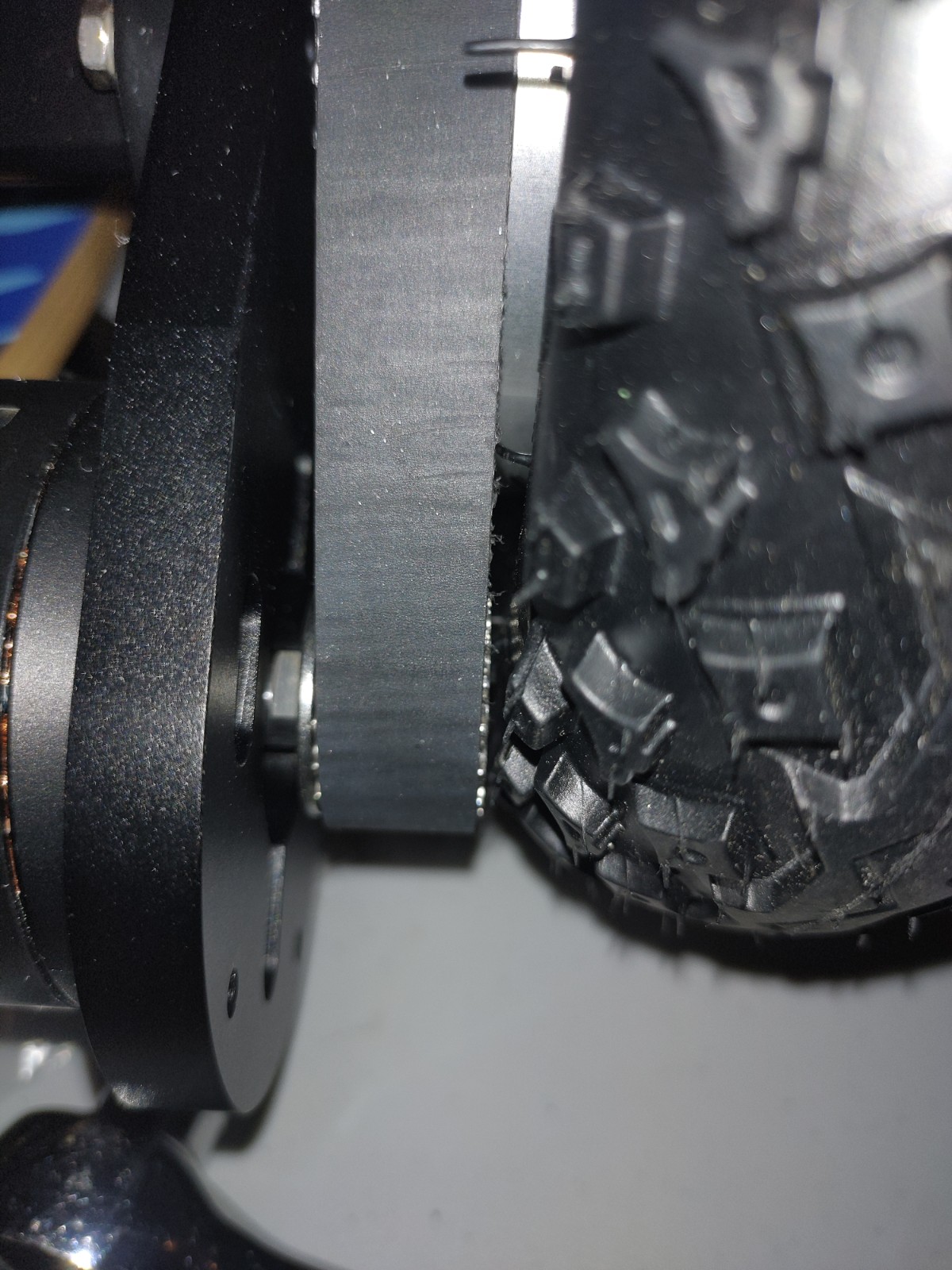

you’re going to wear down and snap your belts a lot more often and more quickly like that. it’s best to go the other way with pulleys wider than belts, or at least the same size
Unpopular opinion here, but I think that’s probably better than using a 12mm belt. Reason being that the small pulley is typically the one that experiences skipping and if you’ve got a 15mm contact patch on the small pulley then having only 12mm contact patch on the large pulley might not matter too much since it’s not typically the large pulley that has issues with skipping.

Does this seem to close? how much do you think the motor mount will move when the motor is at its highest moment of torque. They are 6384 motors. my last build was a chain that I created the adapter for, so there was tons of room. This is my first premade belt drive system. The belt does fit perfectly and is perfectly aligned, any movement of the gears and the belt either hangs off the gears or just wobbles.

Just try it out. If it rubs you will hear it. If the mounts are solid it should be fine.
