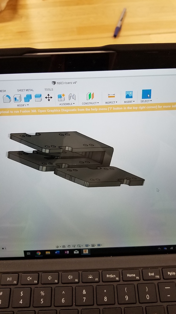

I modeled up some risers that can also hold my davega x and they turned out really good! I cant wait to try them on the board!
