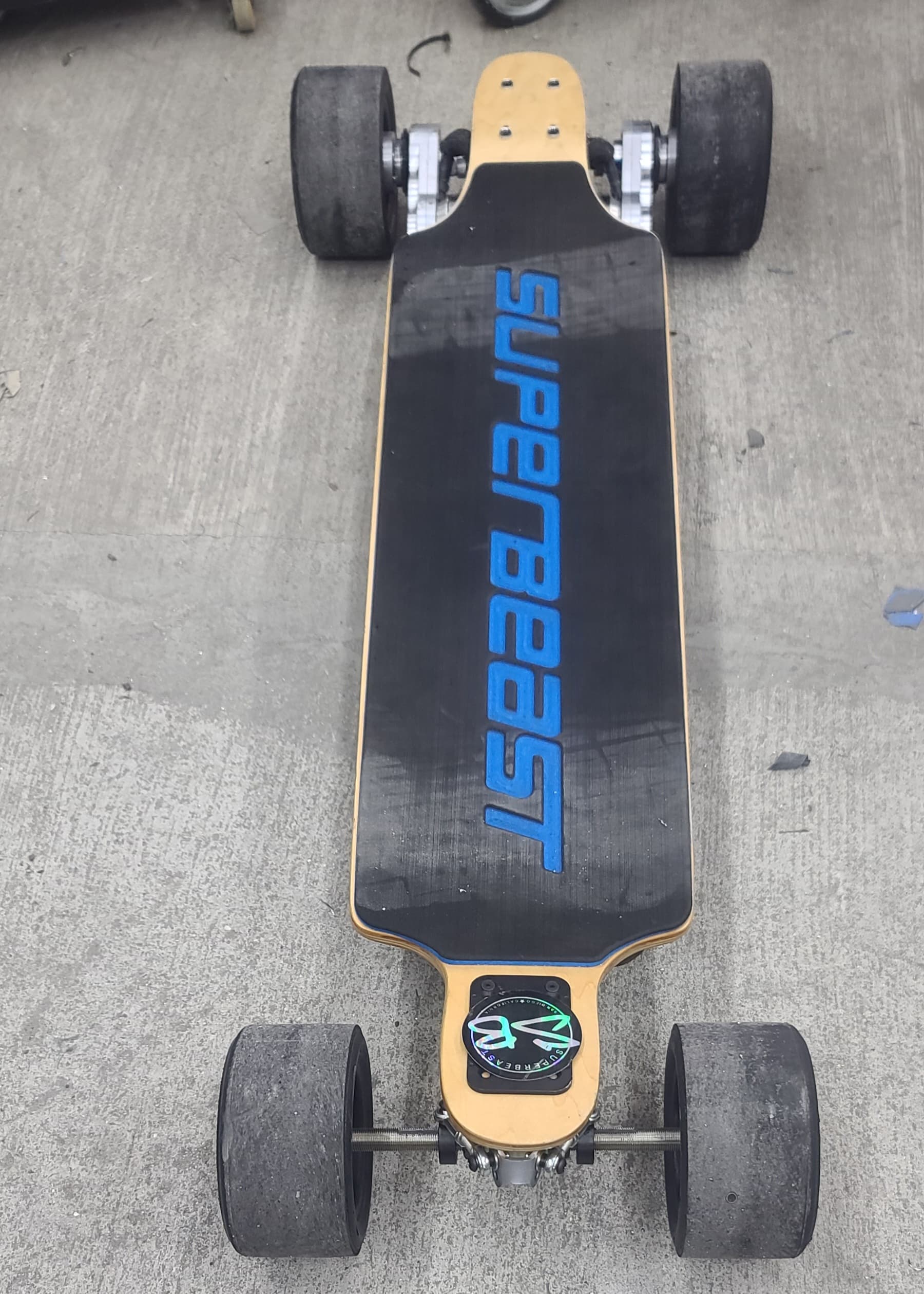

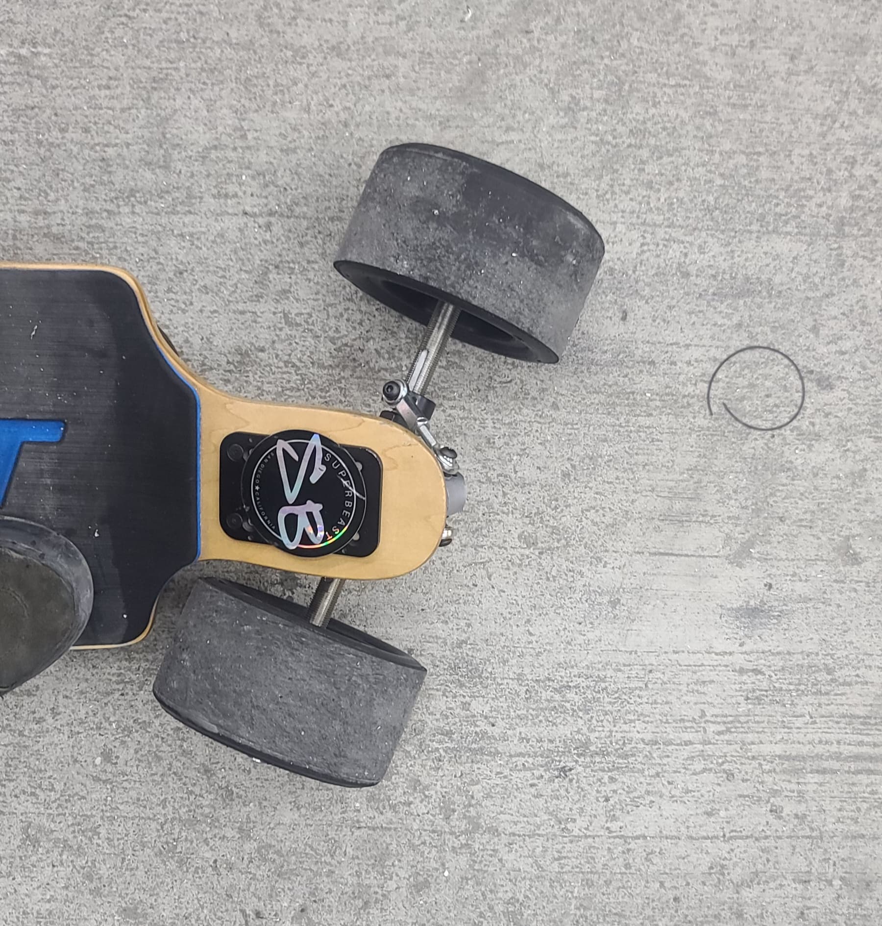

Nkp 3-link Production.

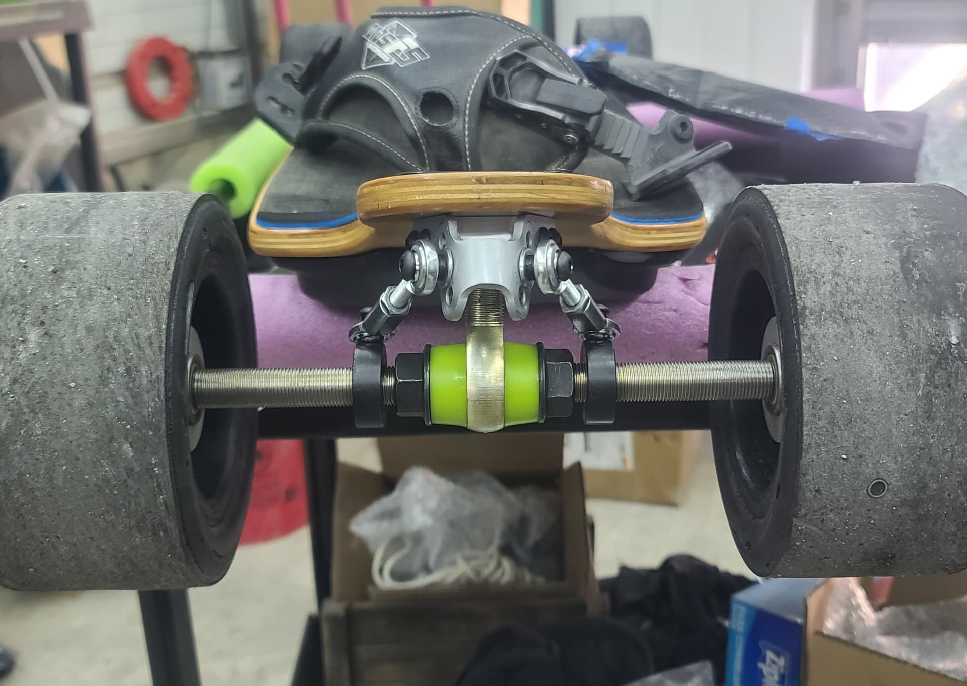

Short Rod 3-link HD Mod class entry for Electrify Race League Los Angeles
75/80 split?
what bushings are those?
We (RipTide) made some softer samples to try in our APS compound as KranK only can go down to 84a
Its what the customer wants. Based on their raceboard setup.
Custom - “the customer” is very light lol and they were having trouble with the standard krank 3 link bushings
Not sure if riptide will offer them to moe later as a normal item
We will make what is needed.
