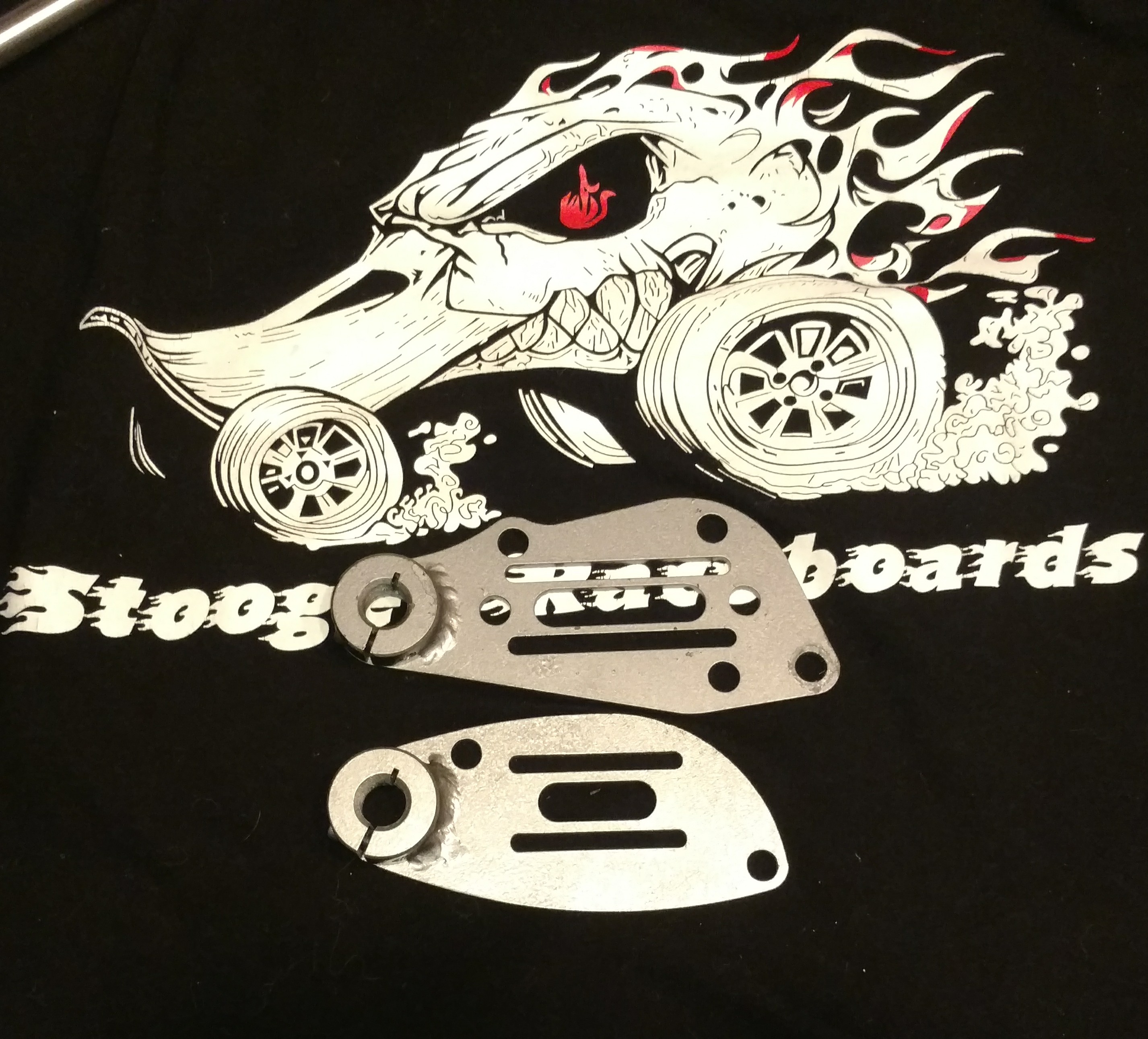

Web-store now has 1/8" chromoly long plate kits, short plate kits, bushings added and in stock.
93mm Wheels and widening kits will be added and available by the weekend.
Short Motor plates are In. Minimises plate to board interference with the open gear drive. Could be room for belts there.

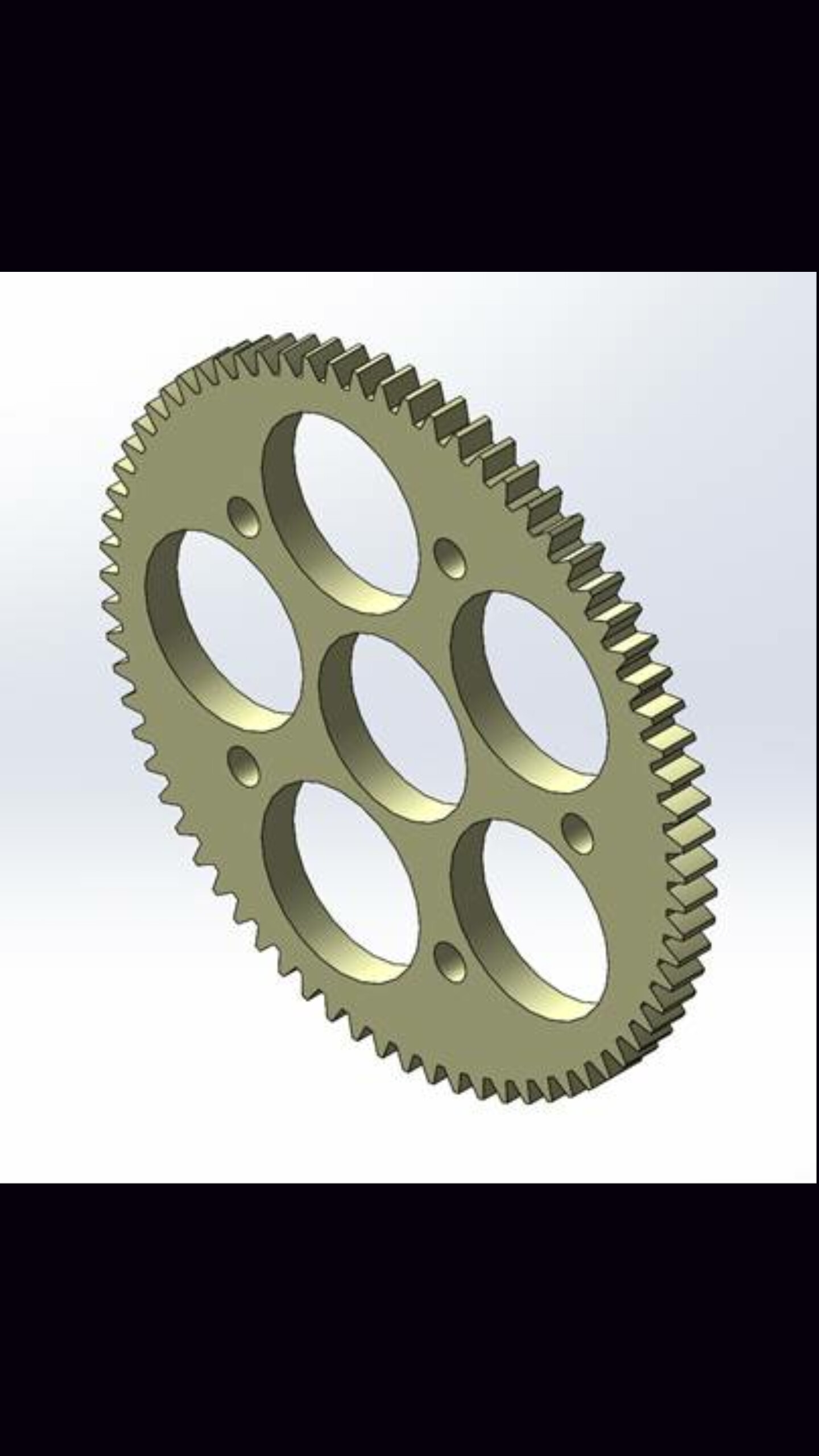

Dedicated open drive Spur gear in the works.

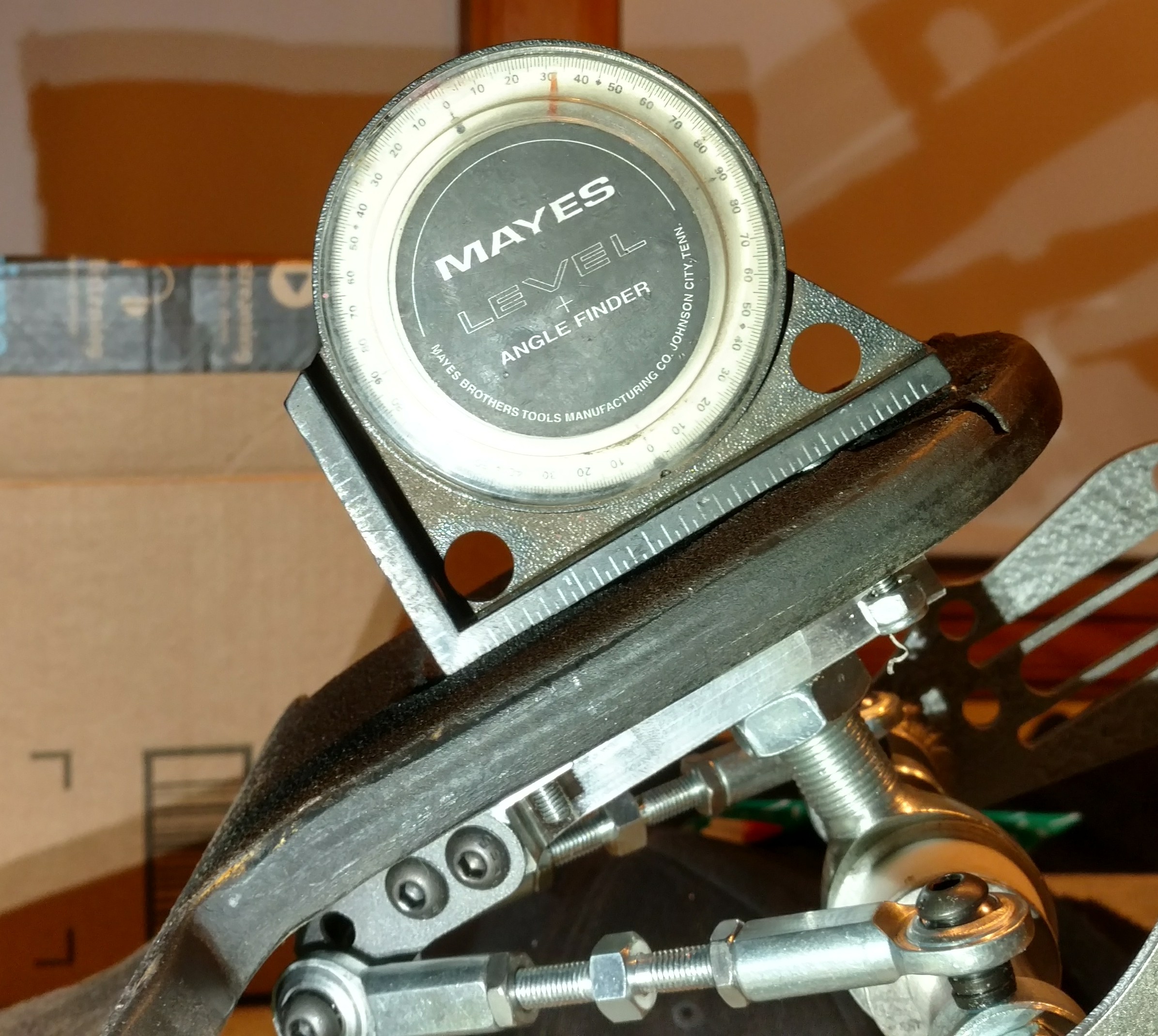

@MoeStooge and all, any reasons why I shouldn’t put 3-link on mountain board like Haero?
Can the angles account for it? not sure they could be turned down enough in the rear. Maybe you could get away with one of the stock holes up front and make a custom rod end mounting plate for the rear.
Just a thought, or maybe it could be flipped backwards and you could get something to work like that.
Yuup. This! Rotate the rear truck 180deg. Motor mounts will go naturally out the back.
Front truck face normal but relocate bars on topside of the axel. You will need to check tire to deck clearance

Trail riding yes. Jumps no bueno!

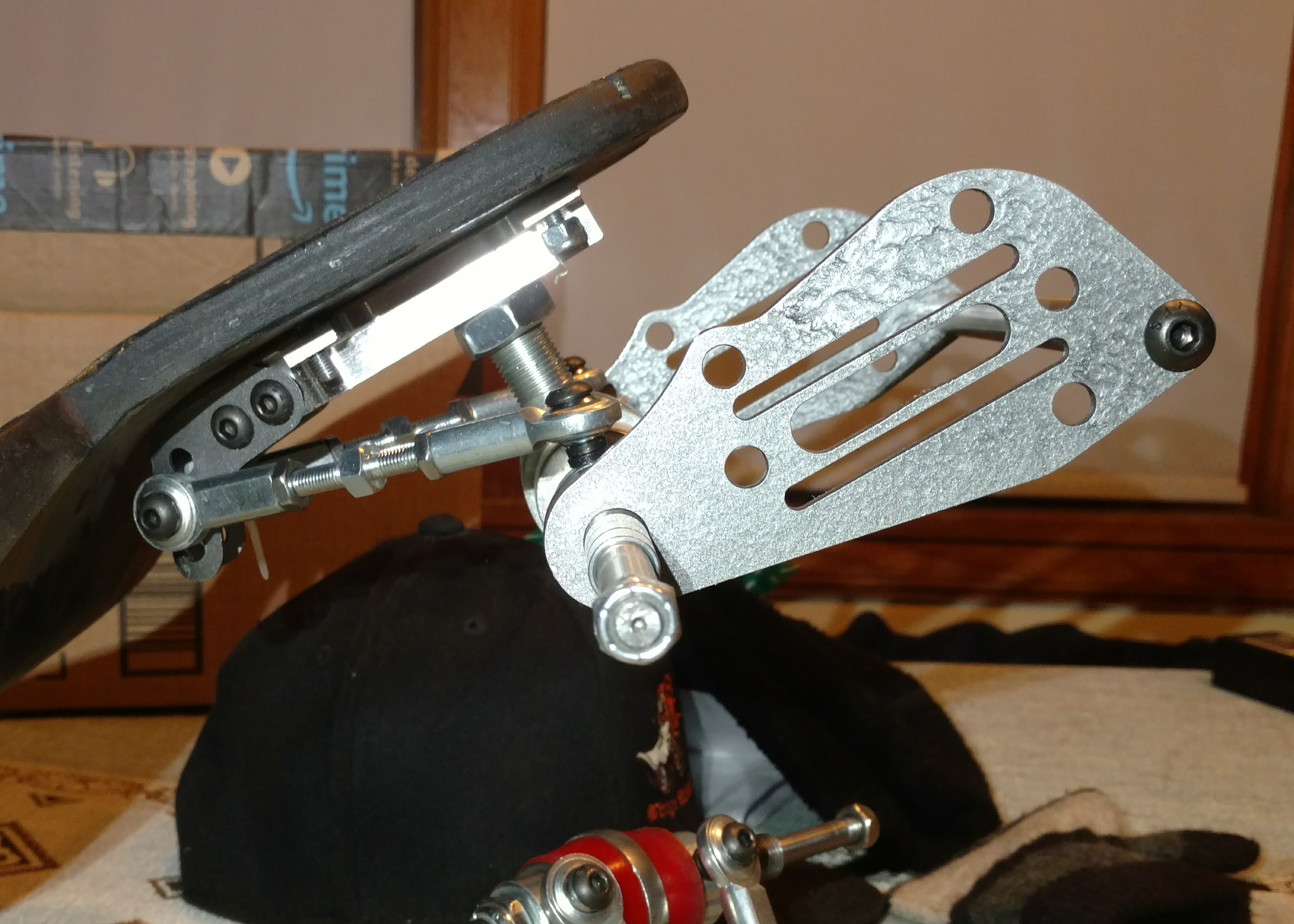

Looking at this closer, also flip the front truck 180 and adjust in a 45 deg bar angle…

I must be confused, but wouldn’t that turn the wrong way if the links went forward?
You’re not alone I wondered the same thing…
With the plates reversed, If the links were going downhill to the axel it would have backward steering.
We ran the world record board in this configuration a few years ago at 63mph.

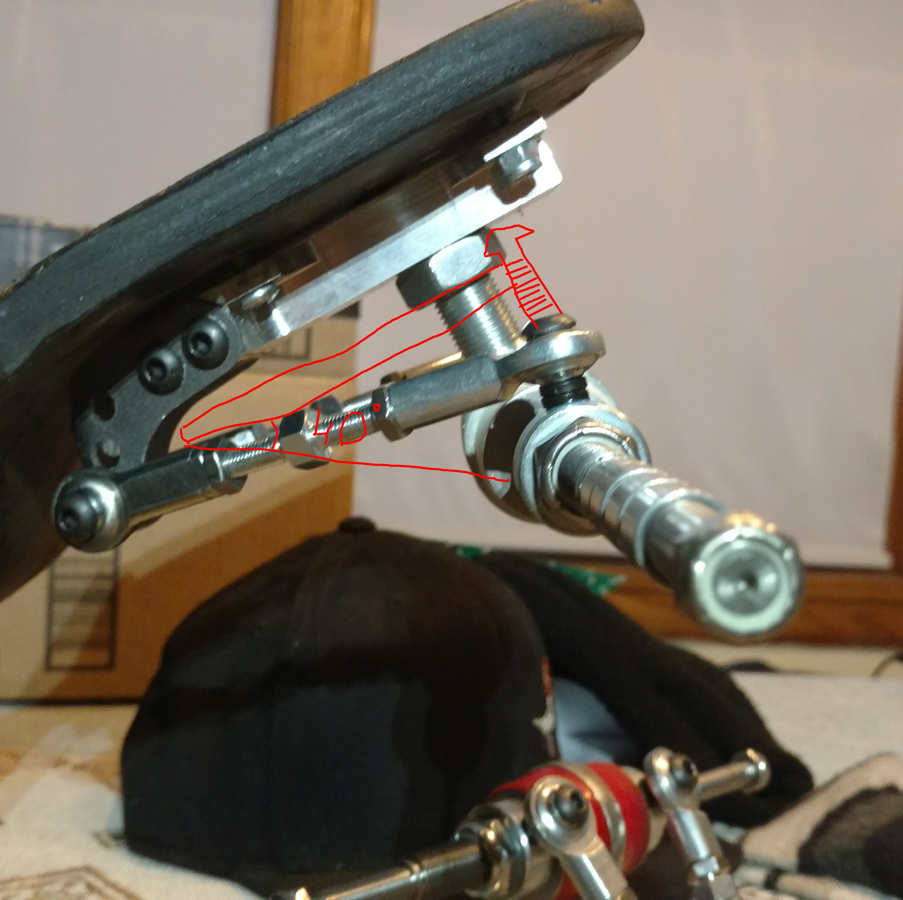

Front setup may need some more tweeking.

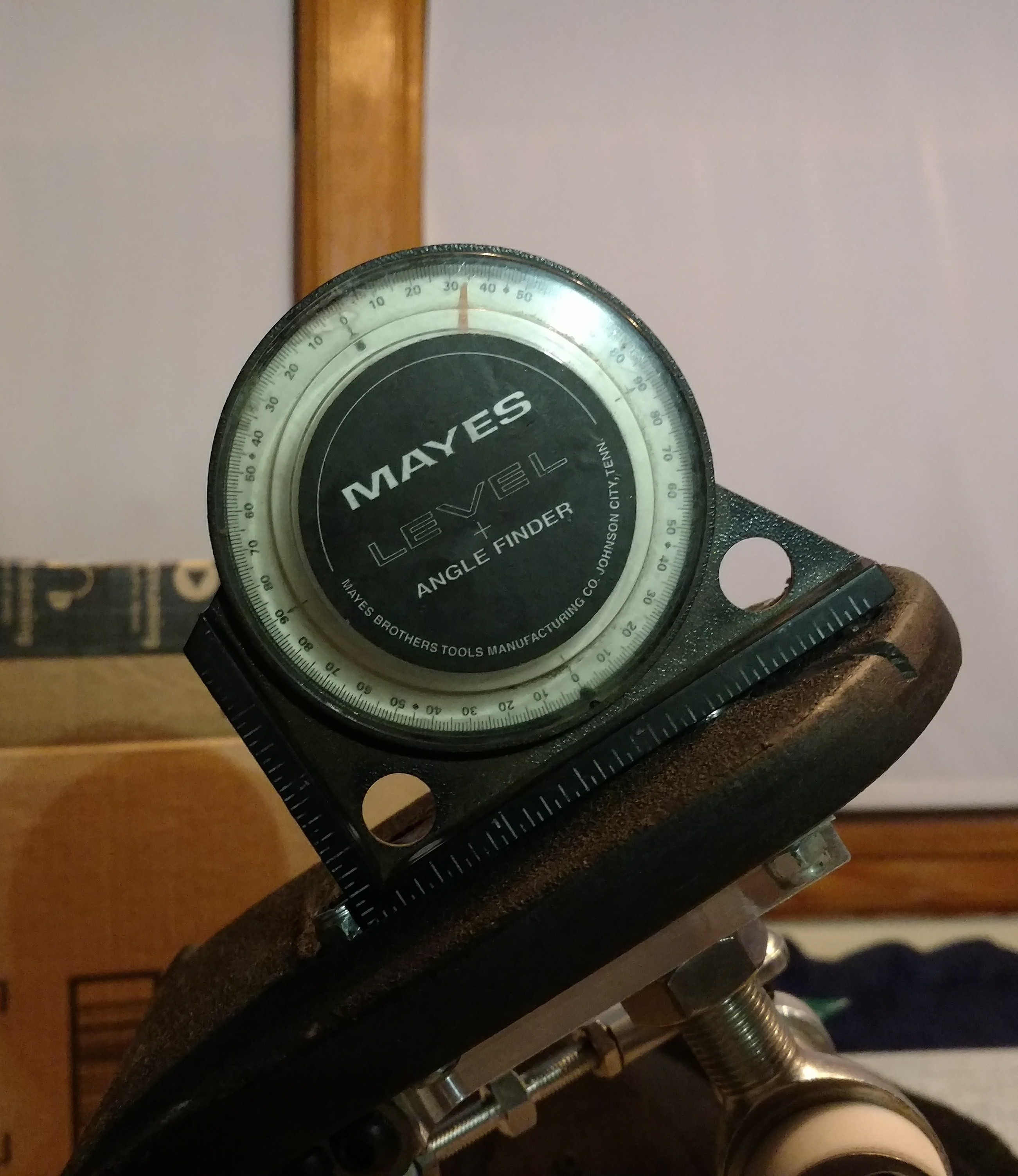

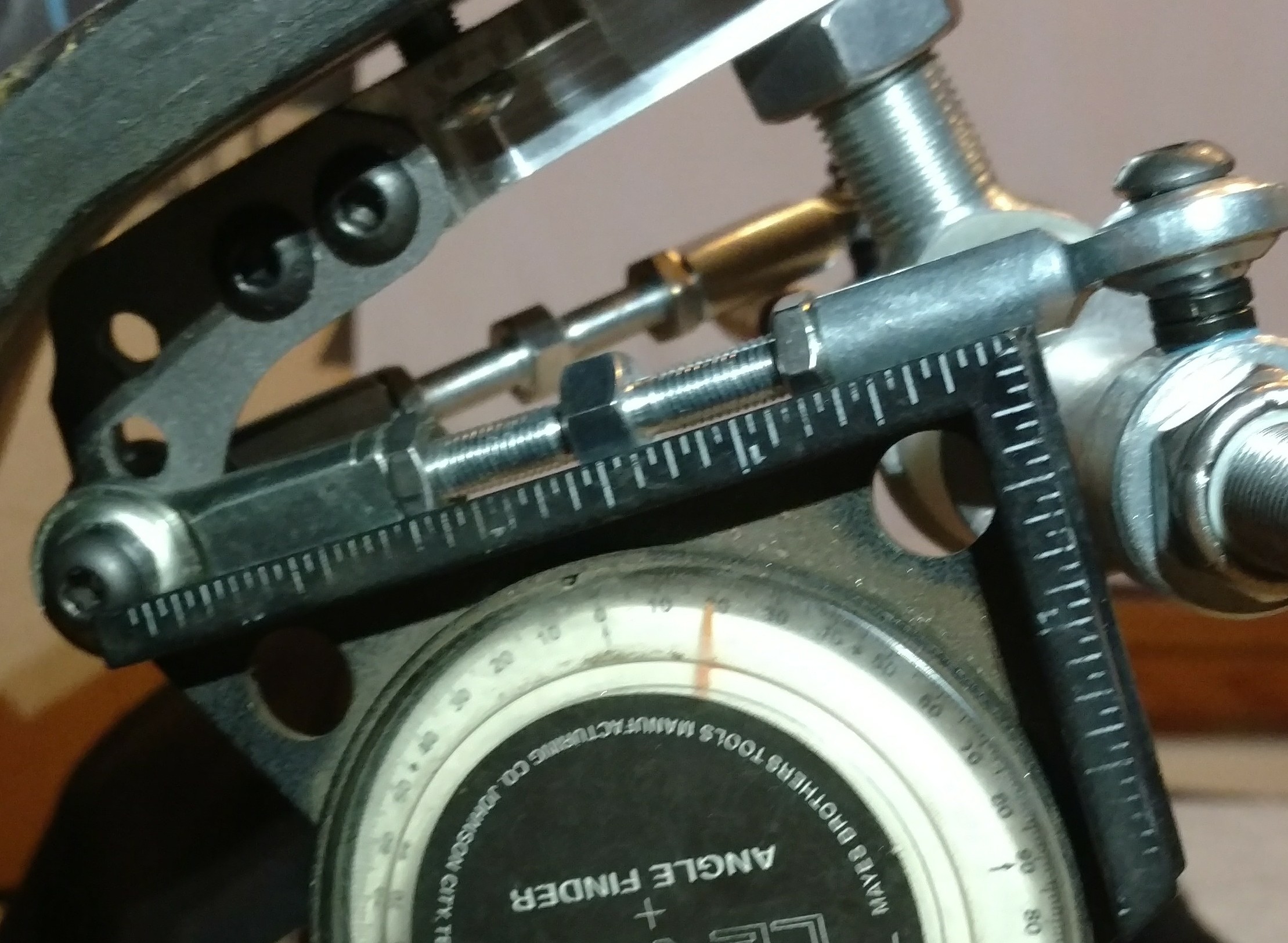

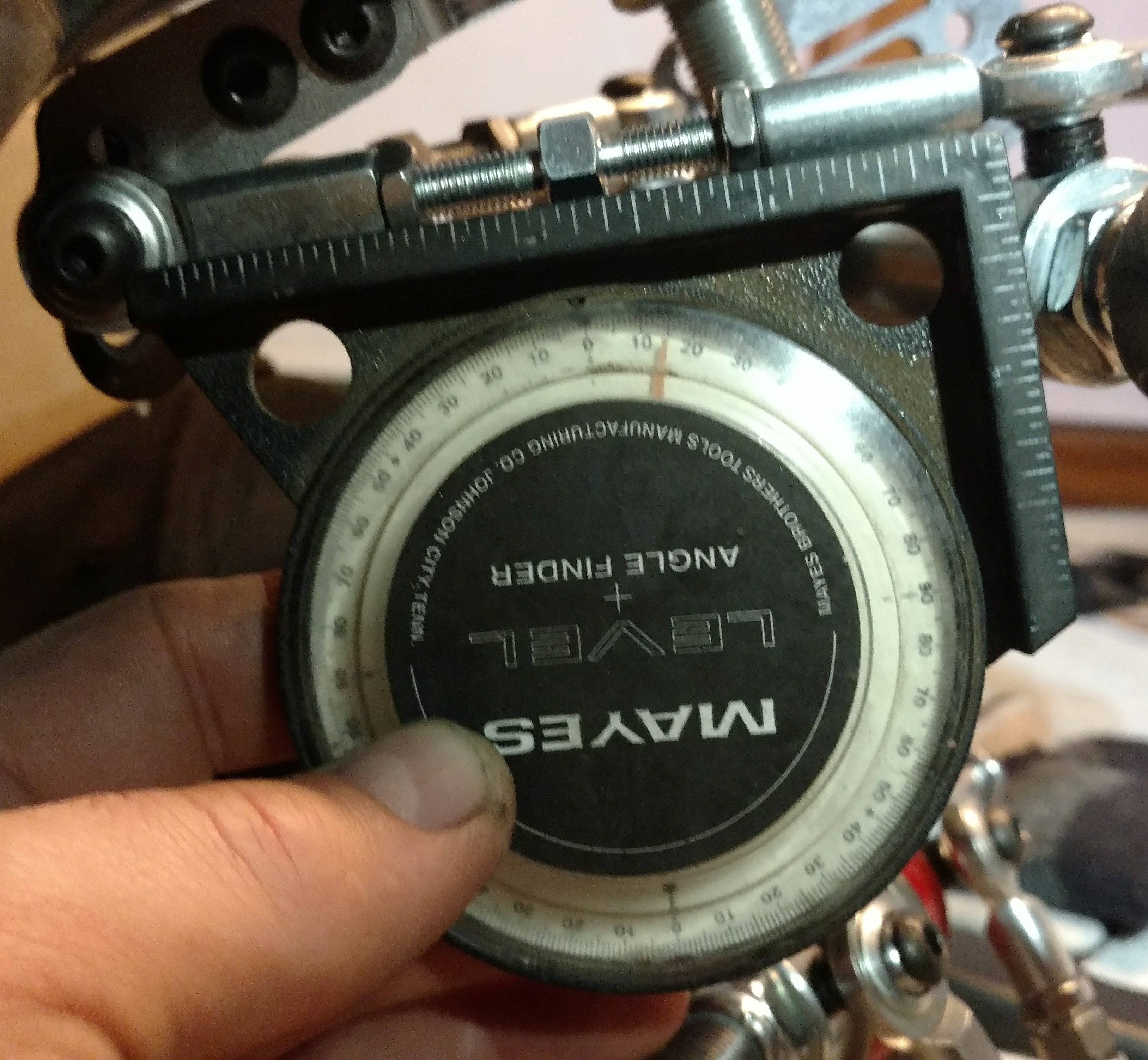

By a wedge plate or dropping the main spherical
Bearing ride height to make the angle around 40deg. 20 is not enough.
Best solution would be to run a longer pan head bolt out of the collar and stack more spacers accordingly.
you mean like that?
