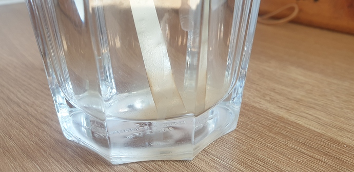

NKON Nickel quality issues *Solved 04/09/19*
So far… what do we reckon?
Looks rusted to me. The thing is that stainless steel does really rust that is why people use it for work outside in the elements. My other hobby is metal detecting and the scoops that everyone uses in salt water are either aluminum or stainless because they don’t rust. Now since you used a grinder on it that should effect the top layer enough for it to rust. For him to to say do the salt water test is showing that he may know that it takes a long time for stainless to rust. And stainless also has 11% stainless depending on the type.
What I would do is try to get some sort of acid and drop a US nickel which may be hard cause of acrossed the pond or know good nickel stripping in one cup as and the nickel strips in another and see the difference they both should act differently. I know a product called rustex from rustoelum has a 25% make up of phosphoric acid and is used as a rust remover.
Do you have any of your old nickel left that you can drop in the salt water as a control?
Can you weigh, or can you do a resistance test?

I would gouge the strips more than you did though before putting it on the salt water. Big gouges with a razor blade or knife, then do some halfway cuts too, to really expose the middle.
That being said I think it looks likes it’s beginning to rust in your photo. I’ve always bought from the same supplier by the kg on AliExpress and never had a problem.
I’m thinking if he dremeled with sparks, he got through to the steel already. The dremelled spot should be rusting faster. TBH from the photo it doesn’t look like it’s rusting like steel strips (yet). Rust usually happens pretty fast in these tests, right? If it’s stainless steel and not high carbon steel (very unusual/unlikely?) the rust test won’t work like usual, which leaves weighing, and measuring resistance.

I’ve had fake strips rust within 24 hours just from touching them with my fingers.
This is it 5 mins a go so 4.5 hours in the salt water

Now I have gouged one of each type with a tungsten scriber so as not to contaminate them and put them in saltwater.

I would wait until more conclusive tests have been made.
Then, if these tests have proven without doubt that it is nickel plated steel go back to him with the proof.
