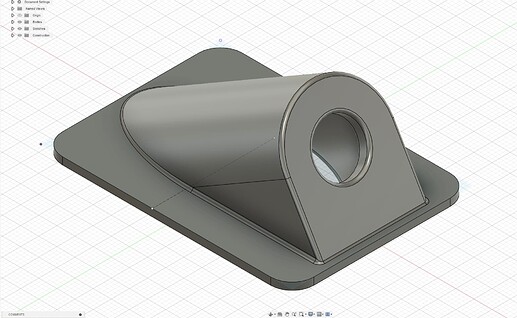

Additionally, me and a friend have refined the laser holders, which in all honesty was just me taking inspiration from Lorentz Major’s laser brackets.
This design is cleaner than the previous and will allow for more space between the lasers and battery.

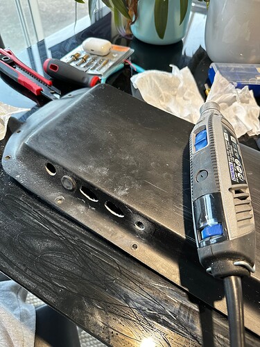

Currently working on the enclosure and drilling and stemless cutting it for the laser diodes and all the switches/charge port. Will update in a couple hours.

I got the brackets made and fit them into the enclosure. The design of these is probably as low key as I possibly could get them, while still having space in the inside to not hit the battery.
Got some JB weld plasticweld to fit these on from the outside. In the future I’ll design a more seamless design so it can blend a bit more into the enclosure. Hopefully the joints are properly sealed after the weld sets and I’ve waterproofed the section.

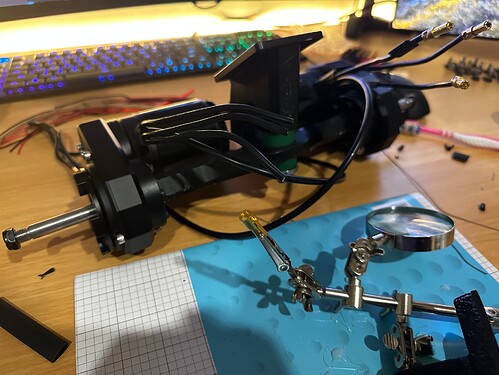

I’ve now done a test vesc setup and got everything working surprisingly well. First task before the setup was to cut the motor phase wires in half and to replace the 4mm connectors with 5mm ones.
In total I’d say I’ve spent 24 hours of soldering :sweat_smile:. I only have experience building FPV drones, so transferring those skills to system with 3x voltage of drones + 200+ amps was nerve wracking. In addition, also having to trim LITERALLY every lead in this board and add connectors to make efficient use of space and easy access for future troubleshooting.
Motor detection amid all the other parameters needed to be set went really well, no issues…yet. One option I’m not confident on is whether traction control is needed. Other than that, the light system I made works as expected, I just need to solder on the tail lights and add an AirTag somewhere. Securing the components, waterproofing, then final assembly will commence once those jobs are done.

Waterproofing and final assembly are almost done, just got to solder in the taillights and and secure them, then balance the wheels before putting the final truck on. Trying to route these motor phases and lights through these flex sleeves was a PIA.
