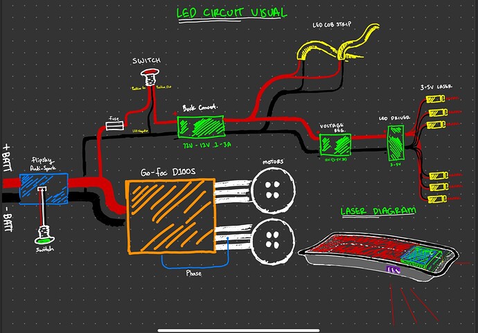

I had some free time away from studying and drew up a visual representation of my build. This will come up in handy for when I put things together. This is still very ambitious with the available space so some of these LED/Laser features might not be on the final build.
Possible wiring for the internals. Not even sure if this circuit will work or be safe. Going to take a few measures and tests before installing this in the board. Also some methods to reduce electrical noise.
Whether this works or not, it’ll be fun trying to get all this accomplished
You don’t need an antispark for the d100s mate it’s got a switch built in. Just put a xt90s on the pack discharge for the initial plug in
I like your diagram it’s fun
Wow I’ve only now just found the manual for the Go-Focs. Good thing I hadn’t ordered the anti-spark yet. I did order about 5 switches though…

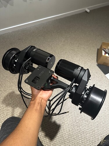

Motors and ESC finally arrived, so the build will now be properly started. First up was fitting the Newbee Gear Drives onto the Onsra trucks. Tons of obstacles such as bolt sizes, tiny tolerances requiring sanding down etc.
Had to cut down the axles by 12mm to properly fit the 3DS hubs and match the truck widths for both trucks.
The 20x20 clamps for the drives were 1mm too small for the onsra trucks, so some sanding/ chiseling had to be done. Had to hammer the clamps down, and add metal shims to one of them as I’d shaved the clamp down too much.
Didn’t have any bolts at the correct length for either the baseplates, or the wheel plates for the drives. I probably cut 30-50 screws changing them all to the correct length. Also countersunk the baseplates to get a more sleek and flush look for the bolts.
Absolutely beautiful, but god damn it’s heavier than I expected. Considering that noone’s put these drives on Onsras and they weren’t made for them, I’m pretty satisfied with he result.
Also adding integrated lights to this board, which will consist of 4 small led strips as taillights, then 6 lasers out the sides similar to the Lorentz Major. Here’s a summary of the process of making this work.
Super rough visual for the electronics in the build. Had too much time on my hands when I was drawing this up.

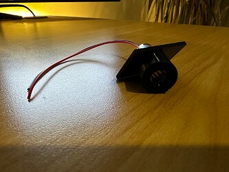

Lasers and LEDs arrived so I started designing the bracket holders for them. Got a friend to help with the 3d printed portions.
Got the first prototype as a reference for when it’s used on the enclosure.
I’ll be wiring up the entire light circuit when I’m next free. Will definitely change up the 3d print to be at a more aggressive angle, and make the holder a bit smaller. By the end the lasers should form the below pattern. (Imagine a third laser line)
That drive setup looks great. Did you have any compatiblity issues with the Reacher motor shaft and the NewBee gear drive? Can’t tell if you are using a spacer between the motor and the gear drive or not.
None at all. I got these directly from Reacher, and they’re 10mm shaft so these don’t have that stepped down section. I just had to cut the shafts down to length to get them to fit into the drives. If I’d used SKP or Radium’s versions I probably would’ve had to use spacers.

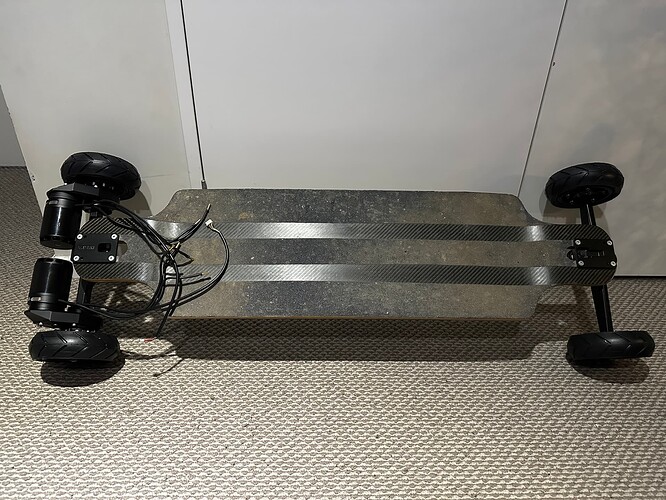

Did a test fit of the drivetrain onto the deck. Gotta say despite it being heavy, it’s slim enough to be in the “Ultraboard” category.
Just gotta spray paint the bolts black and balance the wheels to finish the drivetrain side of things. I used PTFE grease on the drives and holy are they quiet. Added some bearing speed cream to each bearing on the wheels and drives and the freeroll is so insane. I could probably kick push the board even with all the weight.
