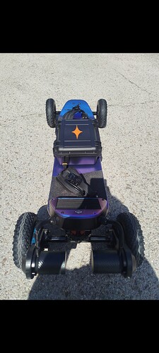

NewBuild Dr BraiS
Very clean build, bravo!
Indeed. Did you do the deck yourself?
Sharp build dude
This build looks awesome! Great work!
Wherever you have to cross balance wires over like this:
My understanding is that it’s best practice to create a bridge out of fishpaper to ensure no chances of rubbing through the wires. I have also heard that the insulation on LLT BMS’s is pretty tough and here specifically isn’t terribly likely to be a problem too quickly but it’s worth knowing about anyways, there’s a few good examples of fishpaper bridges here
What deck is that? Fire build dude.
yes
Thanks for the advice
Super clean dude.
Did you make this deck as well?
