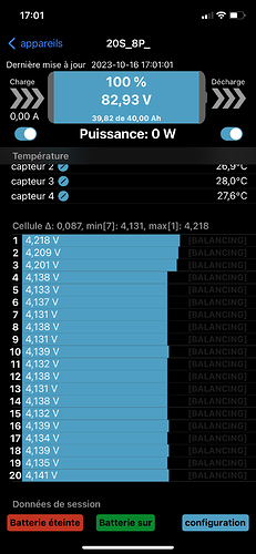

Hi,
Am
Having issues with my balance process, pack 1-3 are 0.070volts out of balance. My LLT BMS is acting weird and when I plug my board cell 1 drops to 3 volts consistently despite really being a lot higher. My charger dosn’t tickle charge anymore an charges in burst of 1000 watts and never goes below 800 watts until the max voltage is reached on cell 1-3 and. Am leaving it on the auto balance setting for nights and still same result after pack has been balance. Weird sporadic voltage on cell 1 no tickle charging only bursts of high currents.
I’d put money on there being broken welds on thst first group
The board discharges perfectly and the imbalance gets better as I discharge the board I don’t have any cutoff or anything it’s dead smooth and I push it a lot. Maybe bad balance lead that’s making my BMS trip and overcharge the 1-3 pack ? The thing that is scaring me is that the charger dosn’t lower the amperage threw the charge it stays charging on max power until max voltage is reached on pack 1-3.
I would be inspecting those first 3 groups very carefully. If they are charging faster than the rest, its very likely that they have broken welds or dead cells.
Problem now is that if they have been this way for several cycles, there is quite a big possibility that the cells in those groups have gone under voltage and have the potential to be damaged.
You really need to open it up and inspect
Or just throw it out to be safe.
but we haven’t assessed the damage yet
Found the issue, it came down to lowering the equaliser starting voltage from 4000mv to 3600mv now it’s balancing right and the charger correctly lowers the amps at higher cell voltage like it’s supposed to.
Seems like treating a symptom rather than the issue.
A healthy pack shouldn’t be that far out of balance and starting balance at storage voltage is a band aid, not a solution.
The balance starting was at 4.0v witch it’s pretty high should be more around 3.7-3.8 I will try to put some cycles see if it solves the imbalance.
I disagree but you don’t seem to care too much anyway. Good luck.
