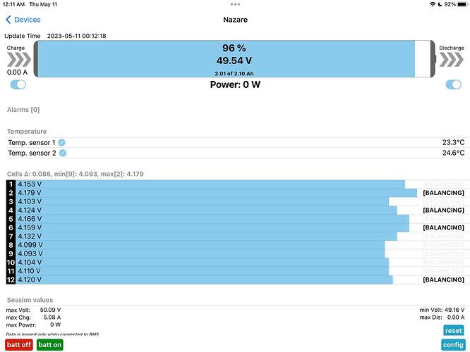

New to the BMS config settings on xiaoxiang. The delta is a bit high, so I set the balance to aim to balance to a delta of 15mv.
Cells started balancing after settings were changed, however only 4 cells seem to be balancing. I monitored for about an hour and no change. Same 4 cells balancing.
Can anyone help me with what this means? I expected all the cells to begin balancing.
I tried balancing when charging only and also when not charging. Same 4 cells will initiate balancing.
ā€œBalancingā€ in the context of the typical BMS, LLT included, is simply bleeding energy off of cells (groups) that are in a higher SOC than the others. Static balancing (not when charging) is a slow process and can take a day or more depending on the delta.
Leave it on static balancing and check tmrw. The delta should be much reduced.
