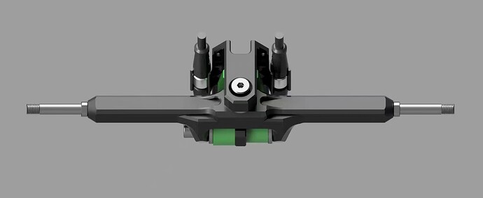

Newbee Swing-Arm truck

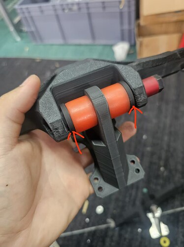

I heard a ticking that sounds like something about to break :thinking:
I think thats because most of the parts is 3d printed. And the alloy plate is made in a cheap way…even tho the gear was seating in 3d printed core. Was trying to verify it in low budget.

SAT for racing( 0 rake)…i improved the ground clearances
Specs: 280mm hanger width, 392mm full lengths…22*22mm profile…j think i going to get few set of sample.

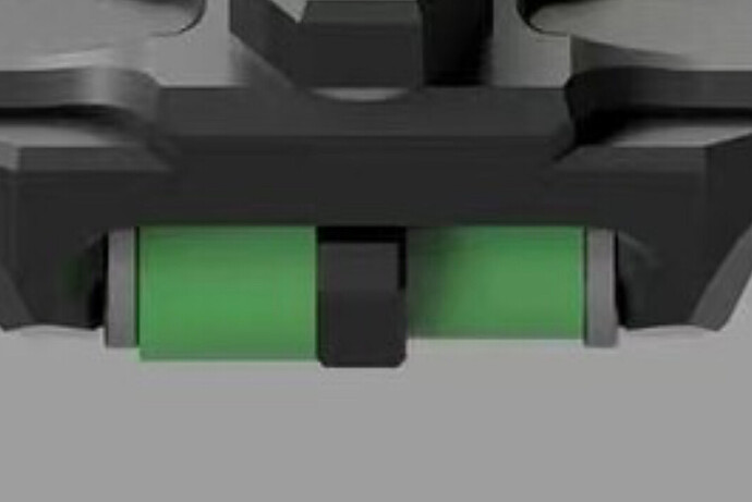

One side chubby one side barrel :rofl::rofl::rofl:
You know one always hangs lower than the other
This looks epic! Like a duality but with a more uniform compression of the bushings.
Duality has completely uniform bushing compression, as the kingpin (technically queen pin) is free to move up and down. You are supposed to run the kingpin’s grub screw loose
I mean the plane of compression is constantly perpendicular to the axis going through the center of the bushing.
I did custom washer one side with thread, which are slide into the hanger, so one kinpin, you could equally compress the bushing. Tall bushing and regular bushing all suitable.
