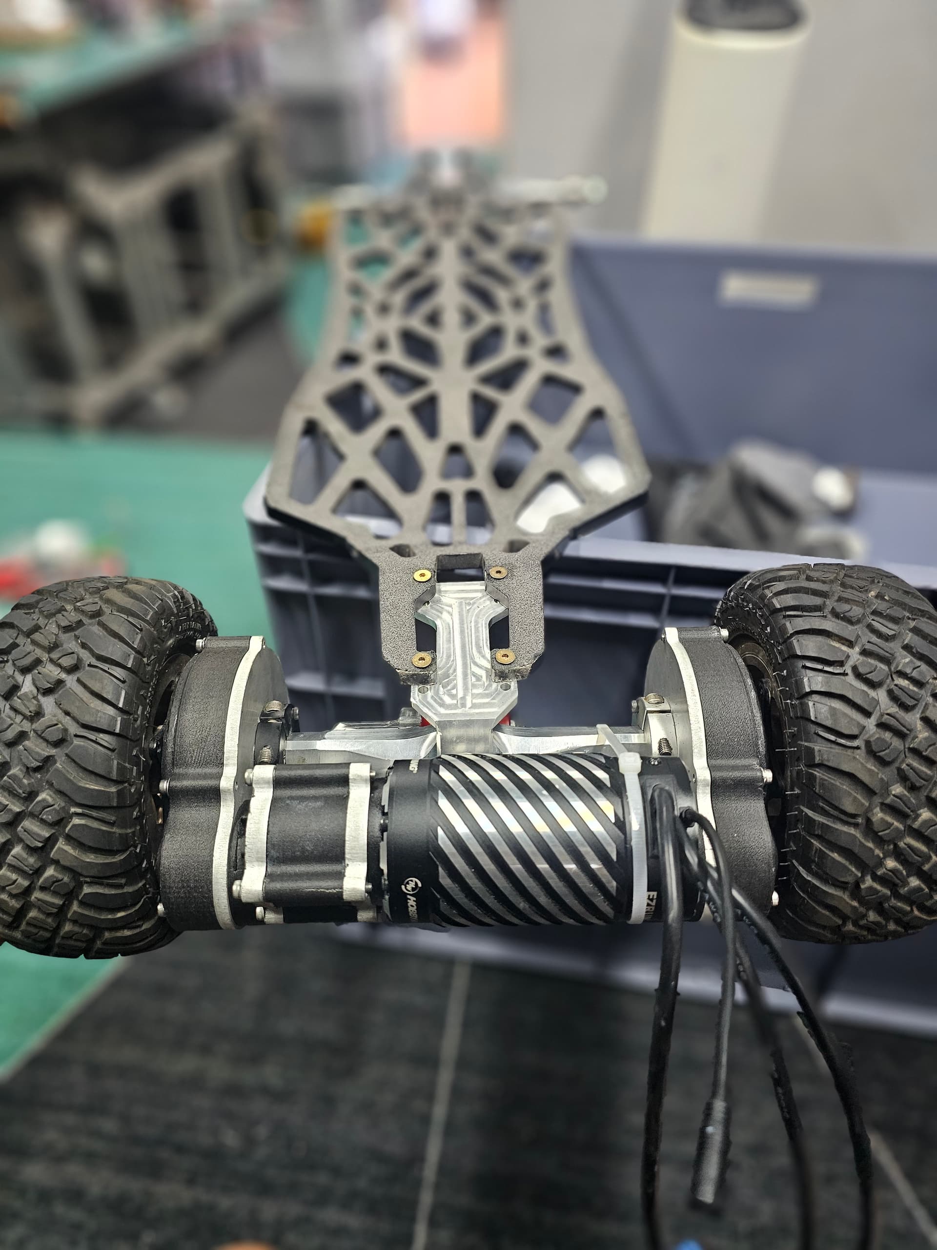

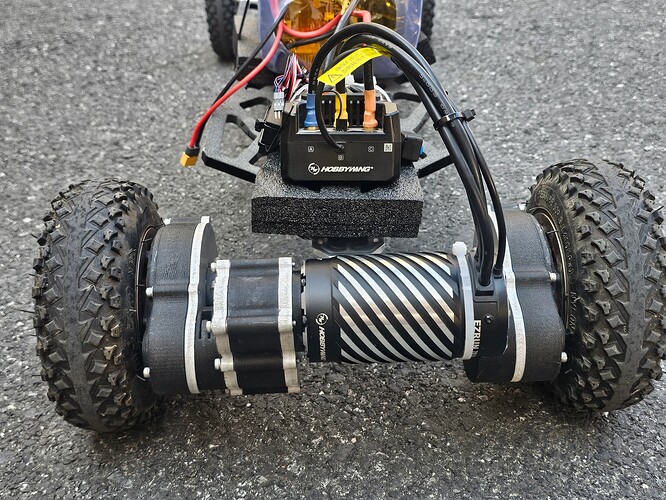

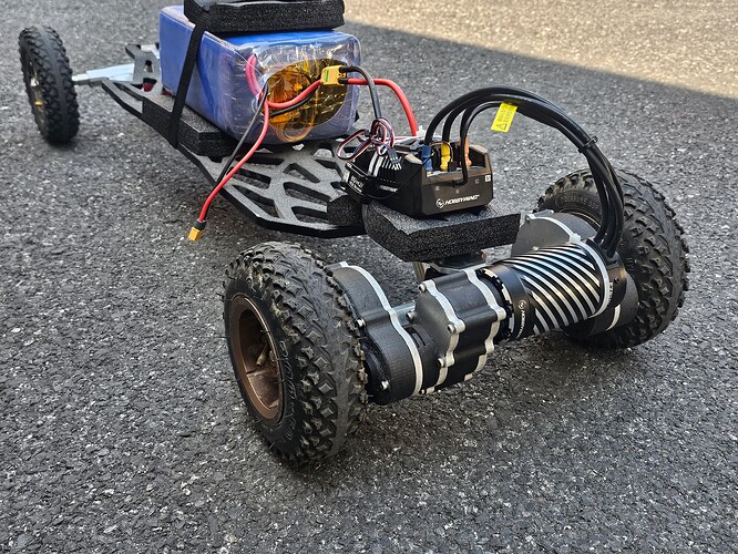

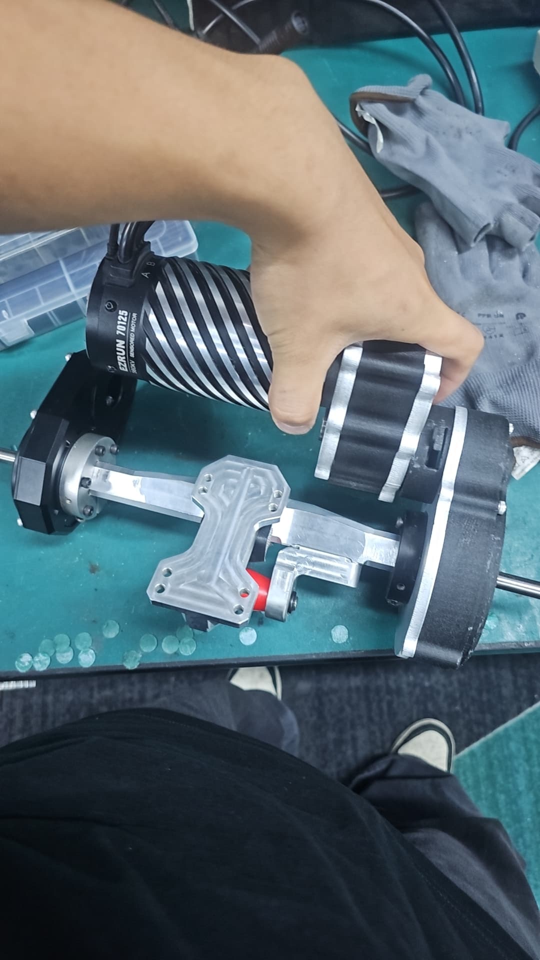

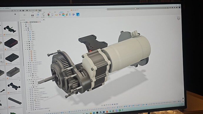

Some progress…
Hopefully could done field test this week.
so this is a dual gear reduction drive?
am i right?
with gear shifter? :smiley:
tho i thought he was working on a differential? one motor two driven wheels.
Lever to lock/unlock the diff?
Wow thts new shit
Yeppp, you getting there.
so just to make things clear
its a dual stage gear reduction where you can set the gearing with a little lever?
its not a differential?
does it spin both wheels?
KR
There is a shaft that drives both wheels, you can see it in this video:
I assume the lever will allow you to lock/unlock the axle depending on if you want both wheels turning together or not.
