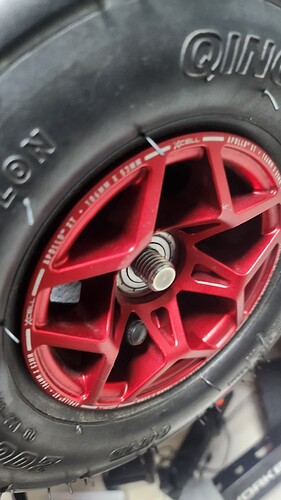

Is anyone running Newbee 4GS with xcell rims? Looking for a fitment check
I don’t see why they wouldn’t work, those are Mbs pattern
Interference occurs when using the accelerator wheel. You can use it by putting some washers on the axle. my wheels is Xcell Apollo XT
Thanks! Do the bolt heads used to mount the adapter plate get in the way? That was my concern also since the mounting threads are only on the inner face of the rim. Any chance I could see a photo of the adapter plate mounted?
Yes, it does. There will be interference without the washer. You will also need to use shorter bolts on the hub side than the ones that come with the Landsurf. I will attach a photo later. I am outside right now.
Appreciate it. With washers creating clearance, do you still have enough thread on the axle to secure the wheel?
This is super helpful because I’m trying to see the fit for hypertrucks specifically.
@andoug
came back I received 4 washers from a friend. I put 2 in and there is no interference. And the axle nut can be sufficiently locked. My Landsurf nut is for MBS, so I tested it with a different nut. The black nut is long, so it looks less locked, but a Landsurf axle nut or a regular nut will suffice.
Thank you! Much appreciated
May I ask where you purchased those black, long lugs from?

That nut looks great, unfortunately there’s no nylon nut version of it. A bit skeptical if it will hold on from vibrations from riding.
so i buy hypertruck ver xcell nut again :slight_smile:
If you’re talking about the xcell axle nuts, they hold fine. on a 12mm axle with proper spacers, you can just crank down the axle nut with more torque and it’s plenty. Lacroix and xcell both don’t use nylocks - i’ve never had one come loose.
Am curious - is that with or without loctite? If with, do you use a particular type, or just the generic blue/242?
