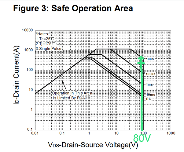

There are many limitations on current. In addition to looking at the conventional parameters given in the specification, it is also necessary to analyze from the following aspects:
  1. MOS tube operating temperature;
  2. MOS tube switching frequency;
  3. MOS tube operating voltage;

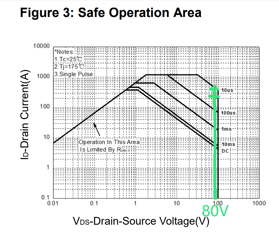

In actual applications, we cannot only look at the parameters given in the specification, but also need to check the working conditions required to achieve the parameters.

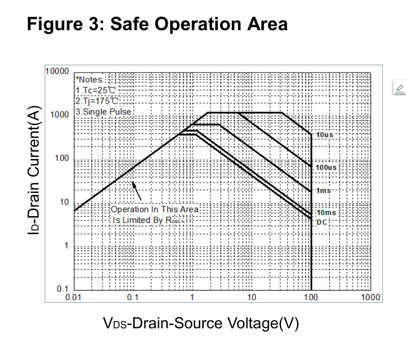

For example, by observing the safe operation curve of the MOS tube specification, it can be found that the MOS tube can only be turned on for 10us at a 100V operating voltage with a 380A current.
2203031730_HUAYI-HYG015N10NS1TA_C2979263.pdf (453.4 KB)

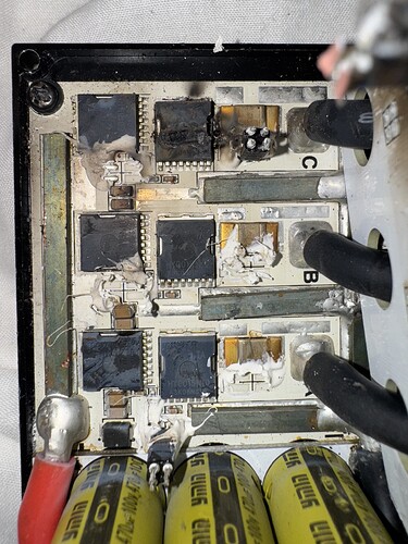

Careful with these. I just got the 84100HP and this is what happened on my 3rd ride….

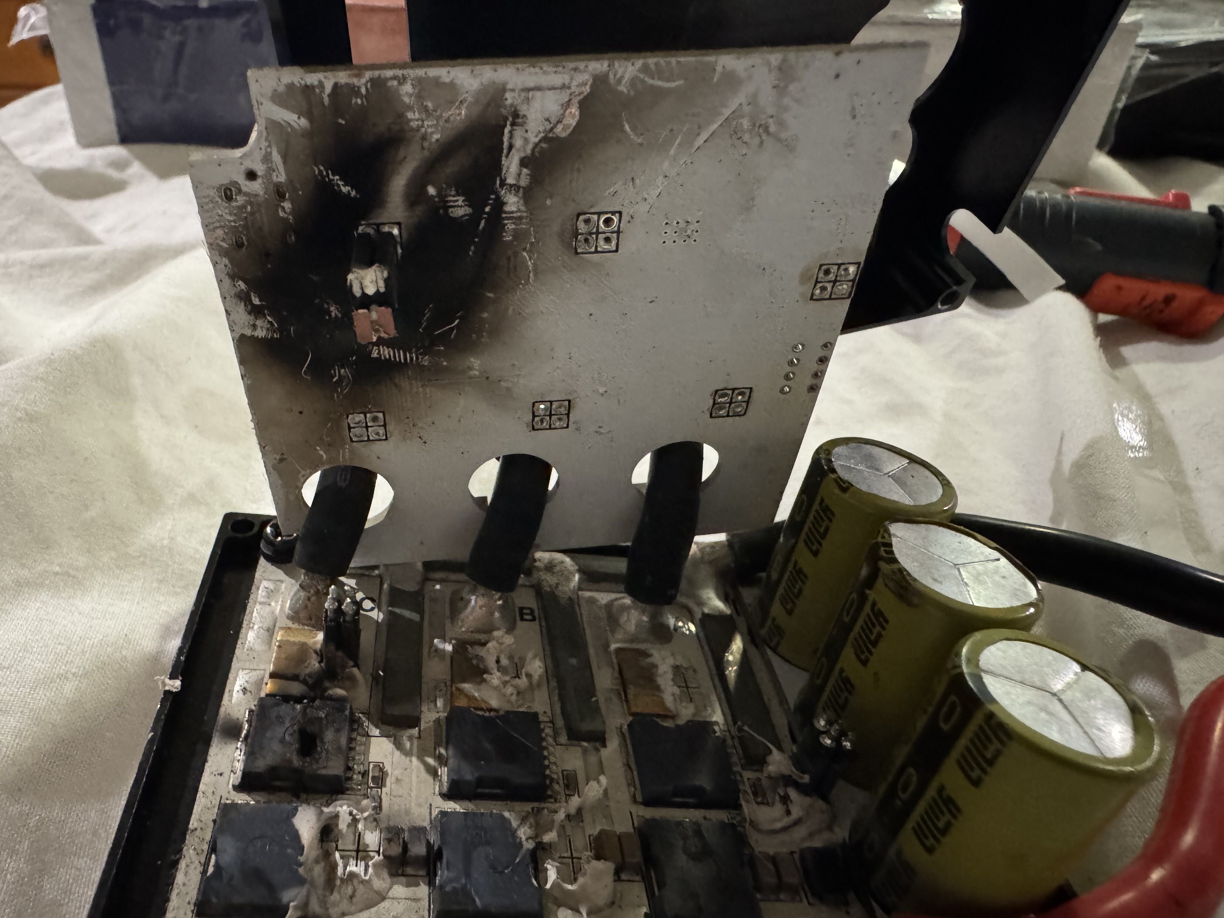

I fried mine during a motor wizard setup. Believe I forgot to turn down regen braking and the reverse current fried it. How did u remove the top circuit board?
Hi, I have the 84100hp version. I don’t think I turned down the regen during a motor wizard setup. It was doing OK and then went into reverse rotating very quickly and then shorted out. It won’t power on now and has continuity between the negative and positive leads. Could it be as simple as changing out the capacitors? I don’t see any physical issues or any black spots anywhere.

Hello, I’m sorry that it took so long to reply to you. I seldom log on to esk8 now (for work reasons). Wrong setting of regenerative braking leads to the breakdown of MOS tube, which is the most common situation I encounter. Generally speaking, it can be repaired only by replacing the burnt MOS tube.
Because time has passed too long, have you contacted the customer service of the AliExpress seller to handle the problem for you?
This seems to be because one of the half bridges of the MOS tube was broken down, which led to the shutdown of the motherboard when the control board sent a control signal to calibrate the offset.
Have you contacted the customer service of the AliExpress seller? Generally speaking, he will give you a new motherboard or get a discount. You may need to recall what you did before to avoid the same problem after replacing the motherboard.
