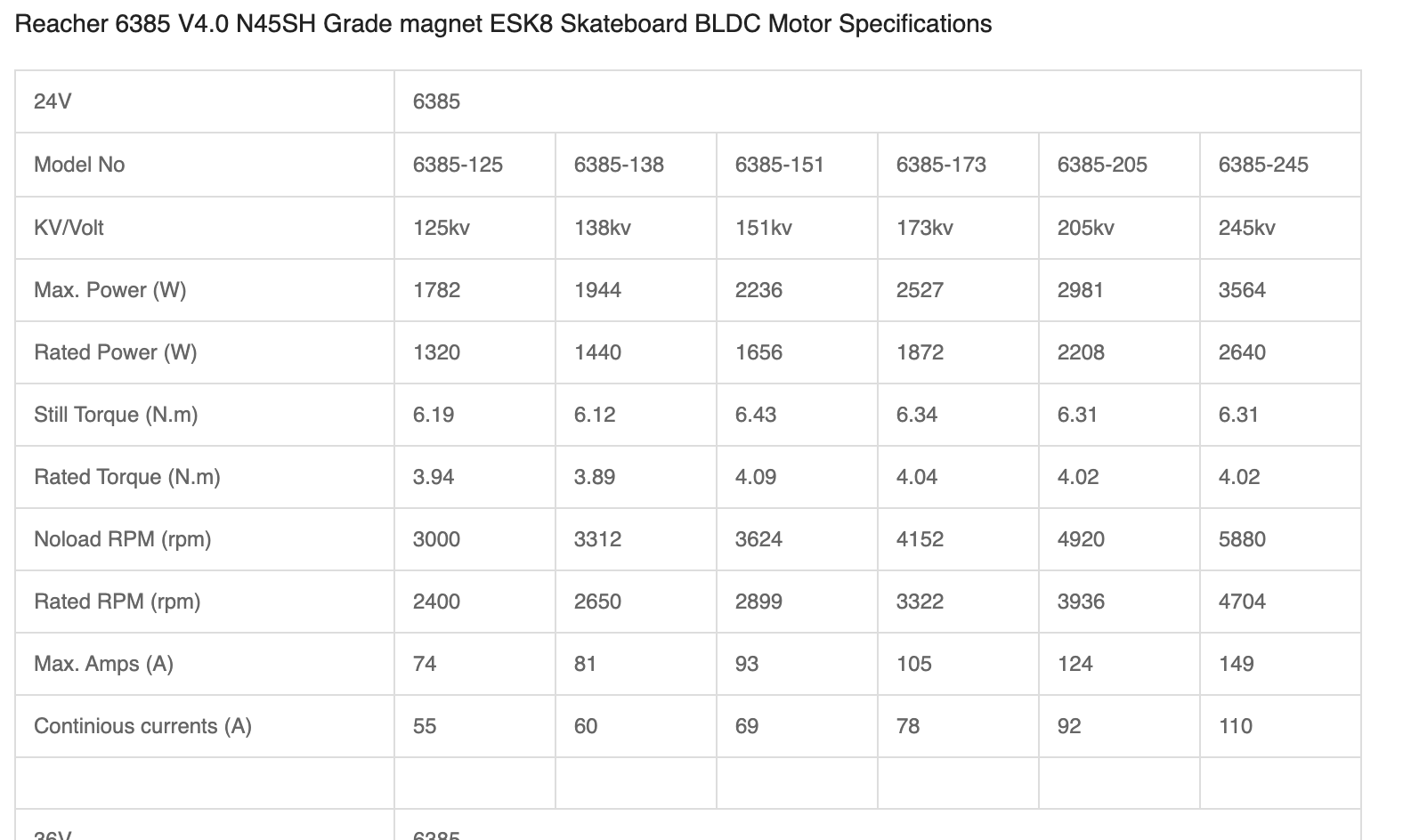

but usually something like the ESC is the limit and has a sweet spot where it can deliver the most watts. which is it’s max voltage x it’s max amps. other bottlenecks are possible such as motor max amps or voltage, wiring max amps, … etc.
usually as kv goes up amps that it can handle goes up.
so if you’re picking the same limit for two different kvs suggests your creating an artificial limitation on one.
for example. reacher specs, note how as kv goes up max amps goes up.

Esc limits. Dv100s has 60A as continuous (I normally set the continuous reccomend amps just under the max for makerx stuff).
Dv6s has 80A.
I’ll be going with 42a this time instead of 45b, so want to keep it under 30A/cell as well to reduce voltage sag.
This is also part of what’s also throwing me off. The 12s8p pack has more power, but the esc is the bottleneck (with my limitations for max set to reccomend continuous). The dv100s can fully utilize the pack, and saturates the reccomend 60A. That still just gives me 700W more.

Are you talking about the currently available D100S? I run my D100S at 90A battery 200A motor per side, so 180A battery 400A motor total at 21S. I have a log pulling 11.7kW and there was still a little bit of battery amps left that I just didn’t have the courage to pull. So it can definitely handle much more than 60A. Although if you want to go this high on motor amps you definitely need an external heatsink. With an external heatsink my temps are in control in the current weather. Fair warning though, if you run 45A per cell from P42A like I do it sags super hard. If you don’t want a lot of sag then 30A per cell is about right.
Also I am running 175KV 6395s at 21S. Although I am geared so high that I can’t come close to my top speed. I’ll make a 1:8 gear drive eventually so that I can run a reasonable top speed on the 9" tires so I can actually get closer to the iron loss territory.
@zero_ads is running 21S on 205KV motors though, and he is not having overheating issues as far as I know. So you can run reachers pretty fast.
Also regarding the KV. If you go up in KV you can run proportionally more amps. That’s why I went for the 175KV instead of the 145KV. I just upped the amps for the 175KV to the D100S’s limit, so I gained back the torque from the higher KV, and I gained top speed that I can in the future gear down for more torque. The only tradeoff was more heat in the ESC, but with an external heatsink the ESC is doing fine for now.
