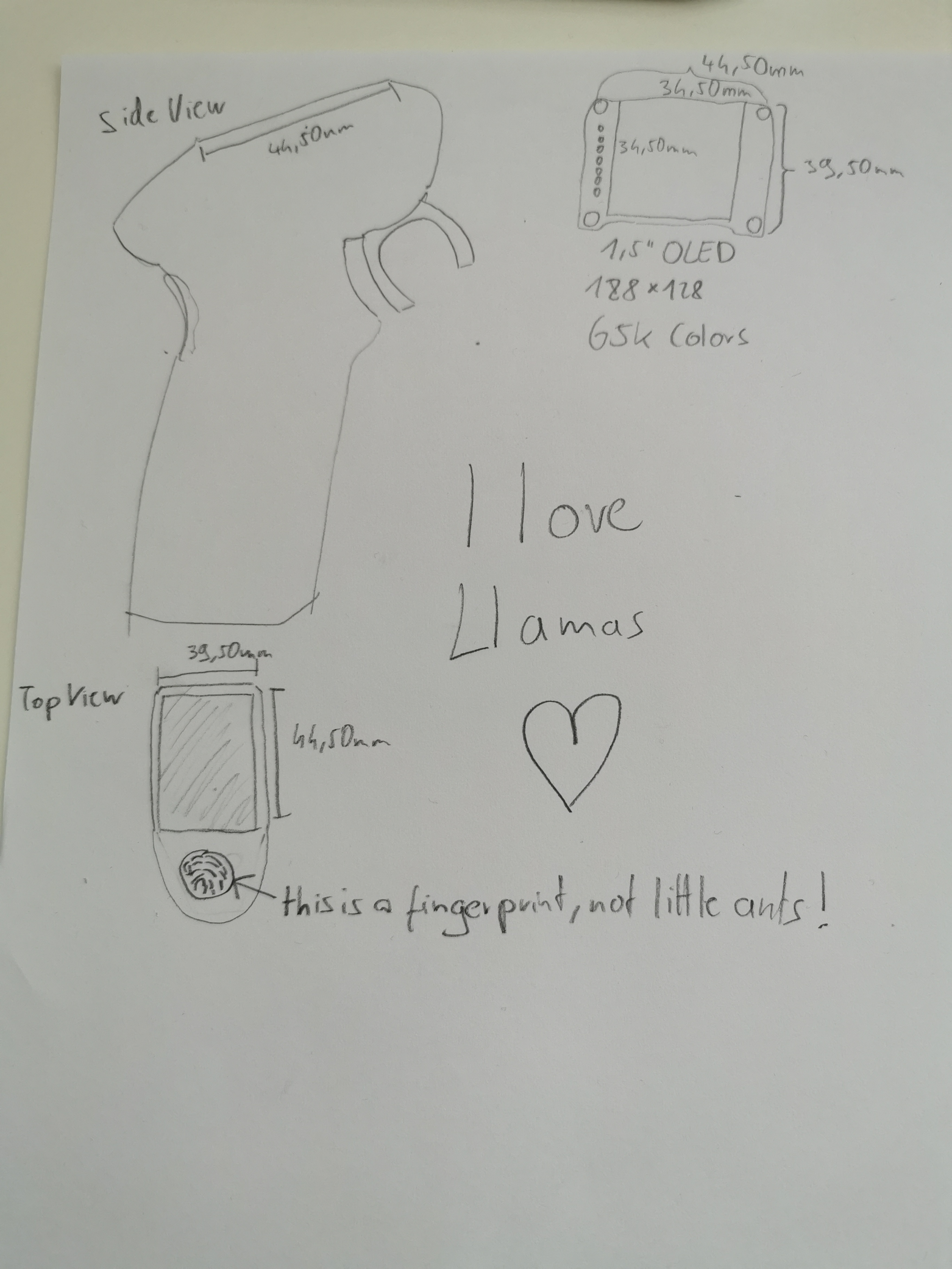

New remote with 1.5 inch RGB OLED 128 x 128
I agree that side display looks better. It really isn’t that bad to look. The Firefly nano case has enough room for wires and all atm. I would keep the usb port that way. Super useful, USB C is not so easy I think cause it needs certain voltage negotiation boards and all (or did it default to something?).

Is there an ESP 32 Lora without display or not ^^?
With the display it could be rough to fit in when we don’t use the built in display.
Well, I know one thing, you can rip the display off pretty easily if you unscrew it.

Quick update: ordered some displays to see what fits best :slight_smile:

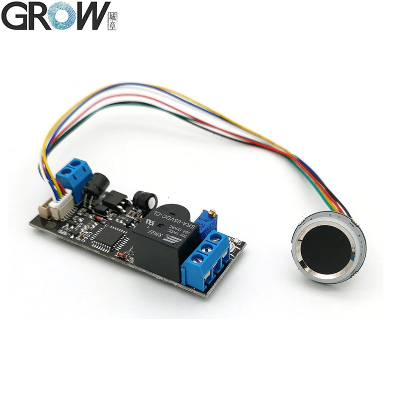

I don’t know why, but I need this:
#Aliexpress € 17,49 5%OFF | GROW K202+R502-A DC12V Low Power Consumption Fingerprint Access Control Board+R502-A Small Ring LED Fingerprint Module

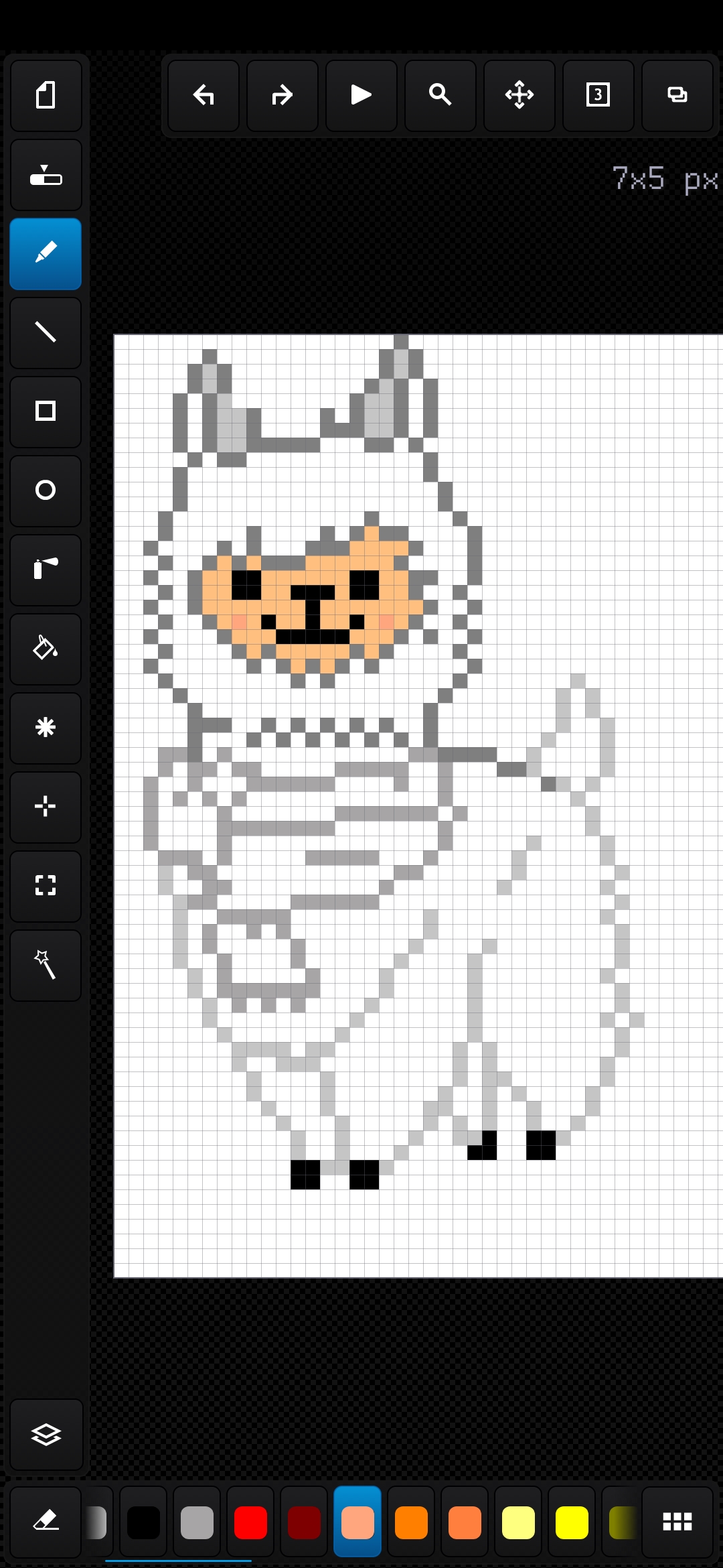

This must be the startup logo, no discussion! 33x58

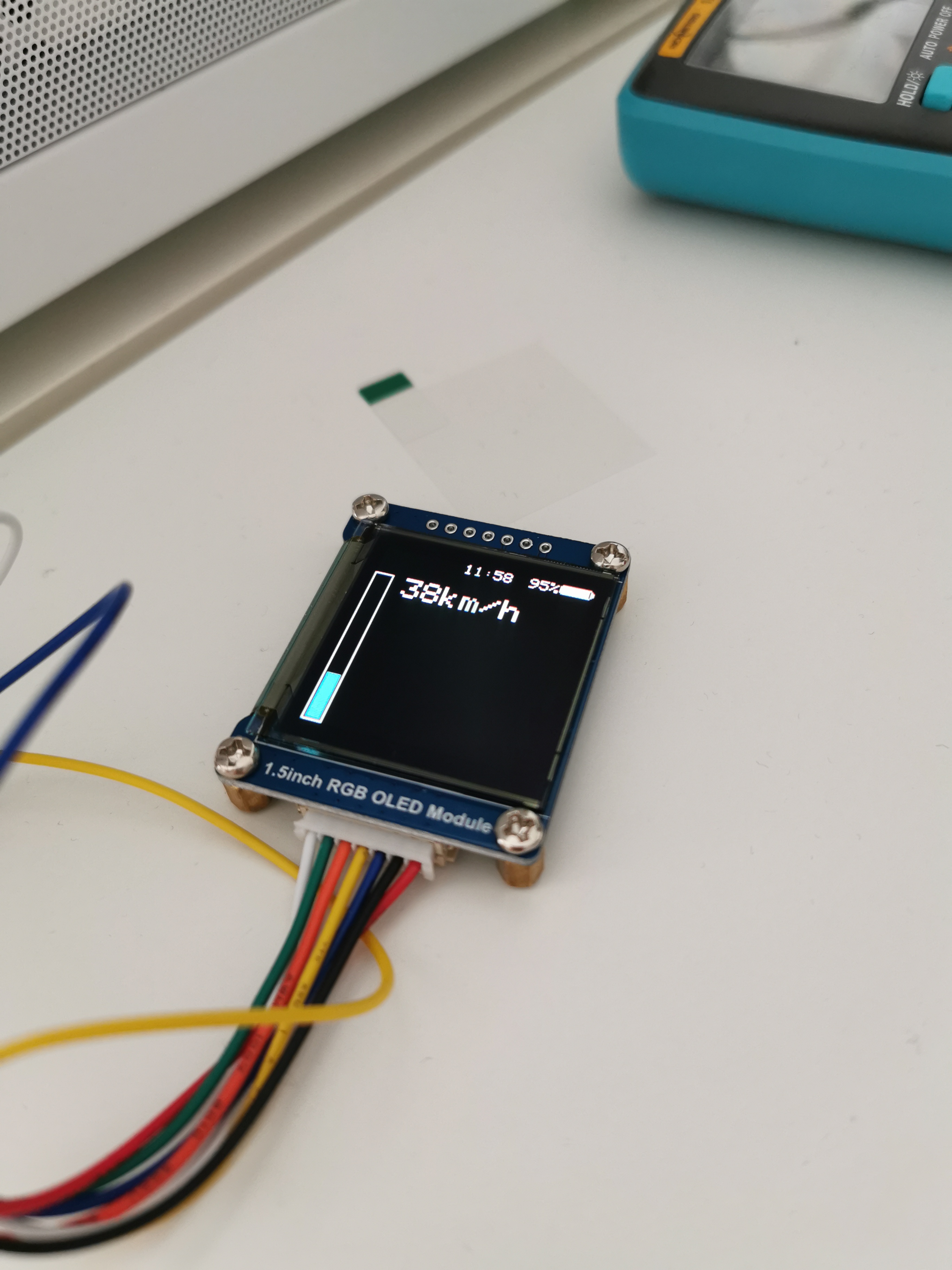

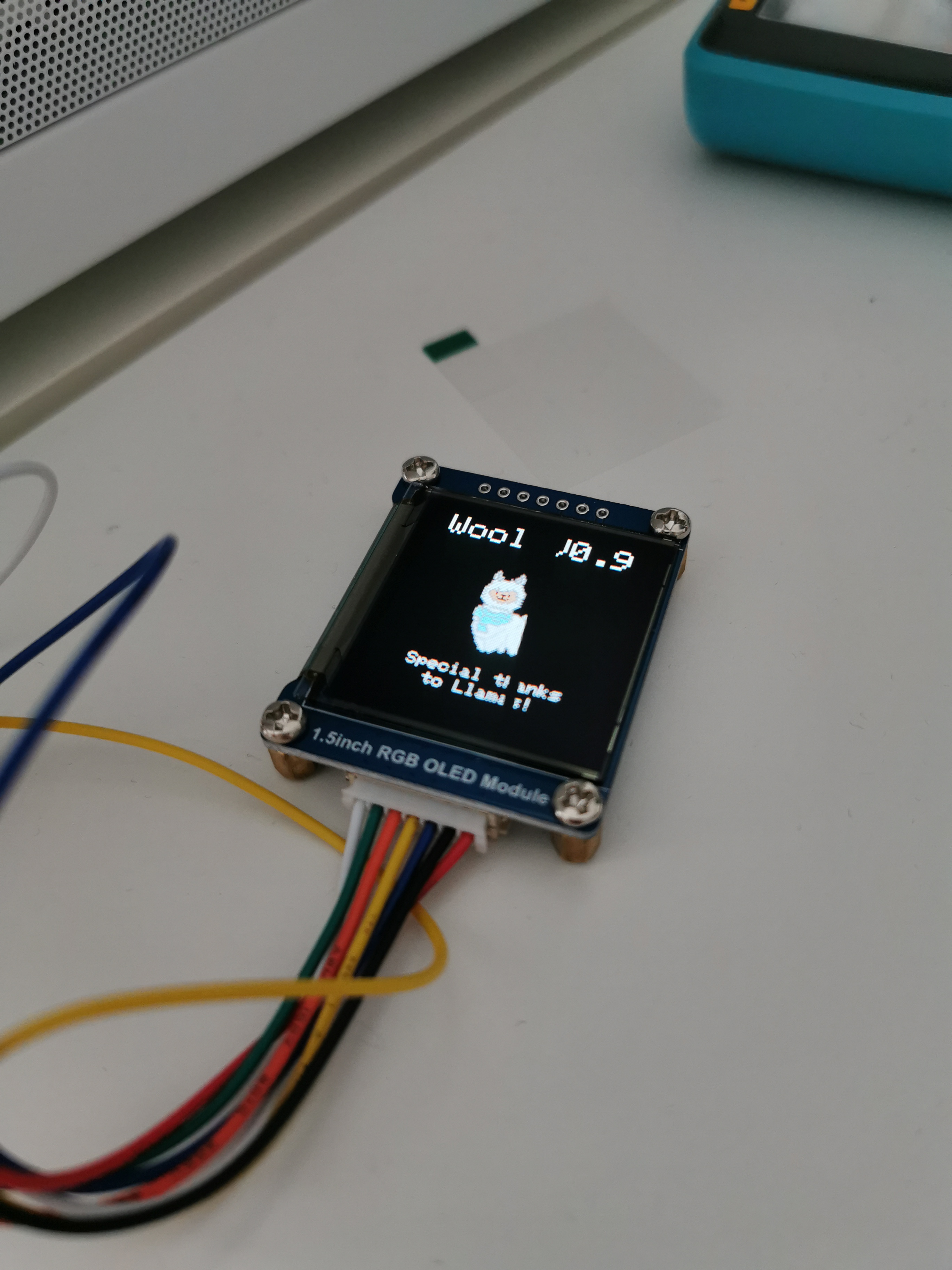

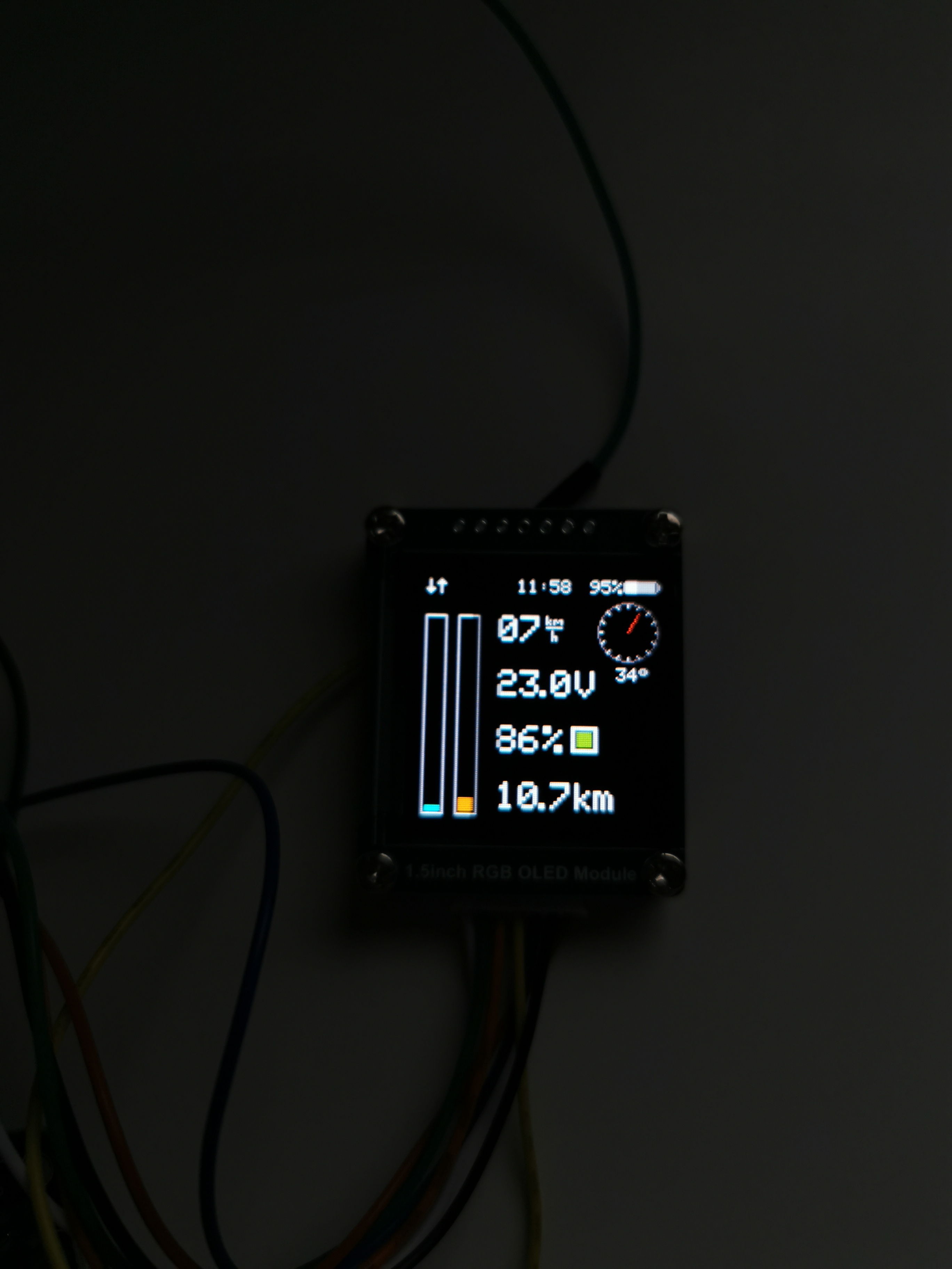

What a rough day… This display has so bad documentation… But I think i got it now :slight_smile:
Will do more tomorrow. I’m happy about the brightness and overall quality and my first trial of course
Hustling
Still needing a nicer looking font :slight_smile:
Still working hard :slight_smile:
Got a standard monitoring screen.
Now it’s time to clean my code up a little before I start adding more features.
I thought about graph modes where you can monitor your temp, power draw etc if you need it some day. A rotary encoder allows you to switch display modes by pushing it or so. It has a throttle bar, but I think I’ll add one for battery level too, maybe even velocity.
This display is so fluid, contrast rich and just perfect!

Oppinion?
Blue is throttle and orange speed. Colors will be easy to adjust if needed. Added a compass for fun :slight_smile: the small color box next to the battery level adjusts color to battery percentage :slight_smile:
From 100% to 0% it changes hue from green to red
Looks good! Wouldn’t use the hue for the color box though, you get some very ugly looking colors when you fade that from 0-100. Would just make a list of colors to go through.
@Jamie
It is non linear :slight_smile:
Goes from green to red over yellow currently.
Since color from 0-255 changes from 0-10 more than from 245-255 I have taken this into account
But I could toss it and instead use the space under the compass for a third bar like this:
