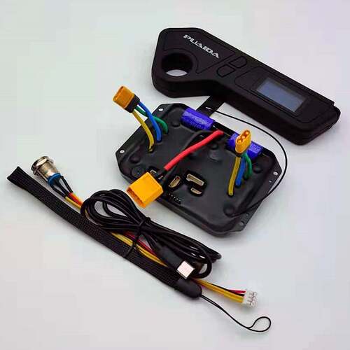

I got tired of trying to get it to work, and when it decided to recognize onlynone side, threw in a Lingyi have rolled 1500 miles, and have some telemetry.
Wanna get some OG focboxes going soon, but no confidence that I actually can.
Which lingyi version do you have? And where did you get it from?
This is made by Lingyi for Puaida.
It is just 10s, 24 battery amps. 40-45 phase amps.
Puaida has a newer version that claims to have stronger brakes, which was my biggest complaint.
I took this out of service, pre vesc attempt, as it was randomly losing connection with remote. I figure I’d cooked it as my heatsink was not exposed to externaL airflow for the first 500ish miles
I then failed to get the flipsky Vesc powering my hub motors, and tried an ebay Lingyi. It worked ok. Lost 15% of torque compared to Puaida ESC, but I was just happy to roll, and got used to it.
That ebay lingyi got submerged and i had a 3 month esk8 hiatus.
When I repopulated my enclosure, I failed again getting the FS vesc to work proper.
I busted out the Puaida esc, desperate to roll. I did not install the power button, just use roll to start, and auto off, and have a loopkey.
Not one remote disconnect in 1500 miles. I’ve used it with three different sets of hub motors since its return.
Sometimes roll to start does not work and i have to remove and return loopkey then all is well. Once every 30 to 40 starts it does this.
Happens much more often if i forget to turn off remote and auto off does its thing on both esc and remote.
