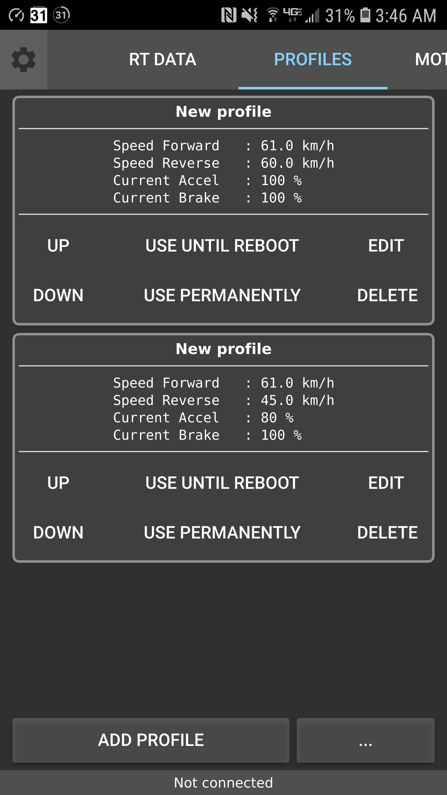

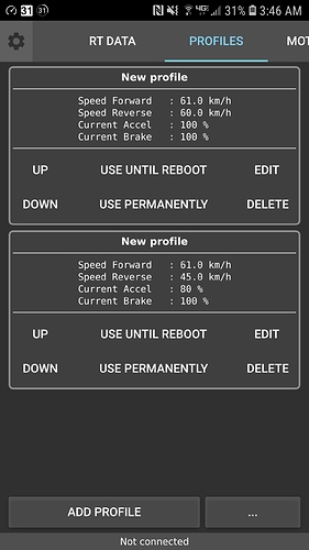

Are you running a profile to limite acceleration/speed/ect?
what do you mean exactly i jsut set up the vesc accordingly with standard parameters within the limits
Ok nevermind then. You can set up different speed profiles for your vesc. Like this from the vesc app.
