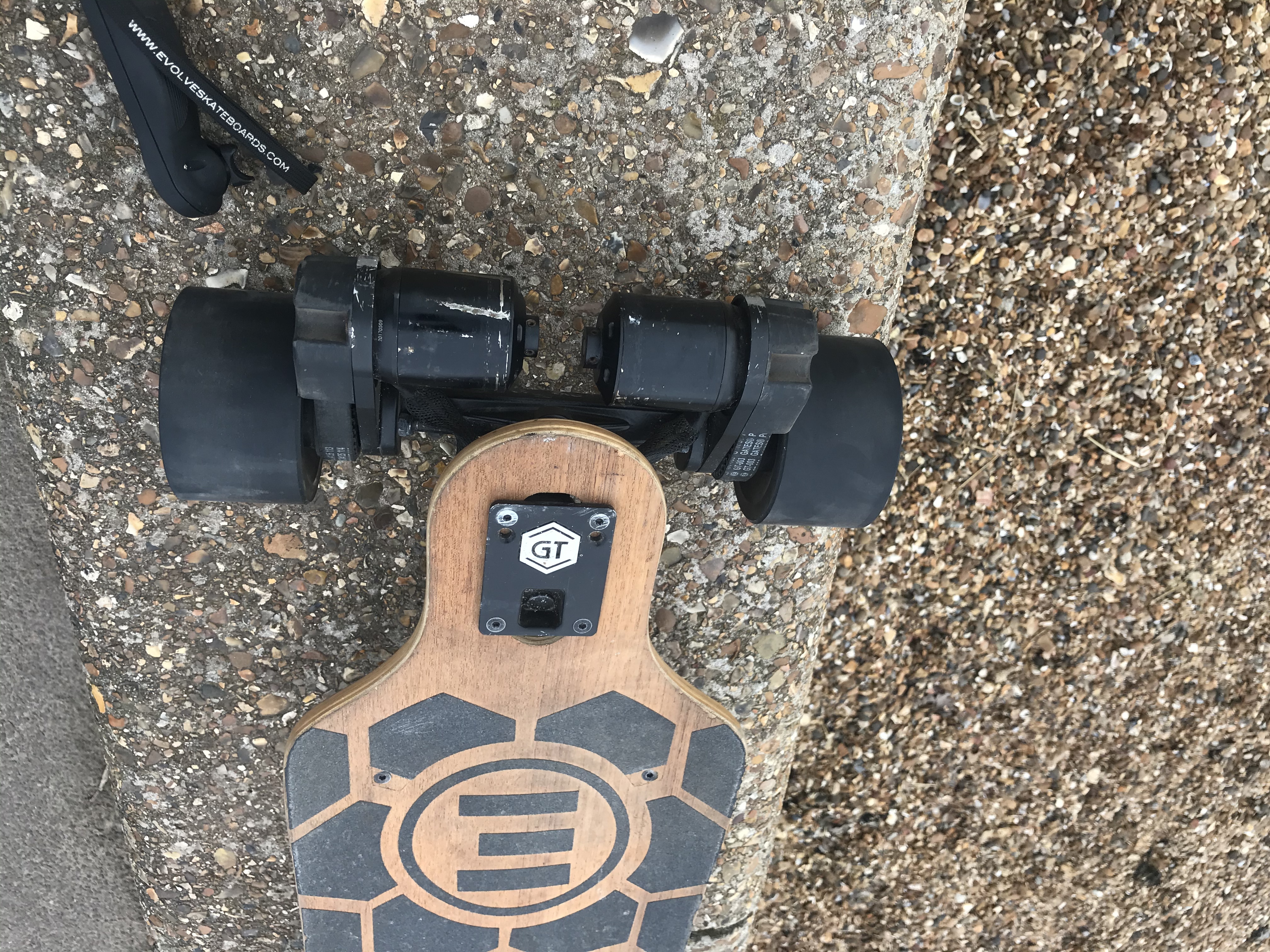

Hi Tom,
Just thought I would post some images of current board, as you can see not even close to the spec of your builds
