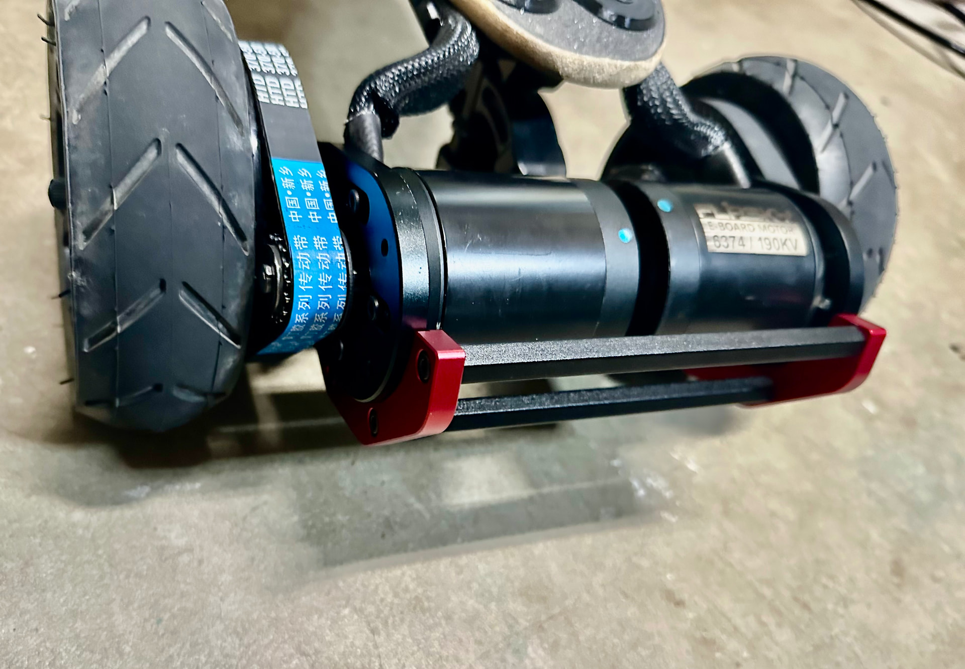

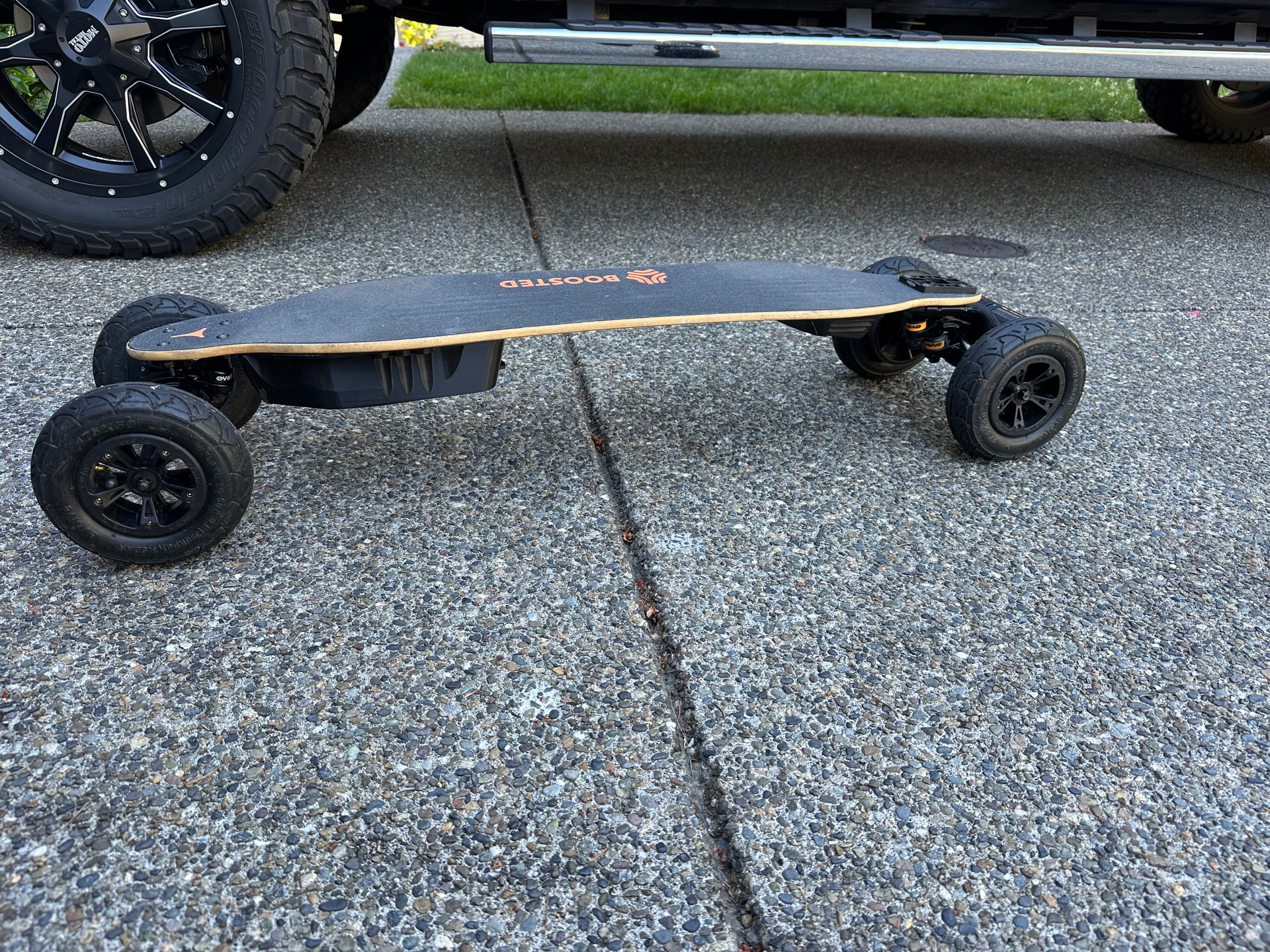

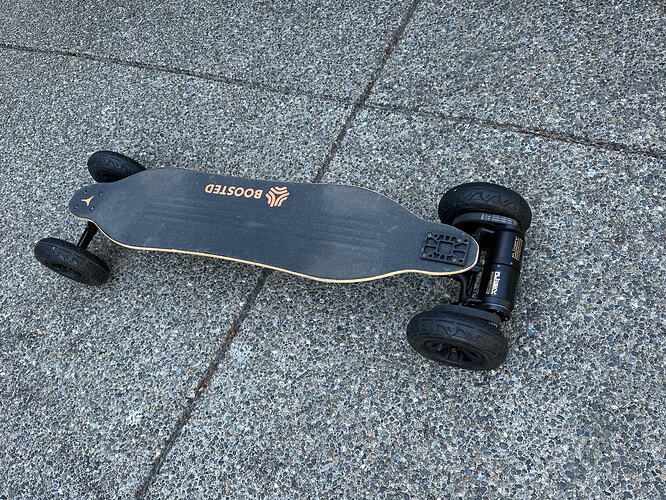

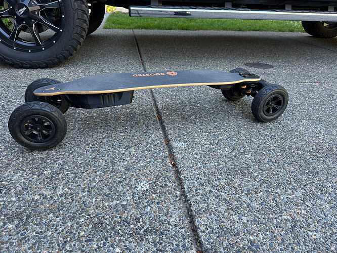

Hello, I’m looking for a prebuilt board around the $1500 range. I have been riding an old Boosted V1 I modified with Elvolve DKP, Flipsky 6374, VESC 6.0, 6” Pneumatics, 12S3P diy batt.

I will try to attach a picture of the Frankenstein Boosted I have been playing with.

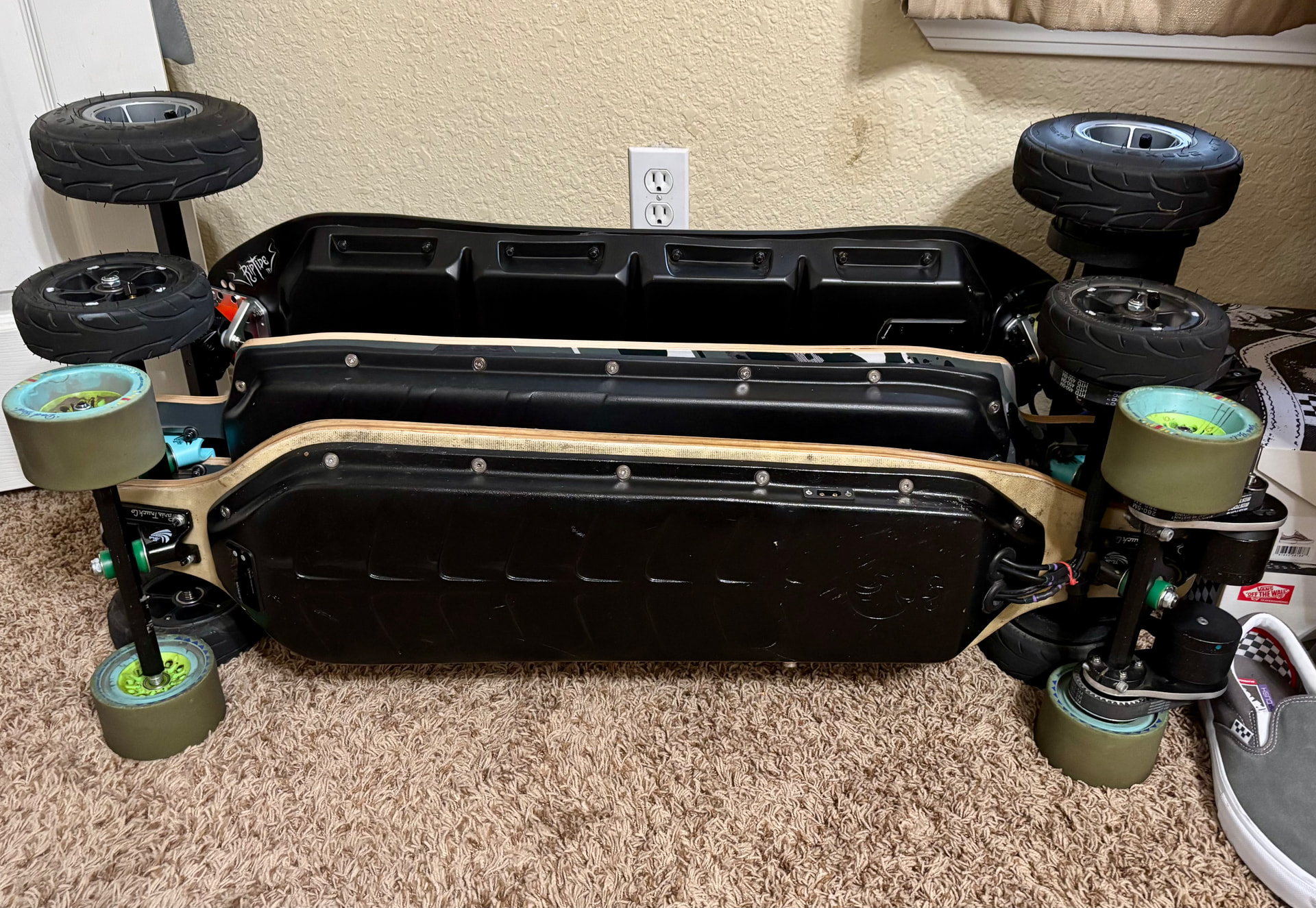

The MK1 definitely takes up a lot of room and it’s something you won’t want to lug up and down stairs. Heavy and awkward to carry.
In the pic it dwarfs the Demonseed and LY Evo sitting next to it .
As a general thing all of these bigger power and bigger battery boards will be way heavier and harder to handle.
Most of mine I am able to hold the front truck and pull around like a trolley.
Actually picking them up sucks…

Thank you both for including pictures It was good to see just how wide that Evo is. Looks like it would be a fun board if you have the space to enjoy it.
